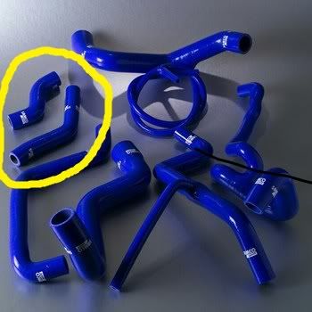

EJ Taylor 22 Posted March 2, 2012 Morning all, i recently purchased a Venair Coolant hose kit for my Rado, fitted it all, however, there are 2 small pieces i just cant figure out where they go, excuse my lack of knowledge, but i just cant figure it out! anyone had the same issue? anyone know where they go? i have highlighted the 2 pieces in the picture below. at the back of the block there does seem to be a blocking nut? was there something their originally that is now removed? therefore eliminating the need for these 2 pipes? all a tad confusing, any help would be appreciated, many thanks. Quote Share this post Link to post Share on other sites
Jim Bowen 1 Posted March 2, 2012 thats the two i mentioned in another thread, but just read they aren't for oil cooler, so i don't know Quote Share this post Link to post Share on other sites
EJ Taylor 22 Posted March 2, 2012 yer, my mate a savage mechanic, i spoke to him on the phone, (as i thought the same) he thought the might be for that, but later found out there not? other forums seem to be having the same issue! all a tad confusing? Quote Share this post Link to post Share on other sites
floppyman 0 Posted March 2, 2012 Automatic gear box?? Quote Share this post Link to post Share on other sites
EJ Taylor 22 Posted March 2, 2012 would and automatic transmission engine setup require 2 more coolant pipes than a manual? im not disagreeing, just trying to understand. Quote Share this post Link to post Share on other sites
Purplebaghera 0 Posted March 2, 2012 could they be for the crankcase breather? Quote Share this post Link to post Share on other sites
beastie4126 0 Posted March 2, 2012 If its a VR which they look like they are I suspect that they are the two breather pipes. Look the same as the samco ones I still have in the box. Quote Share this post Link to post Share on other sites
Stonejag 10 Posted March 2, 2012 would and automatic transmission engine setup require 2 more coolant pipes than a manual? im not disagreeing, just trying to understand. Automatics do have two more feeds from the coolant system (feed and return from the transmission fluid cooler). The front feed is teed off the small hose at the bottom of the thermostat housing (goes to the base of the expansion tank) and the back feed is teed off from the radiator top hose. Those pipes are definitely not for an automatic. No idea what they are for though! Stone Quote Share this post Link to post Share on other sites
winchbietch 0 Posted March 2, 2012 The two hoses are isv and pcv hoses When we did our 7 hose group buy of samco they are what we got with 5 coolant hoses... I ended up getting new factory oil cooler hoses to make up the coolant kit Quote Share this post Link to post Share on other sites
EJ Taylor 22 Posted March 3, 2012 thanks guys, really appreciate the help! spoke to couple people seem to have had the same issue, im thinking perhaps just find sunwhere else to put them, i noticed one of them is the same size as the secondary air intake, so may put it there. thanks again. charlie Quote Share this post Link to post Share on other sites
boost monkey 0 Posted March 3, 2012 didn't winchbeitch clear it up for you? they are the idle valve and crankcase ventilation hoses. Quote Share this post Link to post Share on other sites
EJ Taylor 22 Posted March 6, 2012 um, "isv and pcv" "idle valve and crankcase ventilation" maybe to you its clear, to me you may aswell be talking german, so i was just being polite. haha sorry :D :bonk: Quote Share this post Link to post Share on other sites
