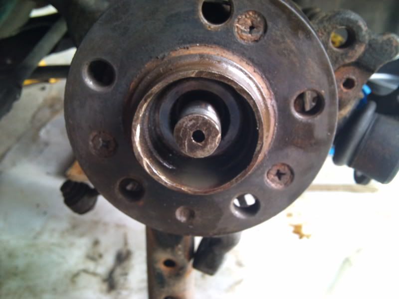

Toad 0 Posted March 26, 2012 **** me, this is painful. If you can't put it in gear, then put 2 wheel bolts in the hub and put a bar in between them to hold the driveshaft steady while you undo the 6 bolts at the other end. Can you post some pictures too? Of the bits that are damaged. I think from your description the threaded part will be the CV Joint. If it's already knackered then don't **** about, just hit it hard in the centre with a decent sized hammer. It will pop out the centre of the hub. Quote Share this post Link to post Share on other sites
Jim Bowen 1 Posted March 27, 2012 Here is the end i have been hitting Will be getting a mate round to help hold stuff this weekend, am sure it'll be off by monday. Dunno why its so stuck on, like i say the other side came off quite easily really Quote Share this post Link to post Share on other sites
Toad 0 Posted March 27, 2012 They do just get stuck tight. Try to use a brass drift, or something a little bit softer than the steel between the end of the cv joint and the hammer. And smack it hard. Don't fanny about. A good hard wack with a decent heavy hammer should surprise it a bit. Quote Share this post Link to post Share on other sites
