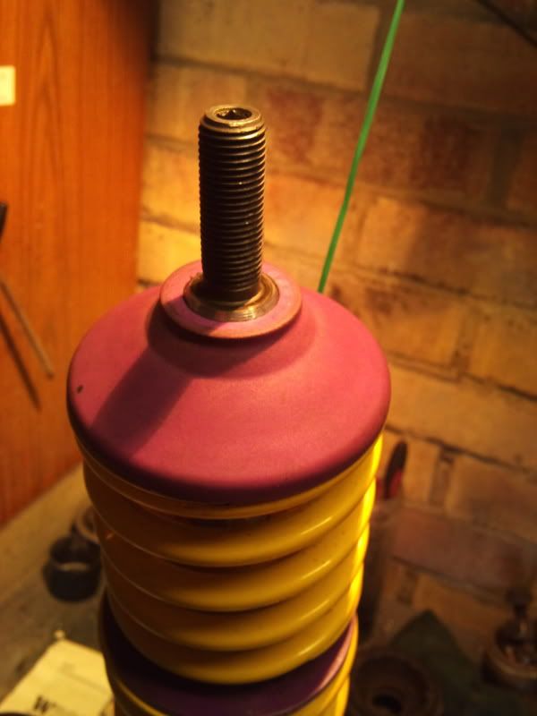

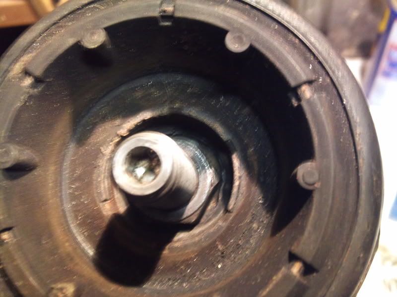

Basically i think this nut is wrong, its the flat one that sits on top of spring plate
It interferes with the rubber donut

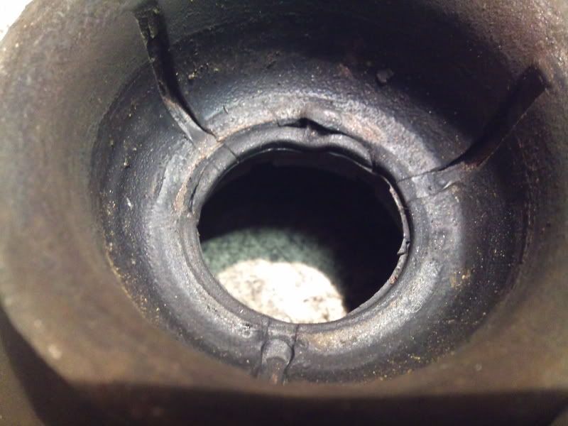

Underside of rubber, you can't see it but there is a bit of metal in there, exposed where that nut has been rubbing the top mount.
When i look closely at that nut it has marks on it, like its been catching this bit of metal in the bush.
I'm thinking of using a different nut on top there.

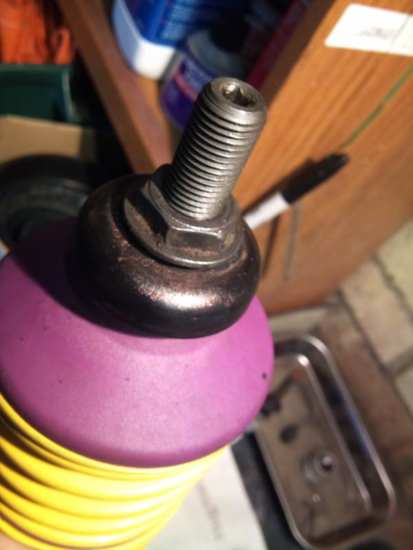

Been playing around and assembling it with the nut on top of the bush seems to fix the problem :lol: i think my issue was i used the above diagram when fitting them before.

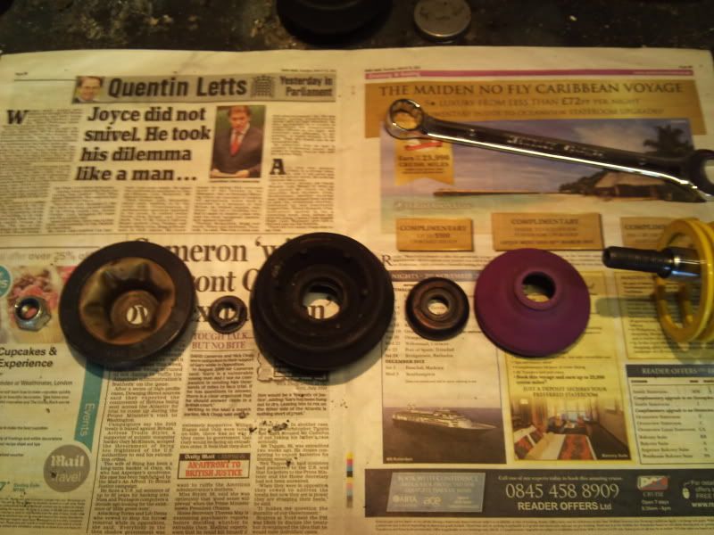

Taken pics anyway
Order of bit to go on.
i had to wind tension out of coilovers using the lower spring seat, so top spring cap is loose
Bearing on first, no nut to hold it on
Bush on top of bearing
Then the silly nut, quite awkward to tighten, i only put it on finger tight so far
Metal thing and nyloc nut on last, Once fitted to car of course
