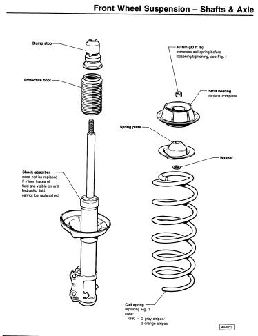

This is the vagcat diagram, and I'm sure ive not missed anything out or lost anything!
http://www.vagcat.com/p/B076/102000.png

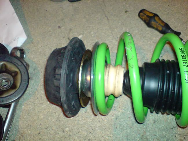

Okay got pictures now.
Clearly the two metal plates shouldnt be touching but I cant see what is meant to lift the top mount up?
[ATTACH=CONFIG]59981[/ATTACH]
Top plate:
[ATTACH=CONFIG]59977[/ATTACH]
Bottom of mount:
[ATTACH=CONFIG]59973[/ATTACH]
I think that plate is upside down but there is no spring stop... it's been a while since i've seen the old style top mounts but they shouldn't be rubbing like that!

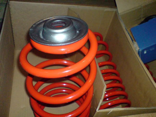

I wondered that but it would still tough the top mount plate. Spring stop?
Just managed to read part number of the spring plate 357412341A.... VAGCAT says G60 shouldnt have the A after. Thinking these ones are for VR6.
EDIT: [ATTACH=CONFIG]59989[/ATTACH]
This is part number 357412341. It's more coned and taller. Is the top of the cone meant to touch the bearing in the middle of top mount and then its all good?

Looks like you have a late spring plate and early top mount.
---------- Post added at 3:12 PM ---------- Previous post was at 3:04 PM ----------
Can just about see them here
This pic is early plates and mounts, and late plates and mounts (separate Bearing)
Although i remember the early ones being a large diameter than the lates, you may be better off getting late top mounts
Late plate on a spring with small diameter top coil
Early
Late
