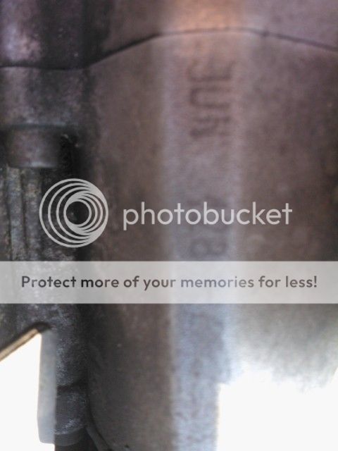

Hi a was woundering if any one could tell me if this means anythin like if my charger has had a rebuild at sum point? Its etched on top of the intake, cheers nye

from what ive seem most places that rebuild chargers(jabbsport, JMR, G-werks) will stratch a refference number into the charger not like your branded numbers .....so i would assume like the other guys have said that it has not been rebuilt.......
