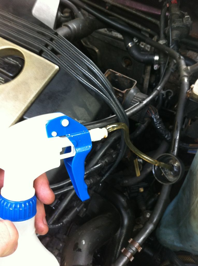

Well, Supercharged you came up trumps because a pressure bleed did the trick brilliantly. I made a DIY kit using a normal spray bottle and some tubing off an old screen wash pump. Pumped the fluid through the cylinder and it's been right as rain. I love my Corrado again
