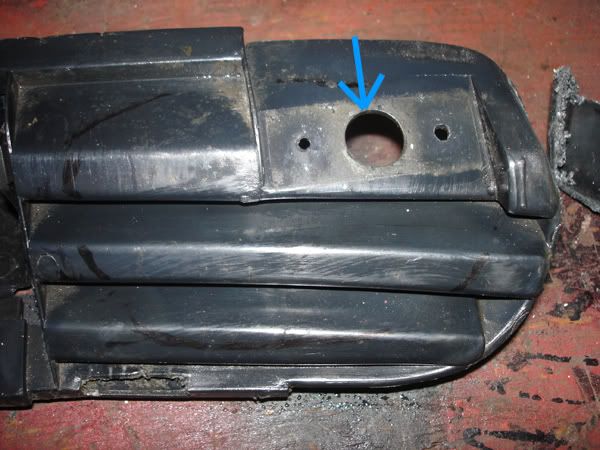

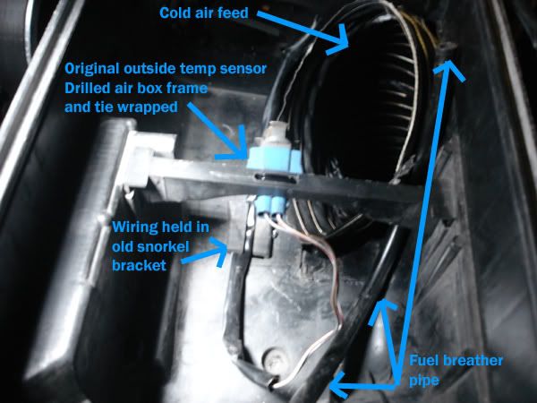

If the outside temp isn't showing it means the sensor is broke/missing. The sensor is located in the front bumper/drivers side if I remember rightly (I moved mine into my air box lol) It's like a plastic lump sat in a plug.
Edit: Ah, found pics in my members motors thread...
Where it sits in the lower front bumper (drivers side)
Pic of the plug/sensor
And the sensor.

OK, thanks for that. Do you access it from the engine bay side of the bumper or externally e.g under the fog lights on front bumper?
I think, and don't quote me on this as it's a long while since I messed with mine...But I think you access it from engine bay, sticking your arm down towards the bumper grill.

Mine's been hanging about loose next to the carbon canister ever since I bought it. The cable for mine isn't even close to long enough to reach the bumper (it barely stretches to the slam panel!) - was there anywhere else they were ever fitted?
Yeo,in the brake cooling duct
Sounds like yours has been re routed to me
