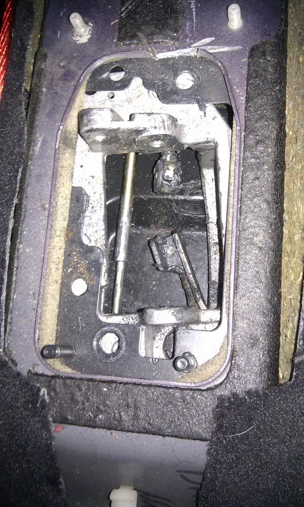

Aaargh - I was having some gear selector probs recently (here) and I thought I'd sorted it, but I started to get more and more problems. Today, the cable itself has snapped, right near the gearbox. It's the cable that goes back and forth (shift cable?) not the one that makes it go up and down (tower/selector cable?).
I'm not sure how it all comes apart or how it's replaced. I have got the metal plate out that is close to the gearbox, so the cable is loose. The cable then disappears into some heat shielding. I've also taken the gear selector apart/out from the cabin, but the cable remains in place. I haven't a clue what to do next.

Edit - picture added
[ATTACH=CONFIG]72139[/ATTACH]

Cheers for the reply - I'm at this stage in the cabin - what next? Sorry to sound silly, but the cable seems to still be held firmly in place!
Sorry for the big pic - forum wouldn't let me thumbnail :/
I'm pretty sure you can't get the shifter box out from inside, happy to be corrected. The cables are bolted through the front of the box and unless you can get to them then you will need to drop the box out.

Just thinking about it, you may be able to get the cable out from underneath but leaving the box in place.

Oh cat bottoms. Does that mean I have to squirm around under the car once it's up on ramps? Is it quite straightforward once the exhaust is out of the way?

Ok - quick update - the ONLY way to replace these cables is to remove the shift mech box from underneath the car. I took the cat out and dropped the front heat shield. I also undid the two fastenings on the rear heatshield which gave me enough space to drop the shift box out. The shift box in held in place with four bolts that are accessed by removing the exhaust/cat.
If you have a pit or a lift then this job is easy - if, like me, you only have ramps, prepare for cursing, pain and loads of crap going in your eyes.
