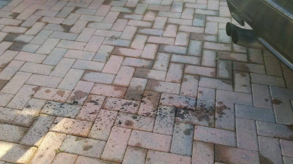

Thanks for your detailed reply vw rule. Im actually colour blind so it can be hard to tell sometimes what colour the smoke is, haha.
I don't know whether this makes a difference or not but I've also been getting a load of soot type stuff left on my driveway if I let the car idle and then accelerate hard:
Does this indicate over fuelling?
I have changed the oxygen sensor and the maf for known working ones recently as I was getting a strong smell of fuel, and do still occasionally smell fuel but nowhere near as bad as before. I also tightened the fuel lines ontop of the fuel tank and below the fuel filter as these joints were leaking slightly.
The car drives really well, idle is perfect and it usually returns good mpg. But I'm still wondering if it is over fuelling slightly now.
Would over fuelling cause the smoke on overrun?
I does smoke slightly on cold start up, usually just white smoke that I assumed was just condensation.
I appreciate all of your help, I'm just secretly hoping its going to be something simple and I'm not going to have to pull the engine apart again.
Also I have a vagcom cable and ran a scan but it showed up no faults apart from the cam position sensor but I believe this would usually show if the engine is not running during the scan.
Hello Rob,
on the attached photo you've put up I'd say it looks like fuel soot,
the block spots on your drive look like the engine may well be over fuelling slightly.
Because to have engine oil spitting out of the exhaust that would mean you have a internal engine problem,
which would normally kick out blue / grey smoke from the exhaust.
To have oil coming out of the exhaust, it would be head gasket gone badly, or a cracked cylinder head, or a cracked damaged piston or rings.
Your exhaust Rob is it a DTM Stainless Steel box and system ?
It's just that with some of the stainless exhaust systems they do tend to get coated with thick soot in side,
mainly in the rear box as it's the coldest part of the exhaust.
I used to get this on my old MK2 VW Scirocco, I had a Janspeed stainless system on it.
It is normal Rob to have some moisture from the exhaust tail pipe,
as this moisture is mainly from the cat where the gases pass through the honey cone inside it,
so you will see a little white / grey smoke coming out,
the white smoke is the moisture and the grey smoke is where it has mixed with the soot and small traces of oil in the exhaust.
Your very short journeys Rob will mean your Corrado won't be getting right up to running temp for long enough,
so you will see moisture more often coming out of your exhaust.

I think Rob your main problem is a lot of soot build up in your exhaust system,
this is due to oil or over fuelling.
oil being used / burnt in the engine will show it's self normally as blue / grey smoke from the exhaust.
Black smoke is normally related to too much fuel delivery in the engine.
Rob if you are just doing 3 miles a week in your Corrado then yeah I would say it is related to your smoking issue.
A car engine doesn't really get up to normal working temp until you've done about 5 to 6 miles,
say about 10 to 15 mins in time.
So your exhaust may not be getting a long enough time to stay hot and the same for the engine,
your engine by the sounds of it will only just be coming of it's cold start programme,
if you're just doing 3 to 5 miles.
I would give it a decent run say 20 miles or above, and drive it up to 70 MPH,
for most of the 20 miles to see if it clears up,
if it’s still the same or hasn't got any better (if the smoke hasn't reduced or cleared a little)
Then yes I would say you've got an internal engine fault (oil or fuel related)
Hope this helps Rob
Si :salute:
