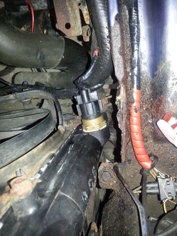

Hi all, I'm finally getting round to sorting my water pump issue. When the fan starts the water pumps stops working, pressure builds up and coolant is expelled under the pressure. The head gasket is fine, that has been tested.
Does the round black plug in the picture have an electrical link between the fan and pump? I ask as it appears at some point the wiring has been played with and the plug is not connected properly.
Unless anyone has any other ideas?
Thanks
http://i32.photobucket.com/albums/d14/voo51/Ice%20violet%20vr6%20Corrado/Engine%20pics%20during%20detailing/20130525_122047_zpsf62832dc.jpg
That plug is on the stage 1 + 2 fan switch and is used when the ignition is on, via the fan controller/relay box.
Do you mean the auxiliary water pump stops when the fans come on? That's not so much of an issue as you should still have the main water pump driven by the serpentine belt. Nothing electrical is going to stop that!
Make sure the earth to the fan control relay is connected and clean. Check all other earths for the coolant system too.
When the fans come on check to see which side of the aux pump power is being switched off, the pos side or the neg

Dox - thankyou I will check those.
NRC - I didn't think it would be such an issue either as people remove them and run fine but apparently that is what the overheating is down to. The radiator and various other sensors and coolant tank have already been replaced but I'm debating buying another expansion cap to see if the new one was a dud.

The plug shown is for the fan switch, however turning the fans on obviously won't help if no coolant's circulating through the radiator. Are both top and bottom radiator hoses getting hot? (if not: thermostat). When running there should be a steady trickle of coolant being pumped through the small-bore return hose into the expansion tank - you can run it with the cap off to see. If not, you might have some vanes broken off your main water pump - this is supposedly quite common with the plastic-impeller ones they got from the factory.
