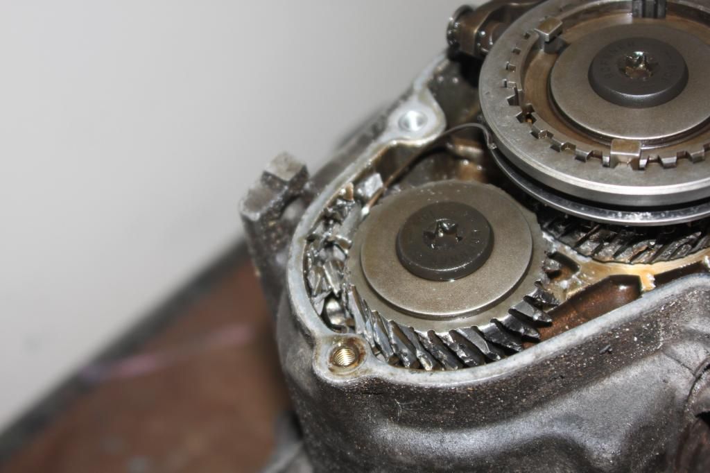

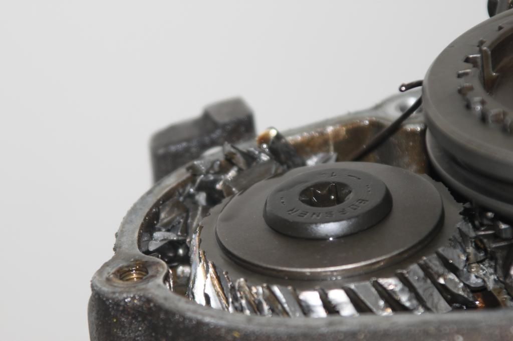

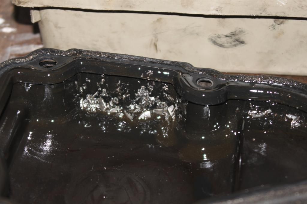

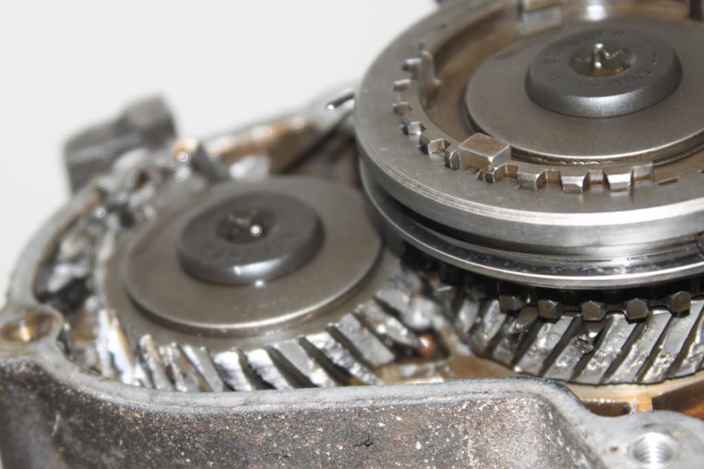

Well here is the damage, finally got round to starting the strip down.
Annoyingly that is as far as I have got. The Torx bolts in this box are T55, unlike the spare one I have sat out the back which is T60, so I don't have the correct 'bit' to carry on today.

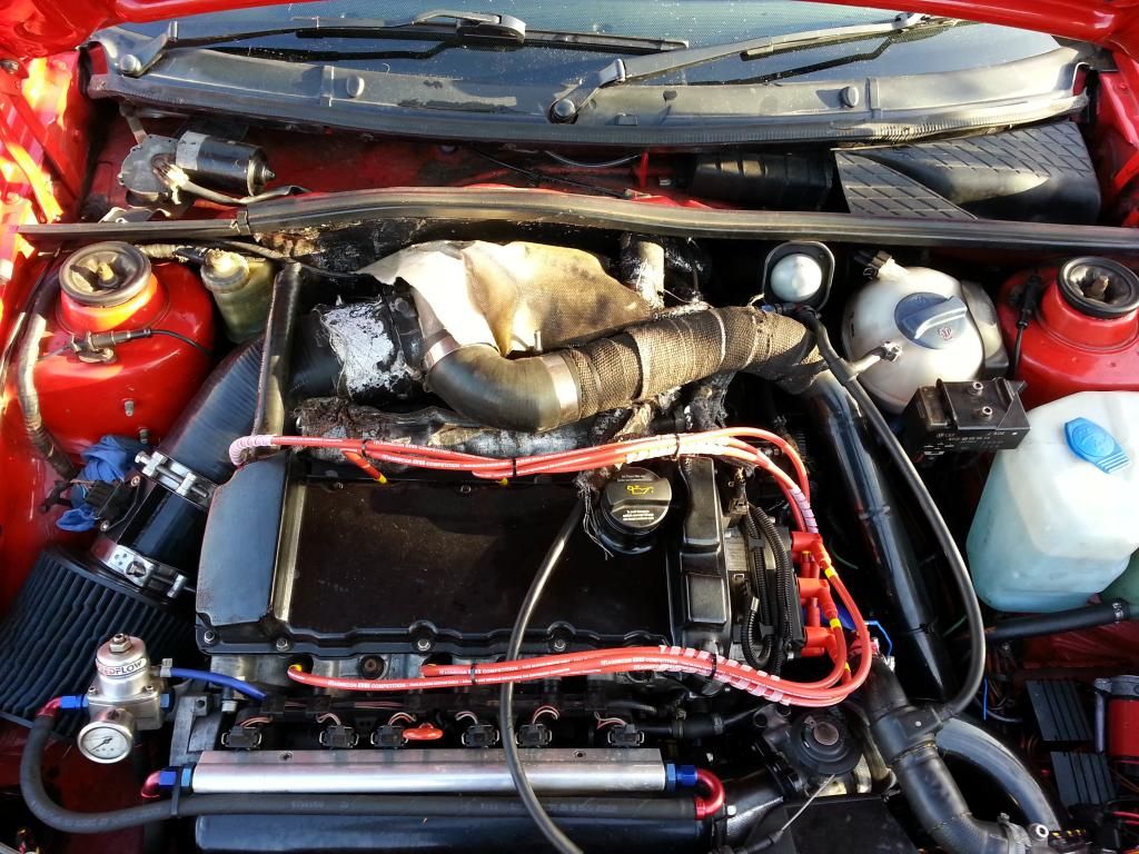

Turns out the poor idle was the MAF, but changed the leads anyway as they were obviously on their way out.
Got the gearbox stripped down. One of the big T55 bolts just decided to start rounding instead of undoing, so out came the angle grinder. Diff is now sat on the work bench waiting to be sent back to the states at some point.
I still miss lifting the bonnet and not seeing that. Its all the wee things that always show up when there not running right. I always used to automatically think the worst then find its something simple.

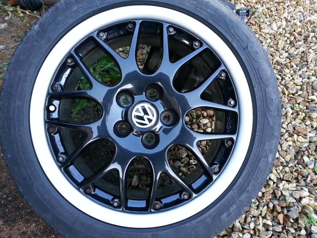

Picked up some 16" BBS RX2 for winter use. Other than rusts bolts they are pretty much like new, no kerbing what so ever and also came with 4 good tyres, all for £100 :smug:. Just need some 13mm spacers to clear the front calipers and some winter tyres.
Surprised at how light they are compared to the Compo's.

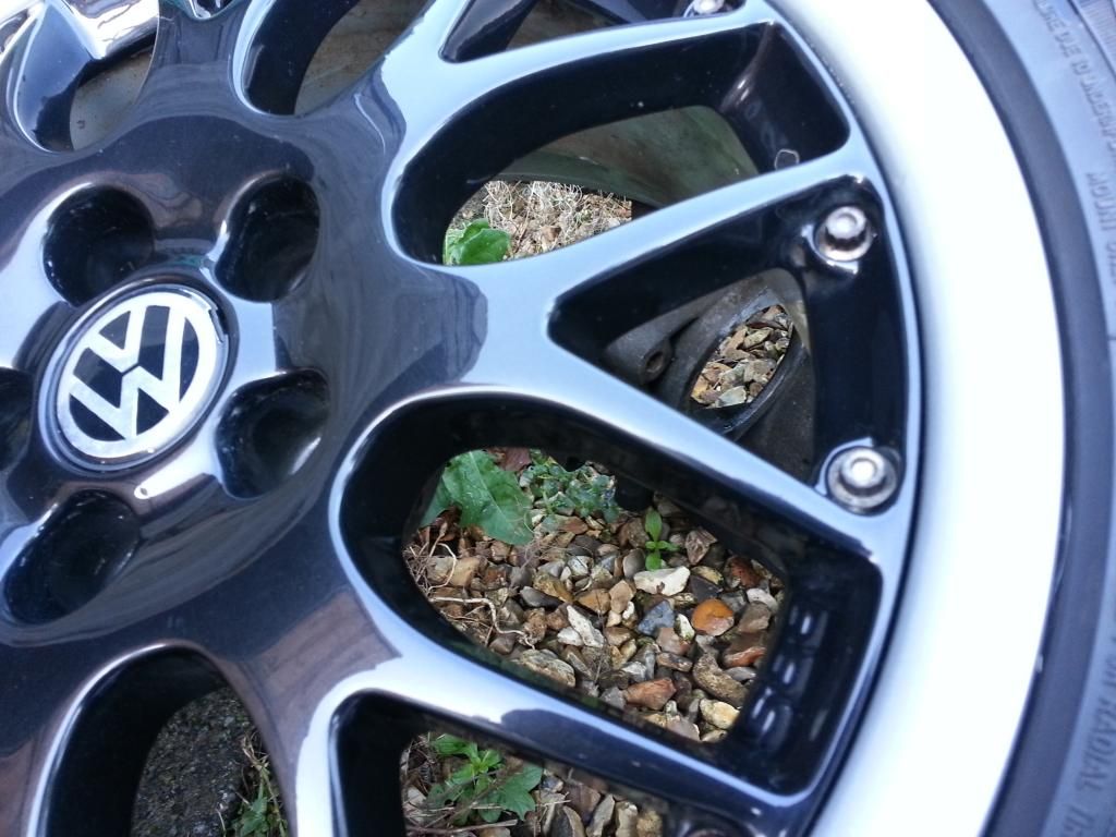

Some better pics, all wheels in the same condition.
Would be nice to replace all the bolts but it seems pointless being they are winters and will almost double what they cost me.

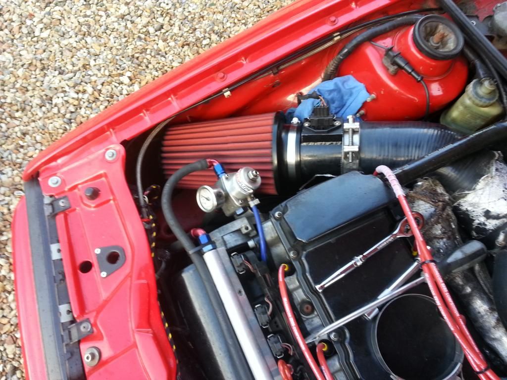

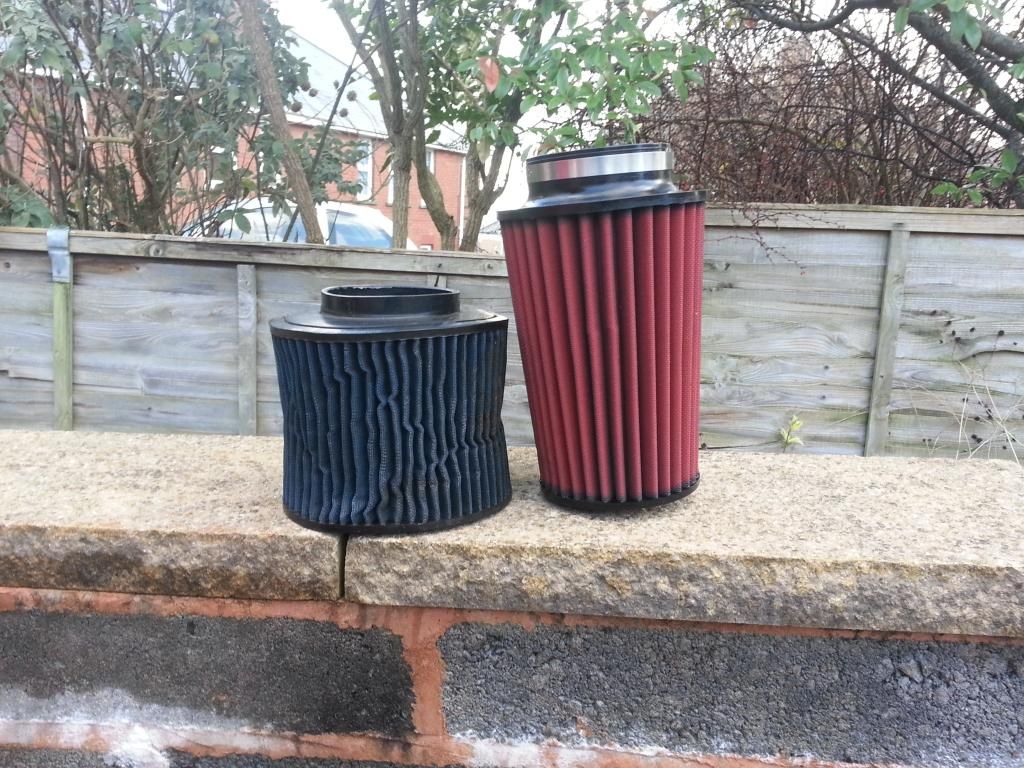

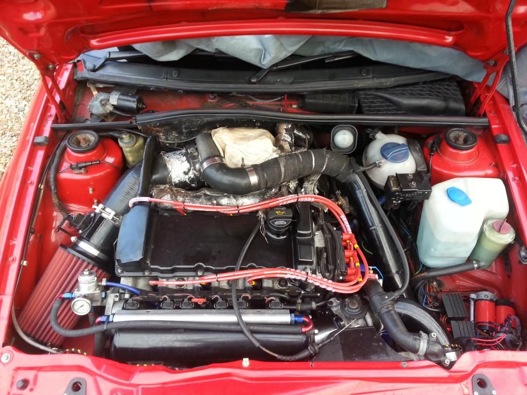

Having replaced the MAF a few weeks ago I decided it was also time to do the air filter.
Got no idea what make it is, how old or even if it is dry or oiled so ordered up a new AEM Dryflow from the states. A few weeks passed and then it arrived yesterday and I have just fitted it now in between the downpours.
These filters seem to get nothing but praise on the forums and wasn't even that expensive once all import costs were added on. It has a larger surface area than the old one, plus the colour matches better.:camp:
