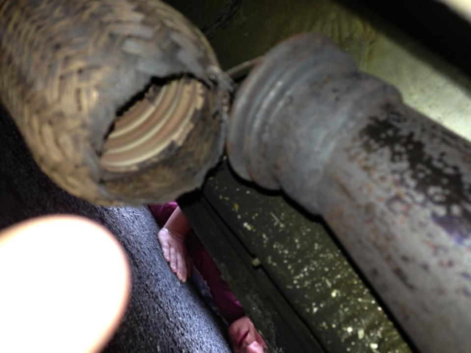

So my raddo sounded alot louder 2day and i mean ALOT found this:
should i just push this back over and jubilee clip it ??
You could try that but I don't think it will stay on for long, as you'll only be attaching the flexi braded skin,
because it's the flexi joint in side the flexi braded skin that has snapped off,
so the exhaust will still be blowing.
I think once they've rusted and broken off you really nead to replace it with a new flexi section.
Or you could have it welded back on short term ?

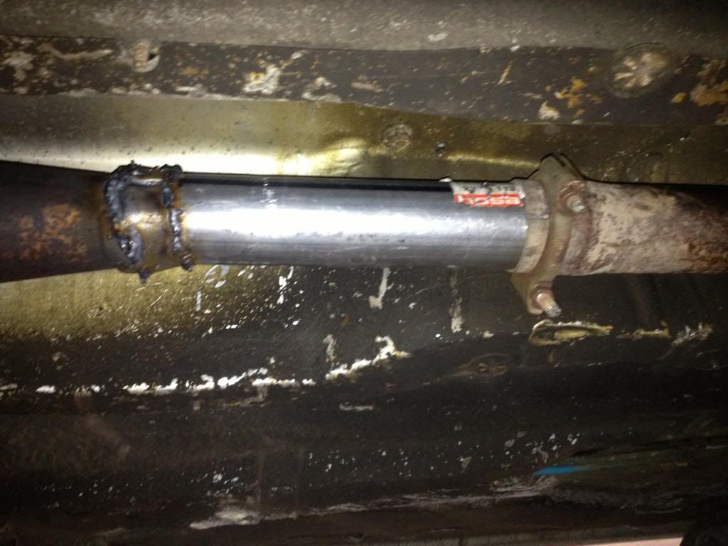

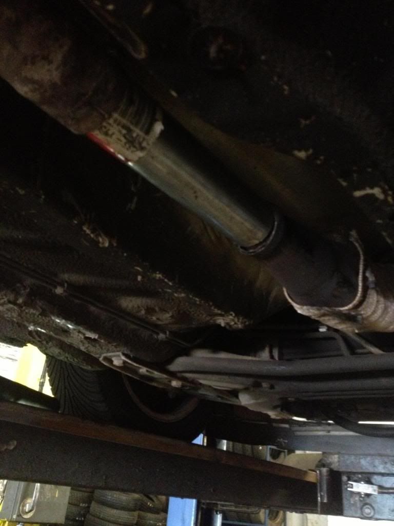

Thanks for all your help guys a mate of mine manged to weld a pipe in, problem fixed:
