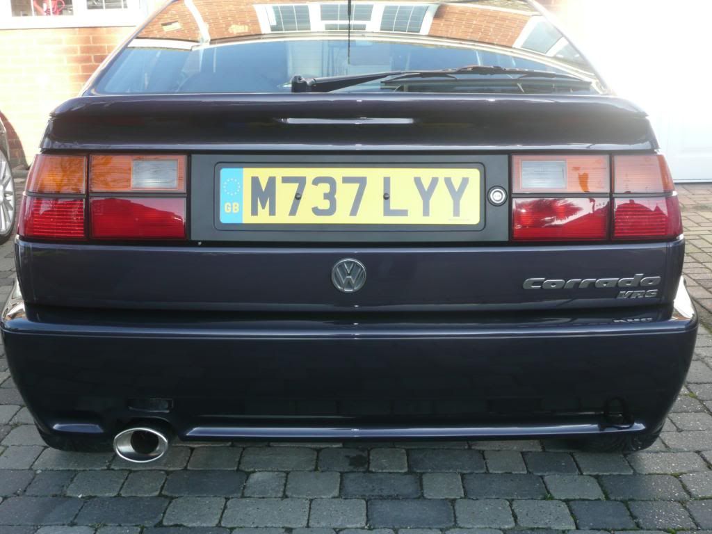

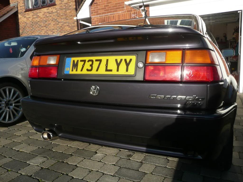

I have a milltek on mine mate that was fitted by AMD, there is no bend in my tailpipe, the fit is great with absolutely no banging. I have attached a couple of pics so you can see how mine looks etc.

Hope your getting your exhaust sorted O/K, you will see from my pic attached that we fitted an off set bracket, the exhaust is lined up perfectly.
The only place to bend or set a piece into the exhaust would have bern between the mounting and the tail pipe end fitting, a very short section to adjust
Hopefully my picture attached O/K
