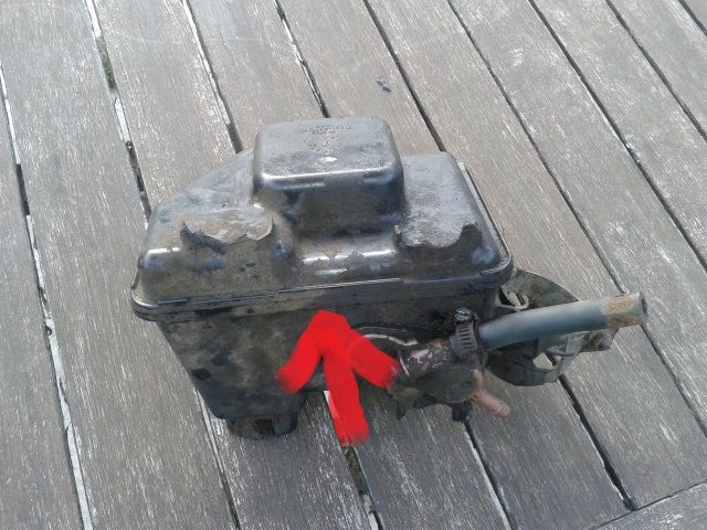

vw bobby 10 Posted August 29, 2013 Hi all, I just want to find out is there a sealant I can use to glue my plastic box that holds my fuel pump in on my 1991 corrado 1.8 16v, as there is a slight leak from the join? Here is a few pics of the fuel pump and box: It is leaking from one of the joins in the plastic box, its not broken or anything either? The 2nd pic is where I think its leaking from? Cheers Bobby Quote Share this post Link to post Share on other sites

Overmind 10 Posted September 1, 2013 It's getting more and more common to see these failing these days. I wonder if its down to increased ethanol content in fuels dissolving the plastic/bonding agent. I've heard loctite 9394 can be used, but I've never tried it myself. Quote Share this post Link to post Share on other sites
vw bobby 10 Posted September 1, 2013 Cheers for the advise mate, but when I took off the unit, I have noticed one of the plastic pipes on the unit and bent and that is what is causing the leak not the seal on the actual unit? Thanks for the advise though and I agree with your comment, I also feel its the ethanol content in fuels, which is causing this problem. You would not have a spare one for sale by any chance, would you? Cheers Bobby Quote Share this post Link to post Share on other sites
vw rule 19 Posted September 1, 2013 Take a look at this but for short term fix only ? The guy in the video says it's a long term fix. Si Quote Share this post Link to post Share on other sites
vw bobby 10 Posted September 2, 2013 Thanks alot mate, that is a big help. Worst case scenario, can I use one of these off a mk2 golf gti 16v or 8v? or can I use one off a corrado g60 or VR6 or 2.0 16v? Quote Share this post Link to post Share on other sites
