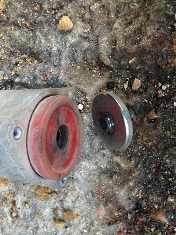

Just been under the car - both front and rear mounts seem ok. Rear mount is stock but looks almost new and front is an aftermarket poly but looks newish and can't see anything untoward with either. I'm no expert on these cars but does this look normal? Should what looks like threaded holes be bolted to something?
Right I think I've found my problem. I'm assuming these two bits are supposed to be joined? :(
Yep. Yet another expense I could do without but at least I know what was causing it now...
