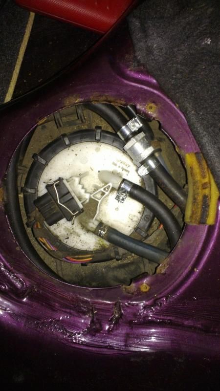

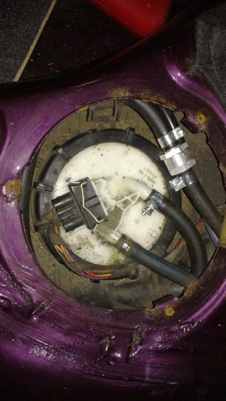

If this thing is random (especially if it turns out to be a random hot start problem) the first and easy/cheap thing to do is to take off the feed hose from the fuel pump, buy a small non-return valve, and some fuel hose (so you don't have to cut the original hose) and fit the non-return valve between the pump and the old hose.
How I did mine - after having a look thru pretty much everything else........:)
turned out VW actually made a kit for fixing this due to some problems with the fuel pump on the VR6 - but this kit is not available from VW any longer...
it looked like this:
Just make sure the hose and non-return valve is of correct size (can't remember from top of head, but I'm sure someone in here know if it's 8 or 10mm :))
