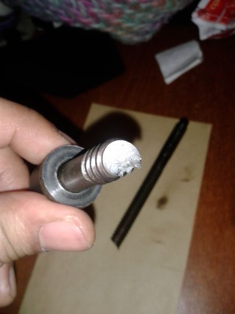

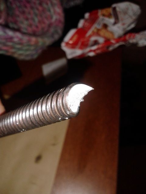

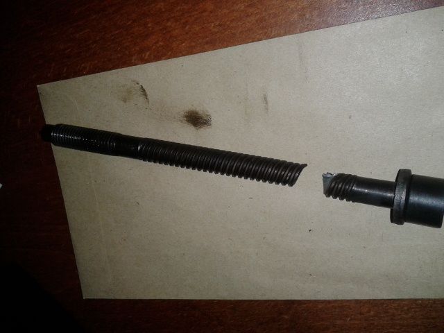

We're they cheap after market bolts? Did you blow the bolt holes out ie remove coolant from the bolt holes as it can cause hydrostatic lock strip threads and possibly snap a bolt.
If the hole was clear and the threads were fine then it must be a duff bolt, what manufacturer were they from? I would only normally use either genuine or oem quality such as elring, reinz etc.

Here is a few pics of the bolt:
There are some thing's that have to be oem I personally wouldn't have went near GSF for these mate but hey ho you live and learn I'm sure you have learn't hat's off to you for doing it yourself in the first place.:D

What instructions came with the bolts and did you follow them? Pre oiled or dry fit? Shearing at 40nm is **** poor
