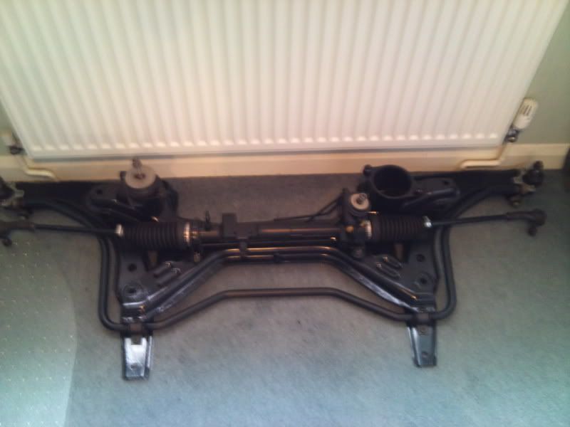

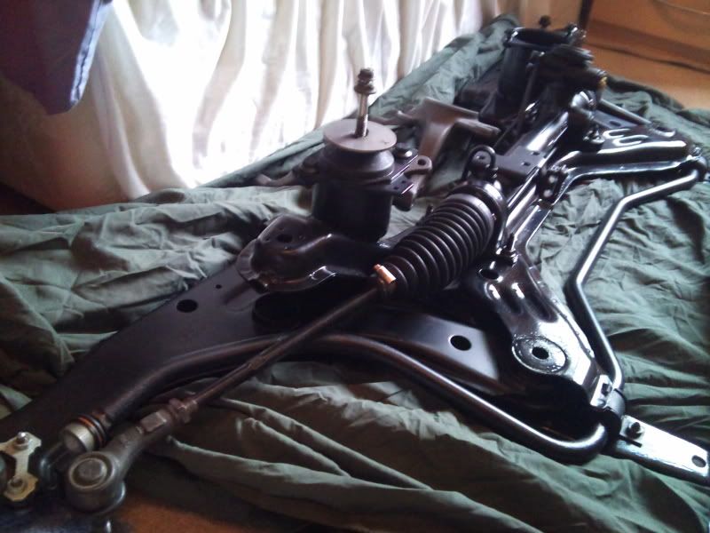

Can anybody explain which way up the torsion bar goes on the front suspension please?
got it all back from powder coating and not sure and my pictures dont show it very well.
Thanks
The centre part should be lower and not higher than the side parts if that makes sense? If it is higher, then you risk it rubbing on the exhaust.
I wanted to powder coat mine but I was concerned that the twisting motion of the bar would just trash the fairly delicate powder coating. I thought about plastic dipping mine or even just hammerite instead?
Edited by Sean_Jaymo
Thanks Sean, that makes sense, i have it laid out on the living room floor now! Should the very ends of it what the connecting links fasten too point downwards?
