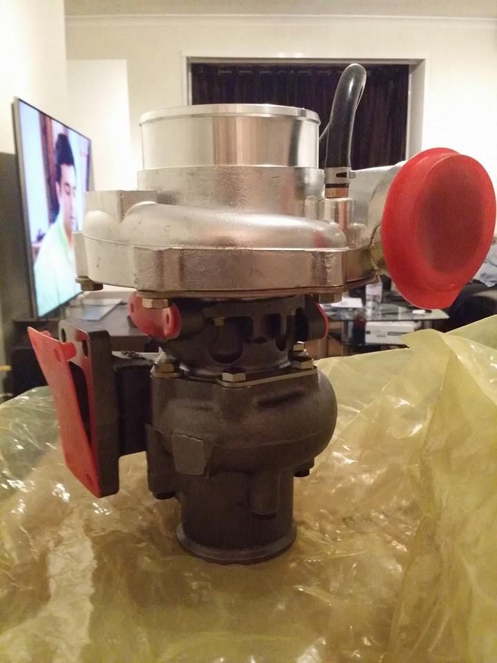

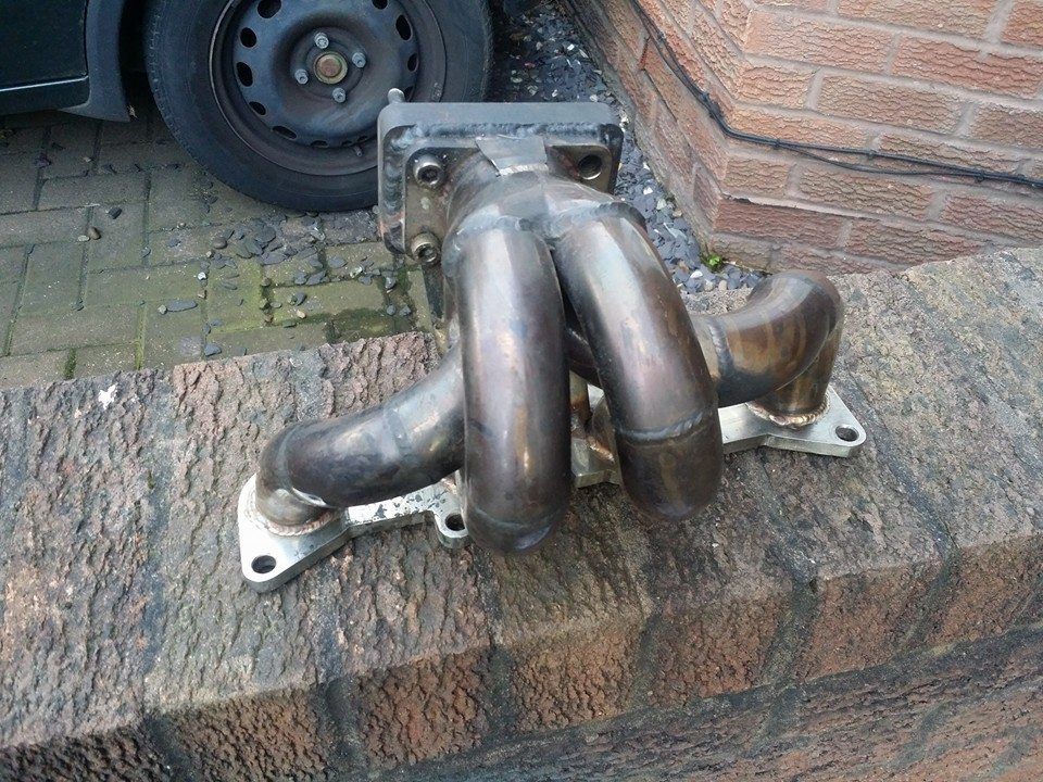

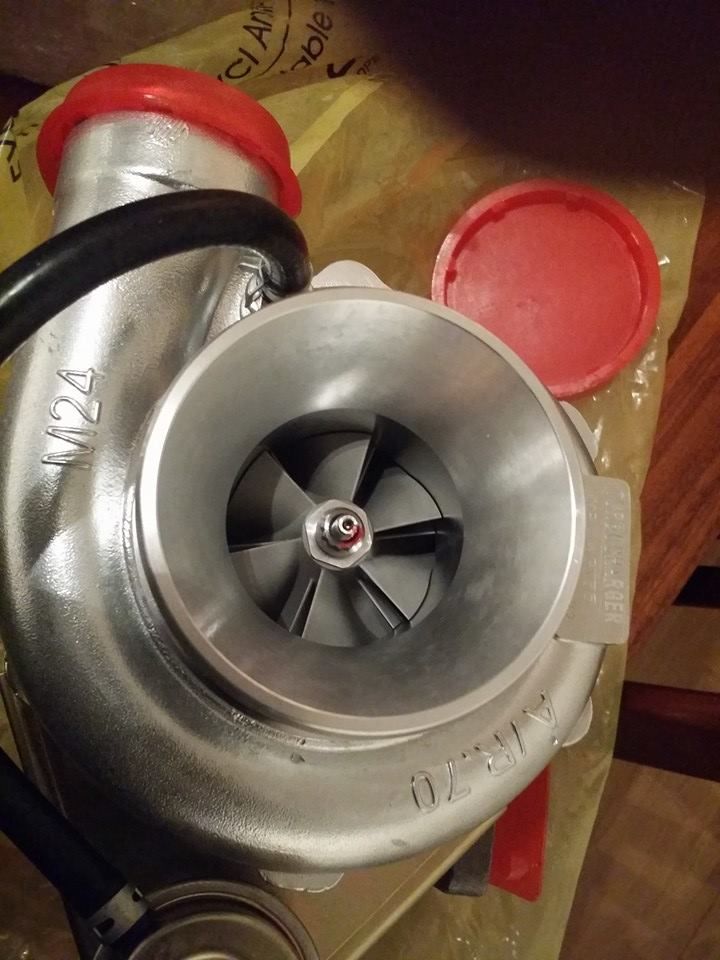

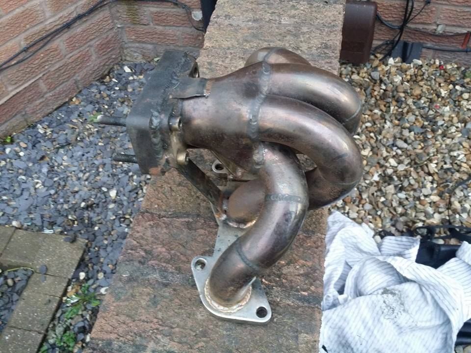

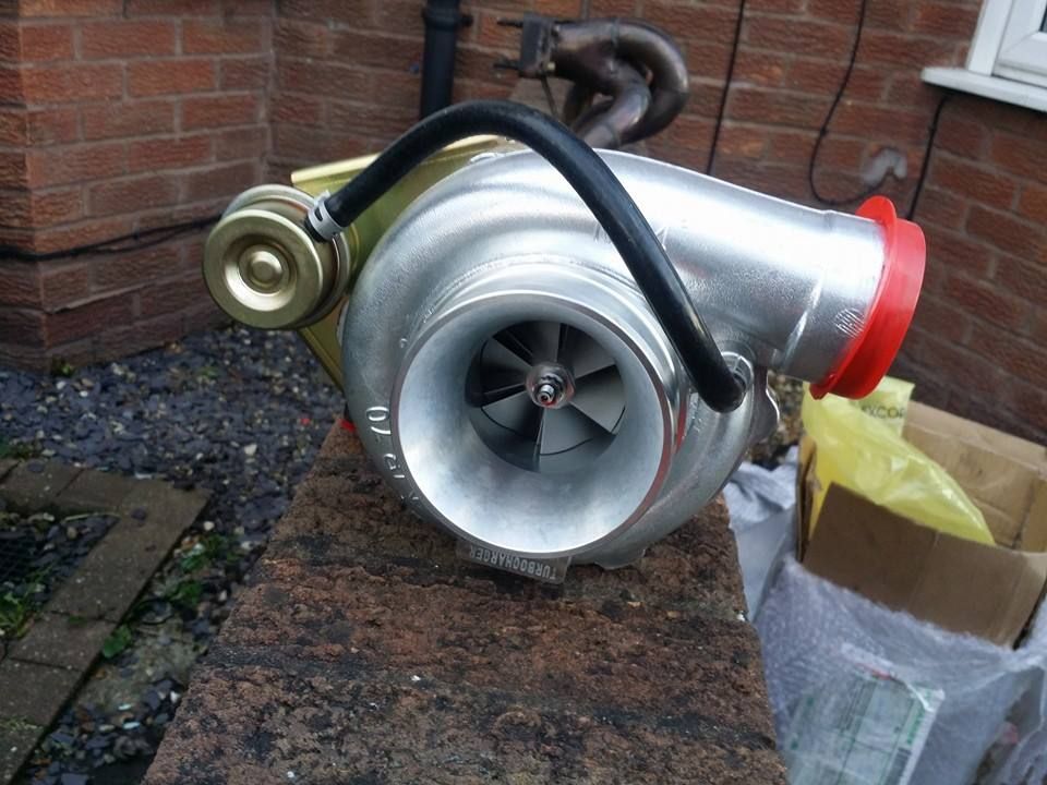

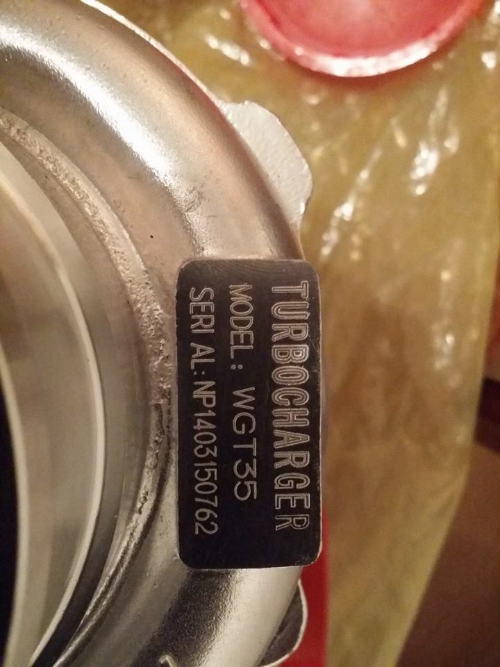

vw bobby 10 Posted May 13, 2014 The new Turbo and Manifold Quote Share this post Link to post Share on other sites
borachris 0 Posted May 14, 2014 The guys tell you a 30 is probably a bit big so you buy a 35? Not quite sure what the point of asking for advice is if you're just going to ignore it lol Oh well I hope it works out anyway :) Quote Share this post Link to post Share on other sites
Kevin Bacon 5 Posted May 14, 2014 Genuine GT35Rs are external wastegate. God knows what that turbo is. A hybrid of some kind but it doesn't look as big as a GT35, so may not be too laggy. Looks like an improvement over a T25 though, which was never a great turbo :) Quote Share this post Link to post Share on other sites
mic_VR 3 Posted May 14, 2014 Manifold looks good, just hope that Turbo is up to the job as well. Let us know how you get on mate. Quote Share this post Link to post Share on other sites
vw bobby 10 Posted May 14, 2014 Cheers guys, I did take the advise on board, just wanted a massive turbo Turbo is a Chinese one, which has been balanced, so should be ok, let's hope and see Also a quick question, what size injectors will I need to use on this? Quote Share this post Link to post Share on other sites
Kevin Bacon 5 Posted May 14, 2014 Gawd knows without knowing the full spec and what hp you're aiming for, but 500cc would be a good start for around 350-400ish. Are you going standalone then? Haven't you got a K Jet valver? Quote Share this post Link to post Share on other sites
vw bobby 10 Posted May 14, 2014 No the kjet valve is gone now, I have a 9a with forged pistons, running a t25 turbo at the moment, 3 bar fuel rail, 440cc injectors and a megasquirt ecu. So this will just be a upgrade on my engine, looking run 400+ bhp Quote Share this post Link to post Share on other sites
VR6 Gar 10 Posted May 14, 2014 Turbo is a Chinese one, which has been balanced, so should be ok, let's hope and see �� Jesus, you're brave putting a chinese turbo on such an expensive engine. They normally fall apart after a few hundred miles taking the rest of the engine with them. What do you mean by 'it's been balanced'? Quote Share this post Link to post Share on other sites
vw bobby 10 Posted May 14, 2014 Cheers and will keep this updated on how it runs, hopefully should run sweet and achieve the 400+ figure I want :thumbleft: Quote Share this post Link to post Share on other sites
vw bobby 10 Posted May 14, 2014 Jesus, you're brave putting a chinese turbo on such an expensive engine. They normally fall apart after a few hundred miles taking the rest of the engine with them. What do you mean by 'it's been balanced'? The main thrust bearing shaft has been balanced again, as the problem with the Chinese turbo's the shaft give way on these. If fully balanced up, should run good from what I have been told Quote Share this post Link to post Share on other sites
borachris 0 Posted May 14, 2014 I considered one of the Chinese turbos for mine and as you say a lot of them are poorly balanced, very good idea to have it balanced properly! Quality seems very hit and miss but I have seen some impressive results from them on 1.8t's! Looking forward to seeing some more of this :) Quote Share this post Link to post Share on other sites
Kevin Bacon 5 Posted May 14, 2014 If a professional turbo company has had it in bits and balanced it, it should be OK. I think they would have told you to chuck it in the bin if it was that bad :lol: Personally I would only use established brands like Garrett or Borg Warner on my engines as it's not just about the price / reliability compromise, they tend to have superior flow dynamics and turbine / compressor wheel designs over the cheaper ones. Anyway, good luck with it, I'm sure it's going to kick some big turbo butt on the roads! Quote Share this post Link to post Share on other sites

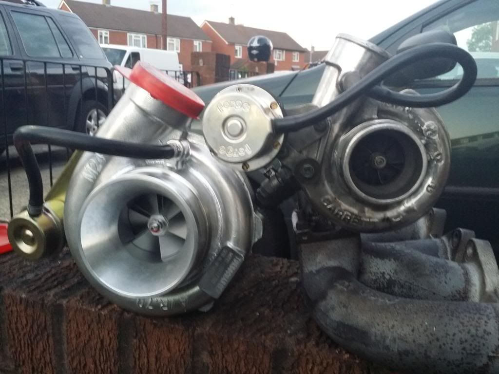

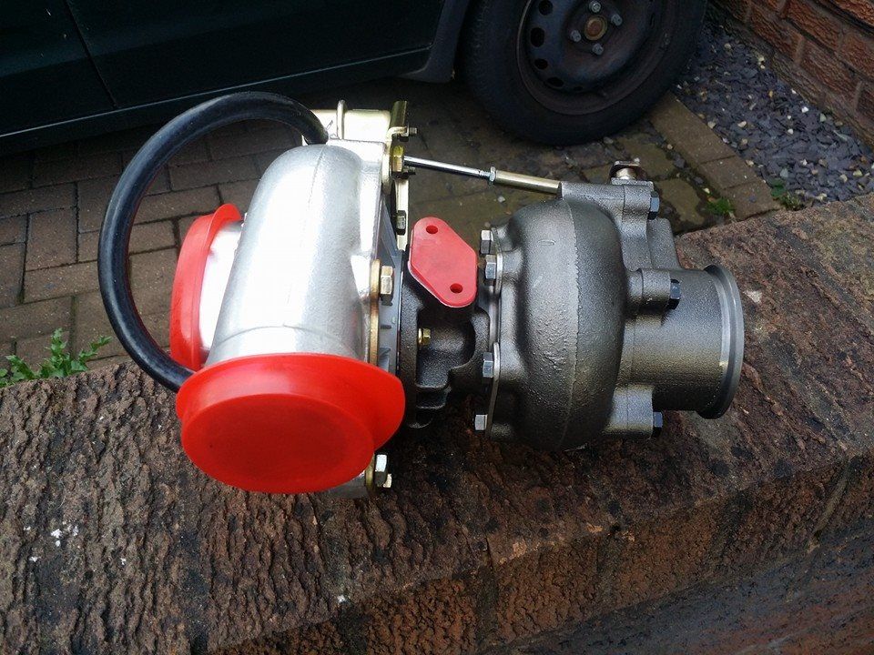

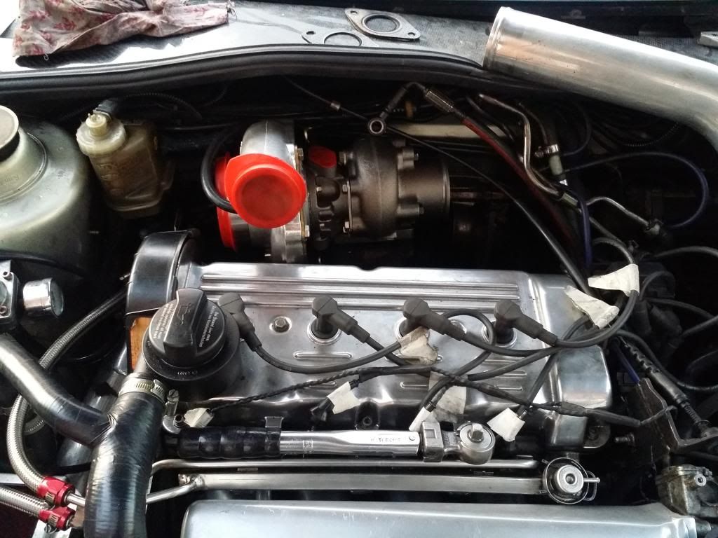

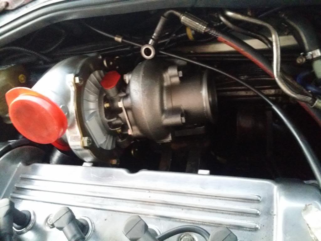

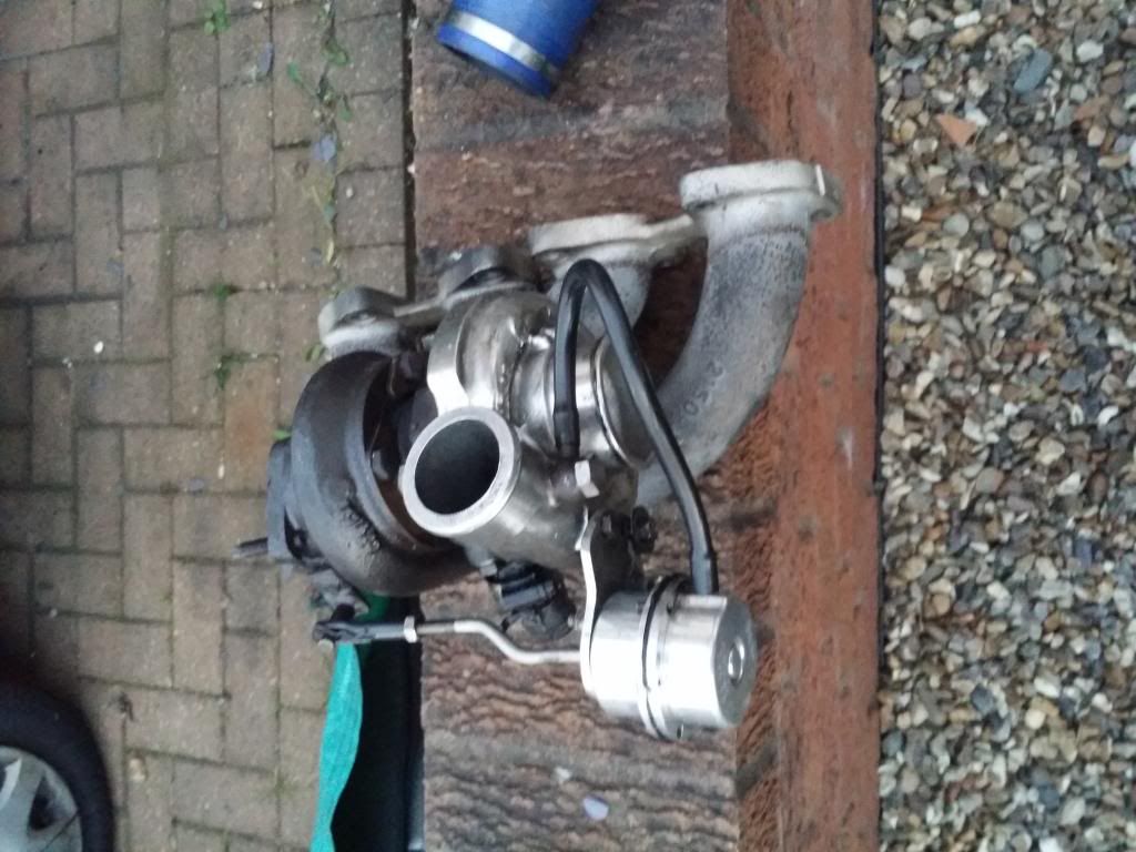

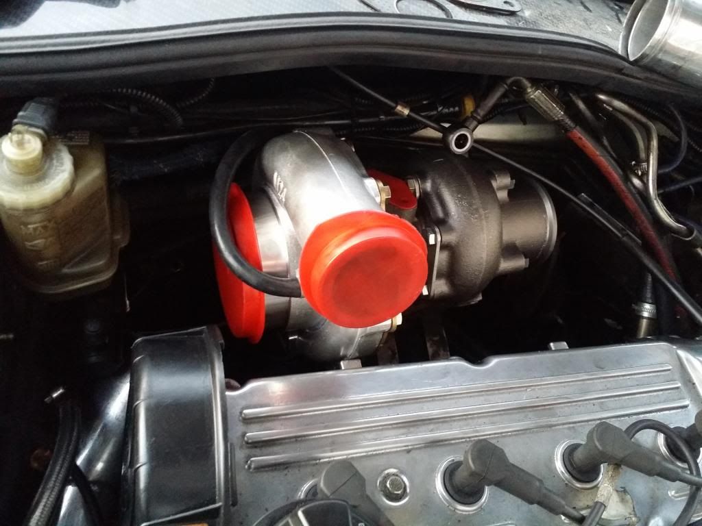

vw bobby 10 Posted May 15, 2014 Cheers guys, here is a update on how it's going, a trial fitting the new turbo, and old vs new Quote Share this post Link to post Share on other sites
Kevin Bacon 5 Posted May 15, 2014 Christ that turbo is a LOT bigger than the T25! Looking good so far! Quote Share this post Link to post Share on other sites
vw bobby 10 Posted May 15, 2014 Cheers mate, I know is massive, still trying to work round how to fit a hose for the air filter? Any ideas? Quote Share this post Link to post Share on other sites
