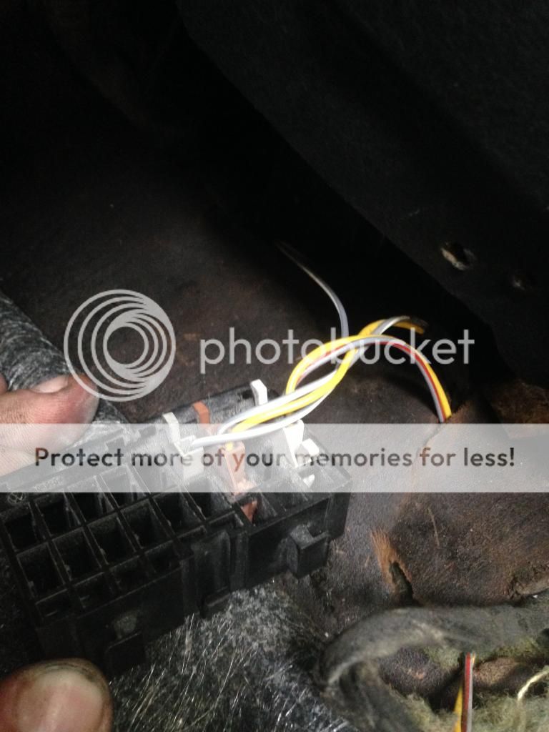

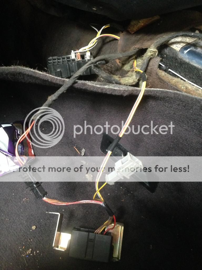

jonnyattwood 0 Posted June 15, 2014 This is what I have found looking at it today, but I don't know how it should look?? So could you tell me if this is right please and if it's not tell me what's wrong :) Thanks jonny Quote Share this post Link to post Share on other sites
