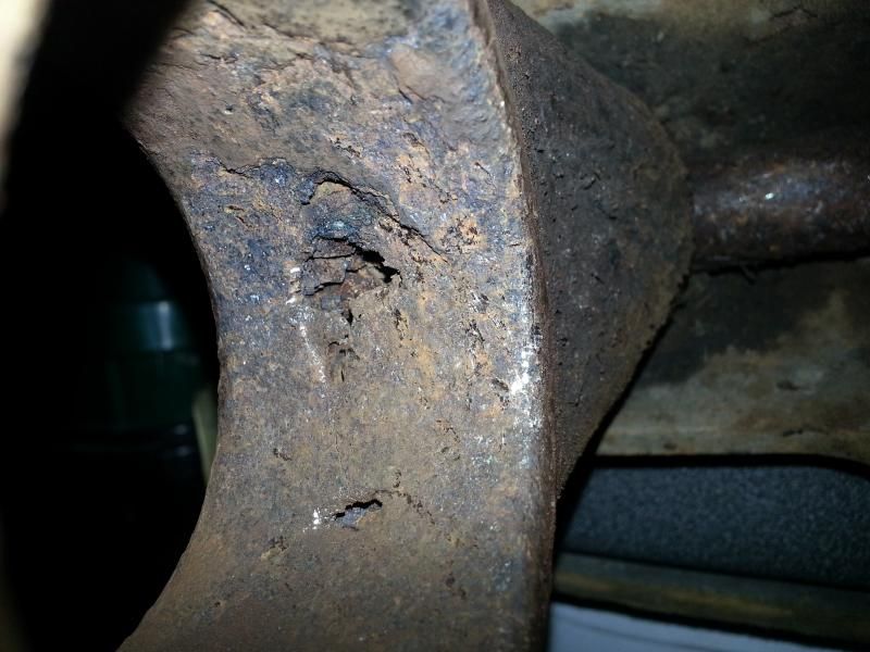

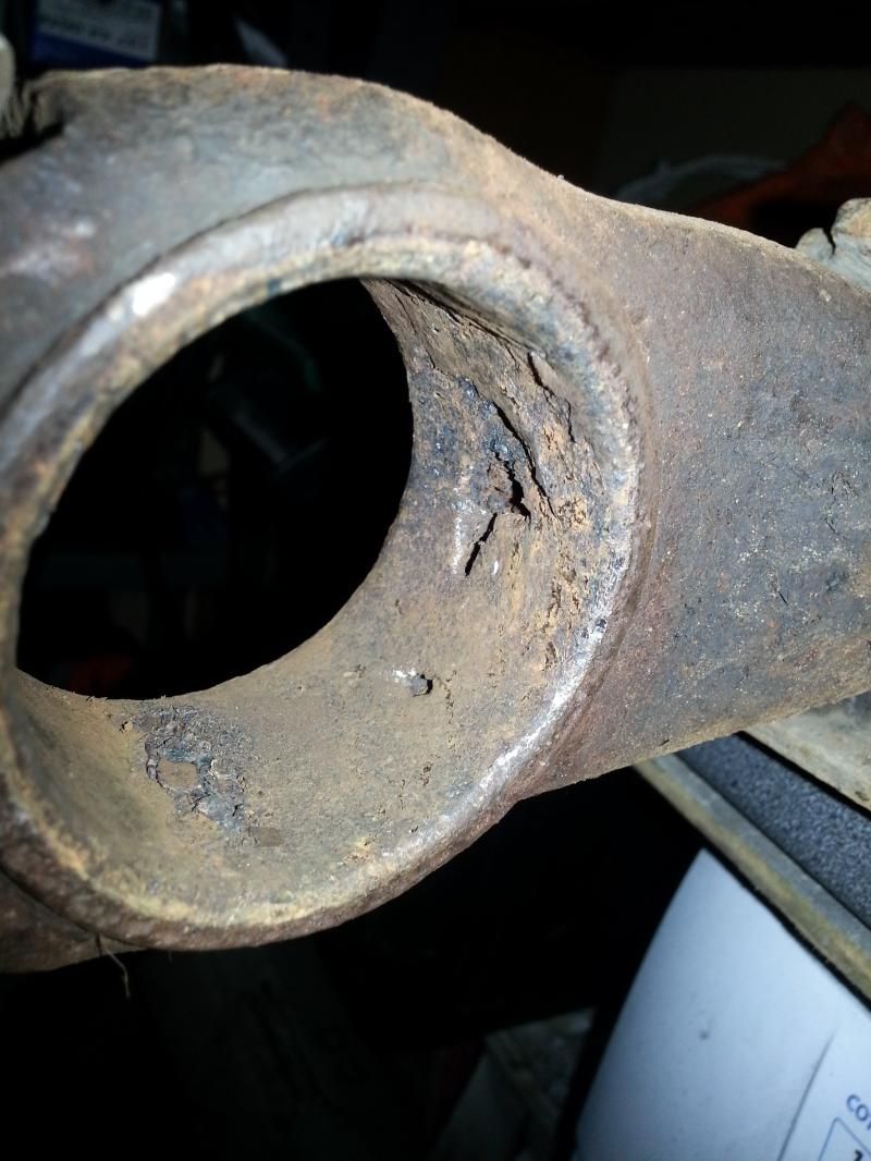

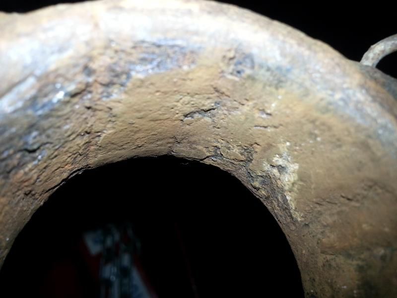

Removed my rear beam and bushes, i had the powerflex ones, must of gone in about 4yrs ago. When i removed the old standard bushes there was no corrosion in the mounting points. Just removed the powerflex ones and was lots of rust, took ages to get the bushes out.
I started to knock the rust out with a hammer and screw driver and found a hole.
The metal is rotten, so need a new beam now, (and will be using standard bushes)
