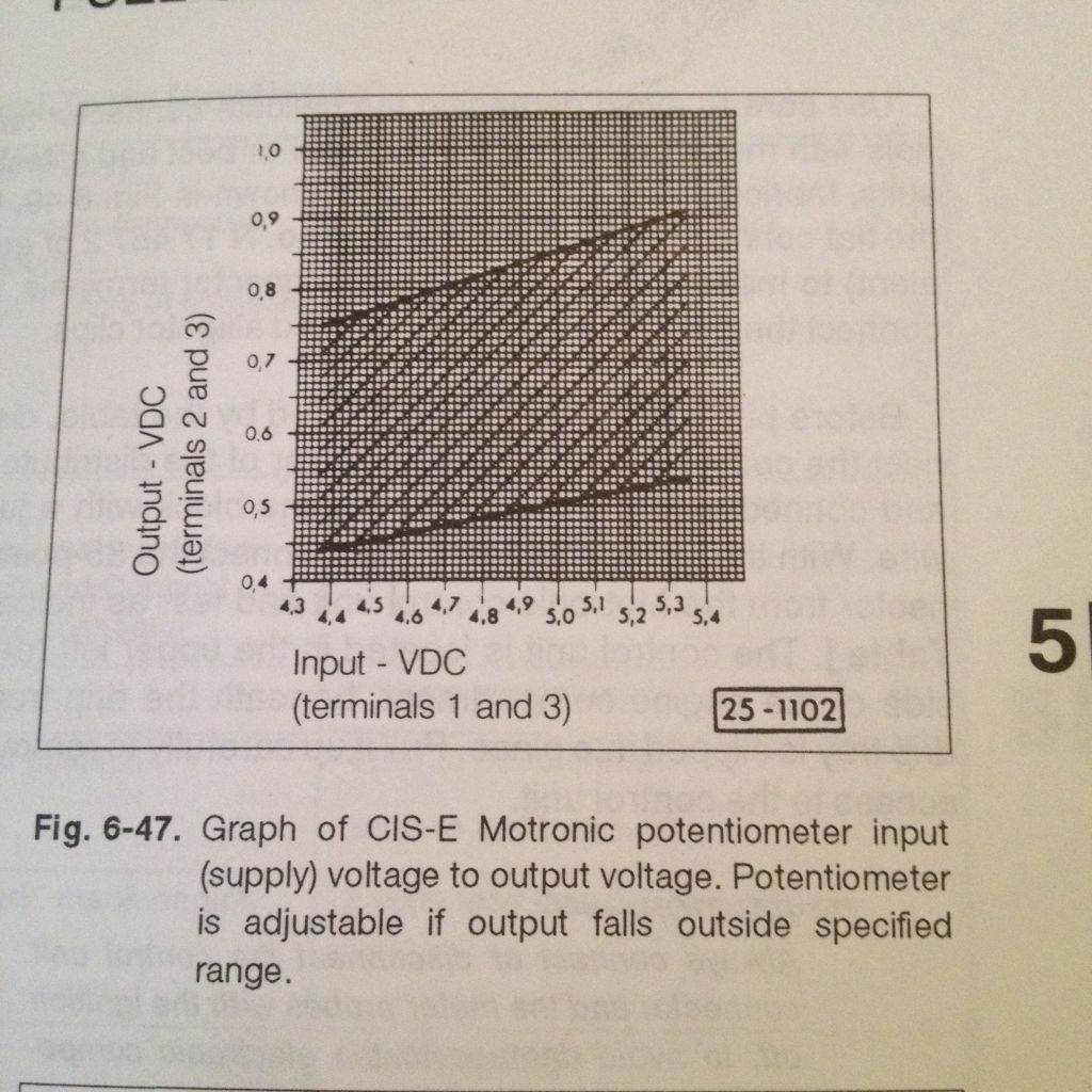

Peacedub 10 Posted February 10, 2015 (edited) Found this http://www.classic-audi.co.uk/forum/showthread.php?t=29491 which relates an Audi, but still relevant. Shame the Corrado MAF doesn't unbolt like this one. Good thread and very similar to corrado. Maybe you can strip down the MAF potentiometer but i dont think i would like to try it! i think you would have to strip the whole metering head to get to the inside like what the picture shows but again i wouldnt like to try. That graph is the one thats in the bentley but i believe its slighty different but in very very slighty. where 4.8vdc shows 0.8vdc ish outout and i was getting 1.0vdc output which is way off the scale. i will get a pic tonight of what i did as those pics on audi are not very clear. I plan to do the injector test on mine, i think the difference in his complete test is that is was done on a 5 pot motor Just read replies further down. The ones that you can gain access to (MAF) are ones without an idle screw so adjustment is made within the unit i believe. Does not applies to us Edited February 10, 2015 by Peacedub Quote Share this post Link to post Share on other sites
Peacedub 10 Posted February 10, 2015 Cheers fella, hopefully it will be dry at the weekend so I have a go at it. Did your pre destruction tweaking sort out the idle issue? Yes indeed! it ran like a dream!! it still wasnt right and not in spec but felt a million times better than before hence why i tried tweaking a bit more. Just imagine what it would have been like if i would have got it in spec?? Hopefully my new unit will come today or tomorrow. I will do the same test on new unit and catalogue pics of how i did it Quote Share this post Link to post Share on other sites

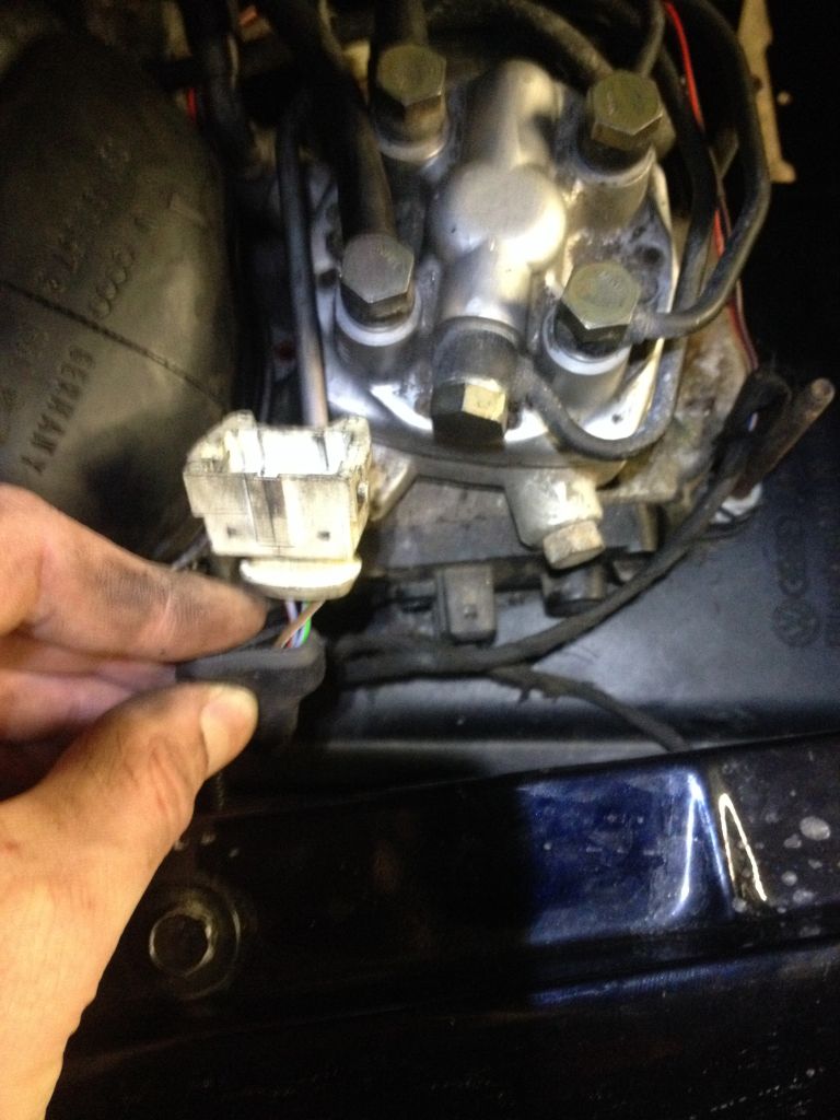

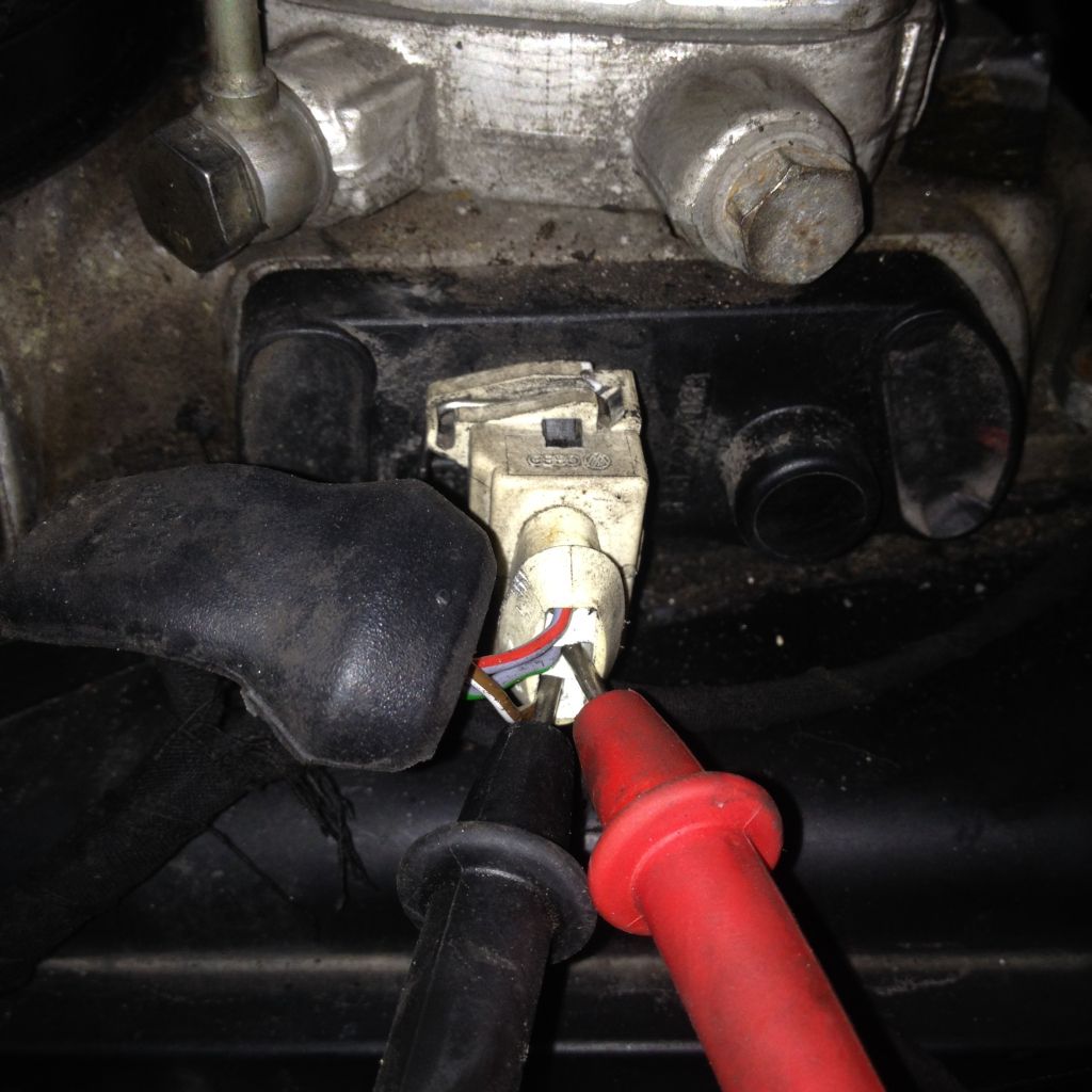

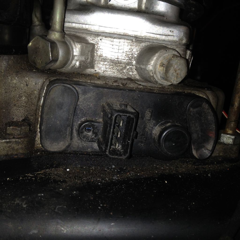

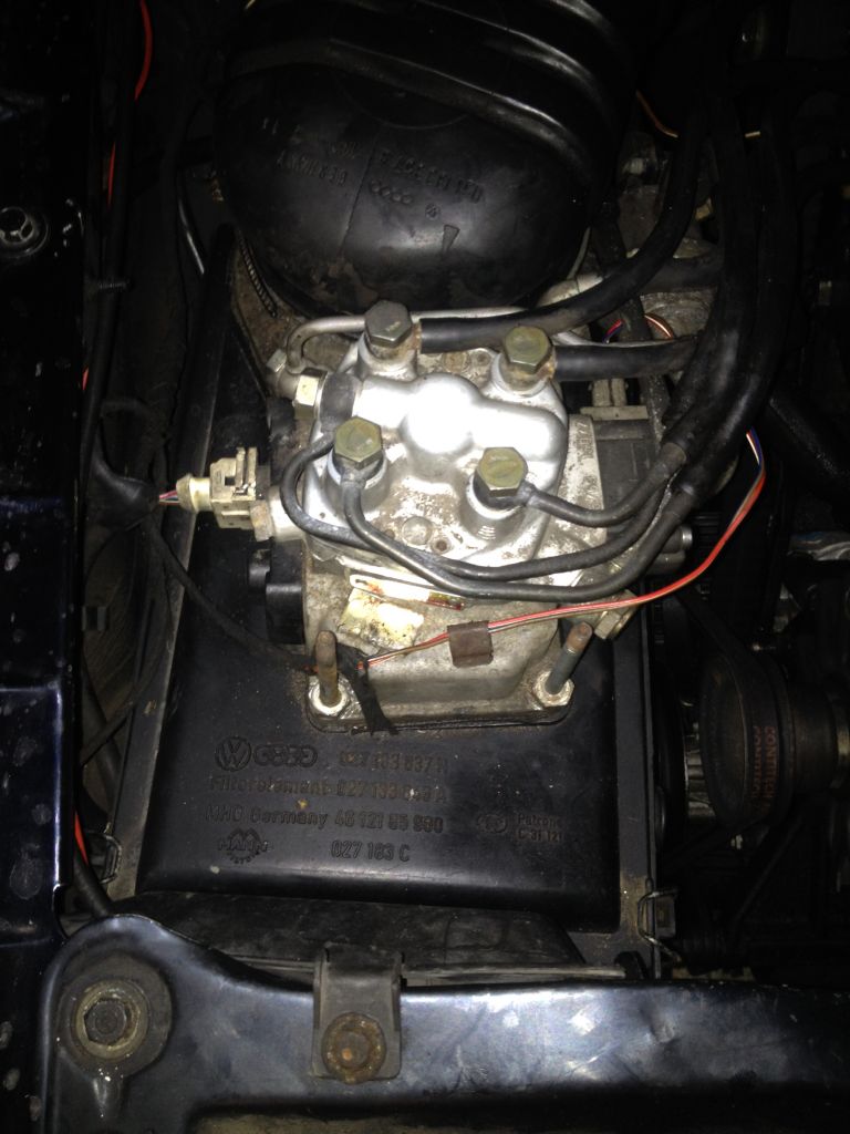

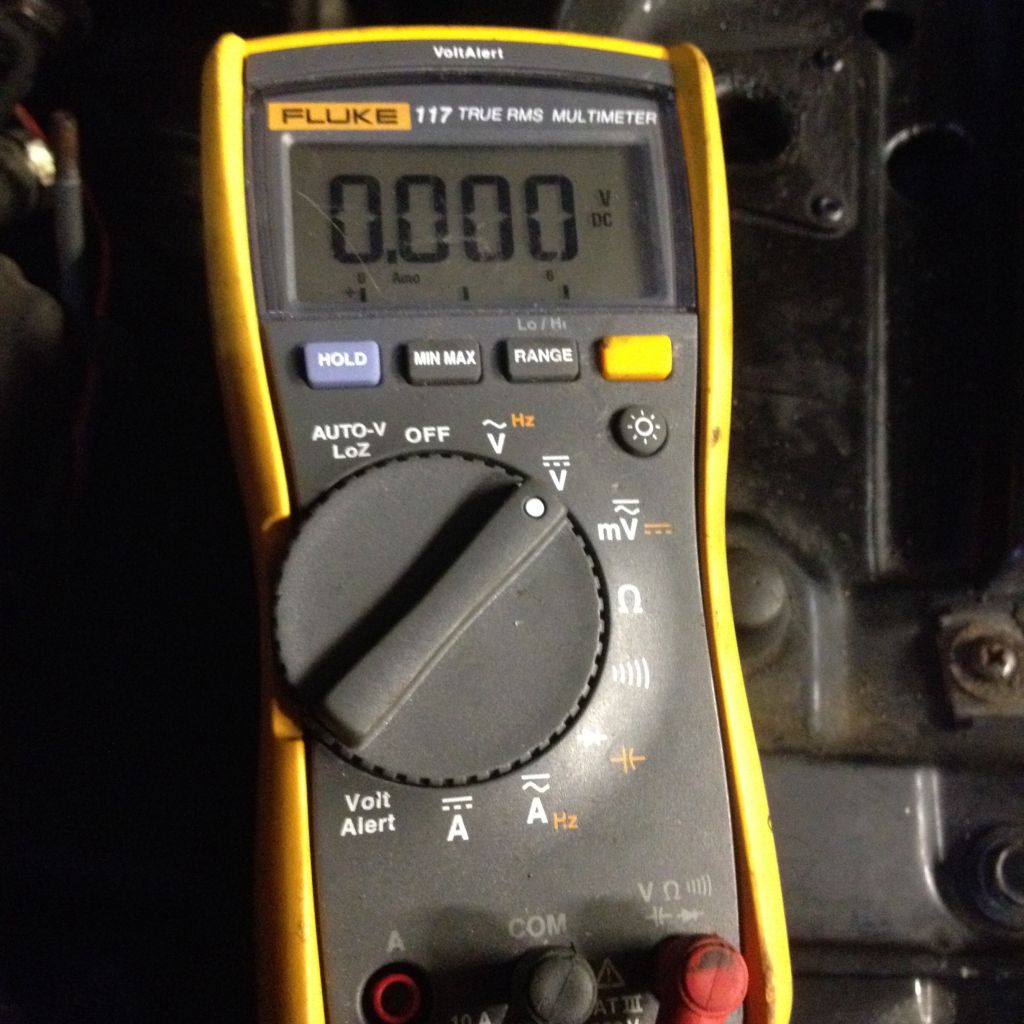

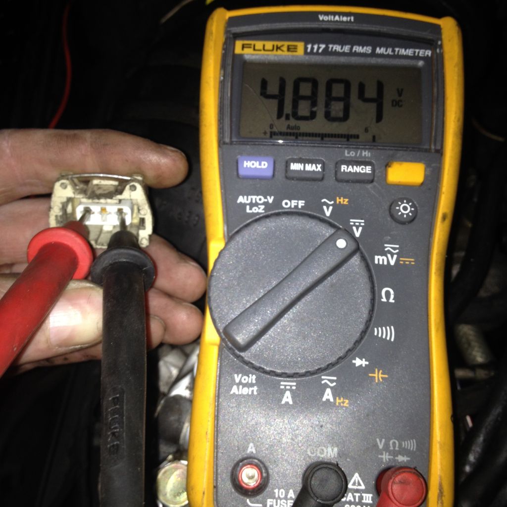

Peacedub 10 Posted February 11, 2015 (edited) Ok guys here it is. My new metering head hasn't arrived yet but my ABS sensor did so after I fitted that I created this catalogue. And just to add what a byatch the sensor was to do! Metering head (to the left the white plug for MAF) http://i1052.photobucket.com/albums/s441/sparkypeace/corrado%20maf/45fa74c3f25d78429d32fb03d852ac81_zpsc2feae3b.jpg[/img]"]http:// The MAF plug disconnected http://i1052.photobucket.com/albums/s441/sparkypeace/corrado%20maf/b0d0fbcee95520376abdca52e779897b_zps7e45db15.jpg[/img]"]http:// Ignition on input reading pins 1 & 3 (I said 1&2 before my bad) http://i1052.photobucket.com/albums/s441/sparkypeace/corrado%20maf/7cee0bea800576b909244d5f550e43fd_zpsc695cfbd.jpg[/img]"]http:// MAF potentiometer (the hole to the left is where the trim screw should be, notice mine hasn't got 1! This should be covered in silicone originally and once trimmed be siliconed back up) http://i1052.photobucket.com/albums/s441/sparkypeace/corrado%20maf/8a35c2923a4c828562041aec81f595b5_zps1666a40e.jpg[/img]"]http:// Connected back in MAF. Protective boot pulled back and take readings from pins 2&3 while engine running and at idle for 2 mins http://i1052.photobucket.com/albums/s441/sparkypeace/corrado%20maf/3993fb3edb312fe44236dfd16d85039c_zps48b2876b.jpg[/img]"]http:// I was getting no reading meaning its duff but I was getting 1VDC before http://i1052.photobucket.com/albums/s441/sparkypeace/corrado%20maf/0af1f87cf2d332ff7ca434476d32f037_zpsaf01c55d.jpg[/img]"]http:// The graph in Bentley. 4.8vdc input should get between 0.48vdc and 0.82vdc so mine before destruction was way out http://i1052.photobucket.com/albums/s441/sparkypeace/corrado%20maf/a0a67617a777d57a2918fac7eeb76fa1_zps99727b55.jpg[/img]"]http:// Bentley guide http://i1052.photobucket.com/albums/s441/sparkypeace/corrado%20maf/3b79f37e3d688e36cfabaf2cc0adedbc_zps34482e46.jpg[/img]"]http:// I hope this gives you guys a good guide to testing your valver if it's running a bit rough. It takes literally 2 mins to do and is well worth doing if you think it might be something else like I did, i.e ISV or idle switch Edited February 12, 2015 by Peacedub Quote Share this post Link to post Share on other sites

Peacedub 10 Posted February 13, 2015 Hi all, Just an update. Received new metering head today and fitted. Checked output of MAF and reading within spec 0.7Vdc. I believe now I need a new lambda because it still brought up fault code 516 (Tps) & 525 (02 sensor). The 525 cleared but then comes back. Also depending on ignition timing depends on when it back pops on down revs between 2-1k rpm. If it's at idle at 950rpm it back pops a lot and sounds like I have a race cam in but if I adjust the ignition timing so idle above 1000rpm it's really smooth BUT keeping it there I lose power just like when you advance and retard a cam, same theory really with the ignition timing. I get good top end when it's at low idle rpm but really bad power low down and vice versa when timing adjusted to idle over 1000 rpm. Hope all that makes sense? Going to borrow mates C02 probe and see what's going on. On a good note the new head has really made a difference with the idle, it's steady as a anything without a murmer. Do I need to leave the timing and let it adjust on its own? I know it's not good if you keep adjusting it. I just want it back the way it was when it was wanting to wheel spin everytime it hit 3.5 - 4k rpm and kept going to redline! Quote Share this post Link to post Share on other sites

MZpog 10 Posted February 16, 2015 Had a go at my MAF over the weekend. Voltage was 4.8 at the plug and 2-3 was a little out of spec on the low side. Whilst under the bonnet I lent on the elbow that comes off the metering head and it stopped the surging. Tried this a few times and ever time stopped the surging. Plan b, into garage for the spare I have, fitted this and now idle is sorted. Weird thing was I can't see any splits in the elbow and spraying round it with easy start didn't affect. Sorted now (I hope) Quote Share this post Link to post Share on other sites
Peacedub 10 Posted February 16, 2015 Had a go at my MAF over the weekend. Voltage was 4.8 at the plug and 2-3 was a little out of spec on the low side. Whilst under the bonnet I lent on the elbow that comes off the metering head and it stopped the surging. Tried this a few times and ever time stopped the surging. Plan b, into garage for the spare I have, fitted this and now idle is sorted. Weird thing was I can't see any splits in the elbow and spraying round it with easy start didn't affect. Sorted now (I hope) Well I wish I had that kinda luck! Have you read my update and dramas that happened on Saturday? I've had a serious amount of bad luck with this car but I WILL NOT BE DEFEATED! The dp regulator must have gone that morning as it was all good day before. If your MAF was out of spec on the low side i personally would adjust using the trim. Mine was high so I needed to unscrew in which I think I pooped the screw off as I went too far. If you are low then you will be tightening so no chance of that happening oh and you were right about the screws hidden on each side under rock hard silicone. Must be covered good for a reason! On the other hand if your car is running good then I would leave it,lol. These cars have a tendency to self destruct by just looking at them. Quote Share this post Link to post Share on other sites
