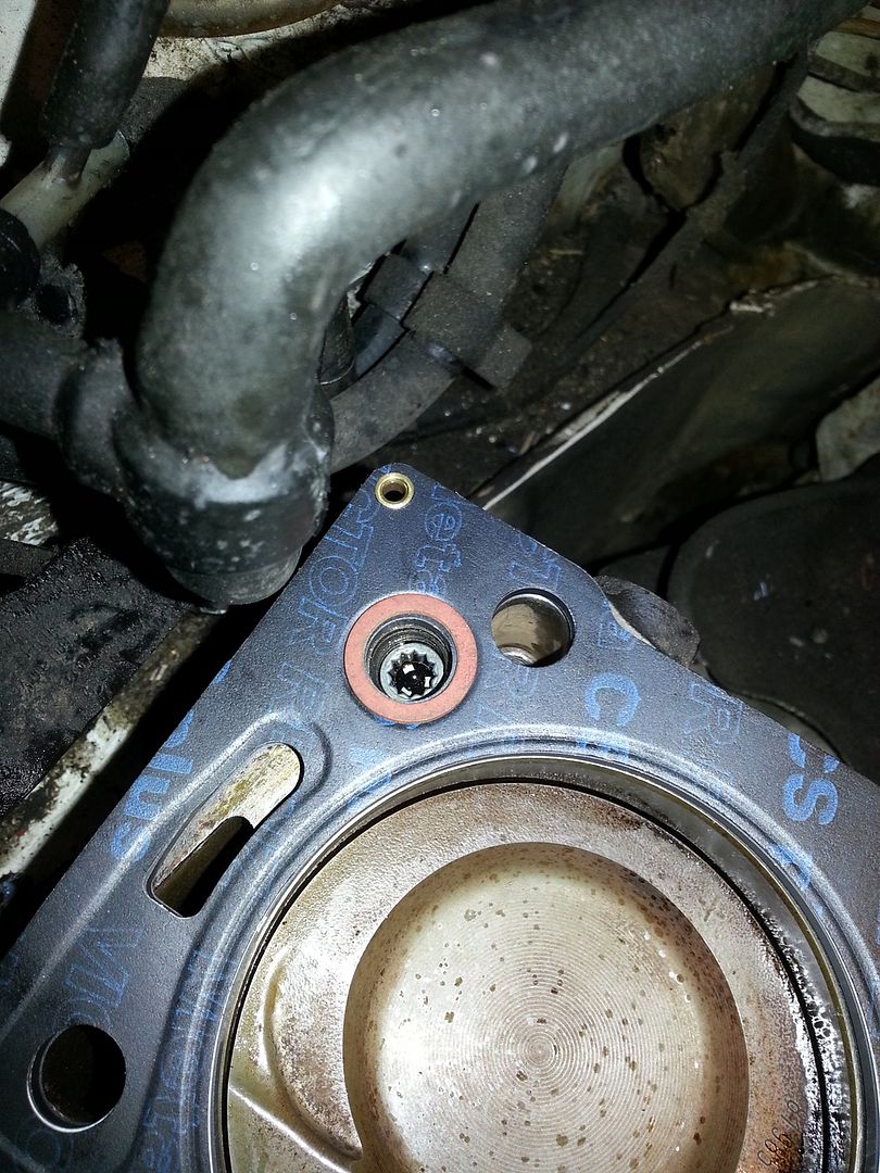

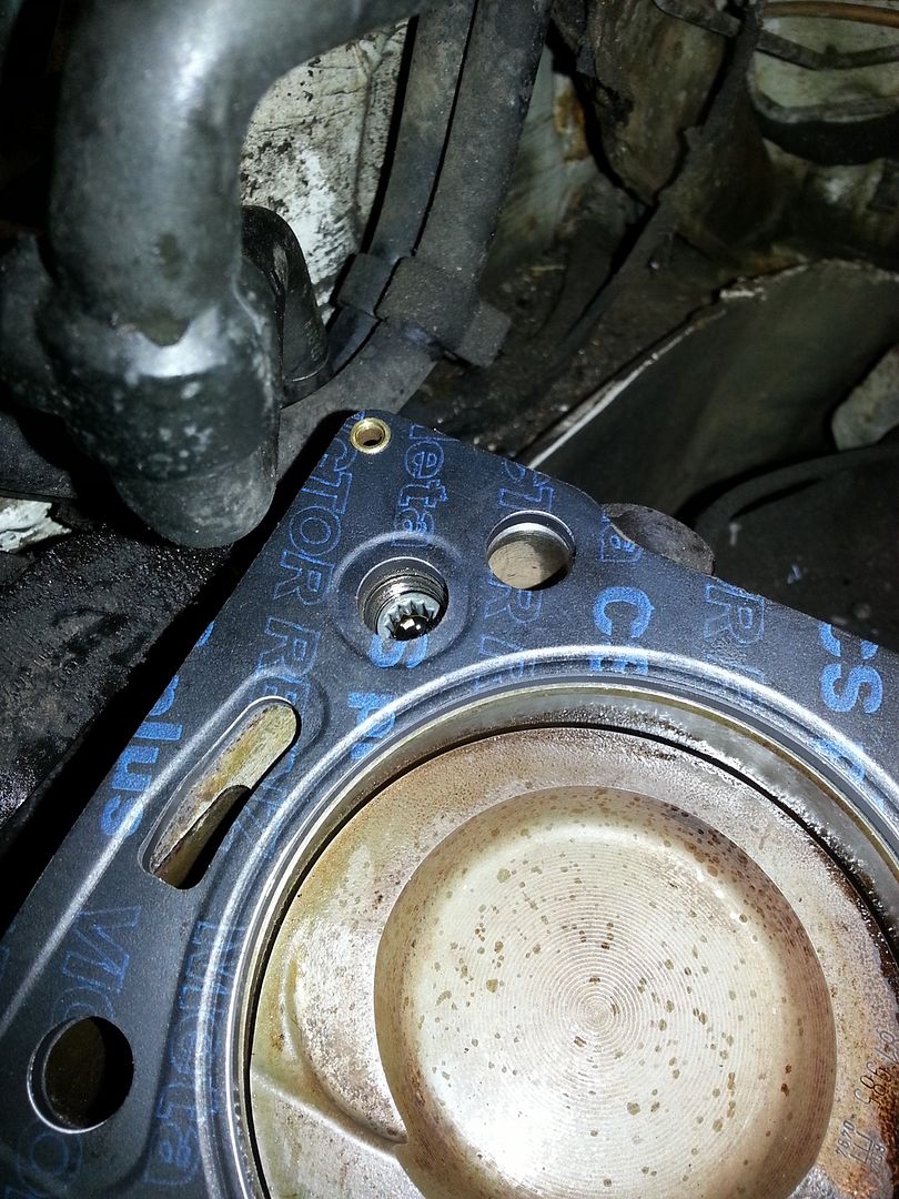

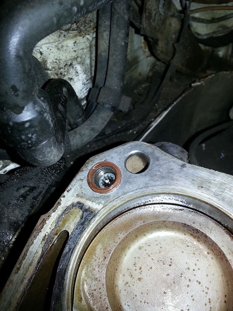

When I put my decomp plate over this oil way seal on the block face, do I need to put something on the head side to seal?? Something like a fibre washer?

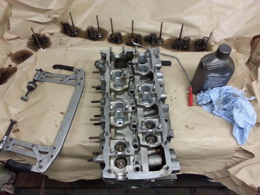

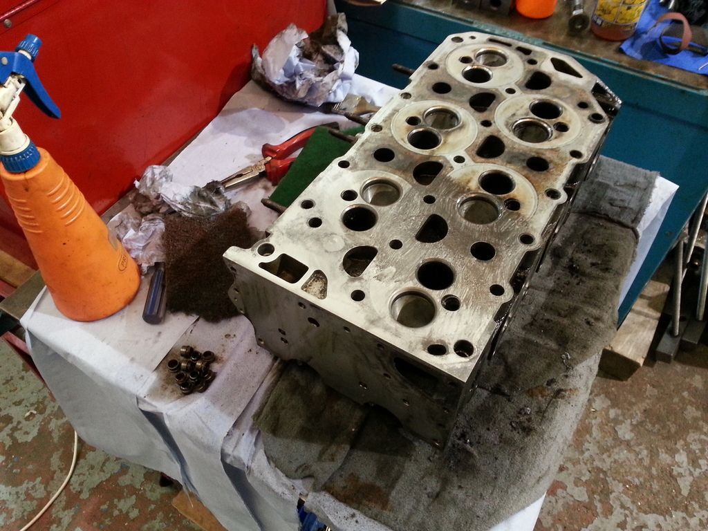

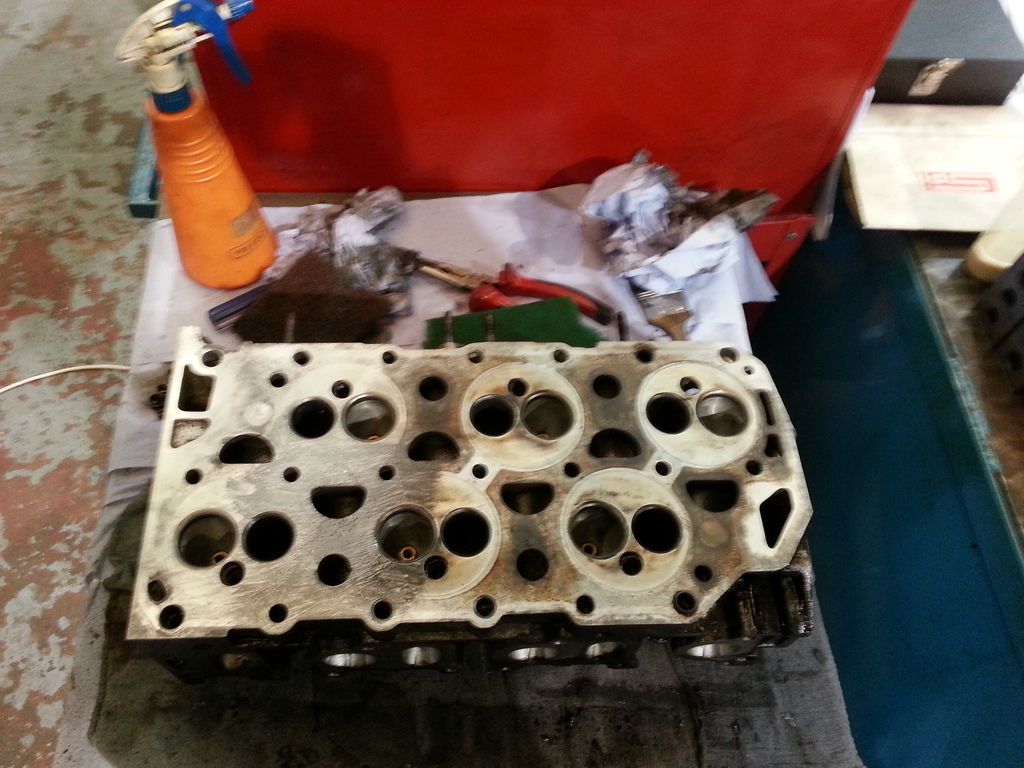

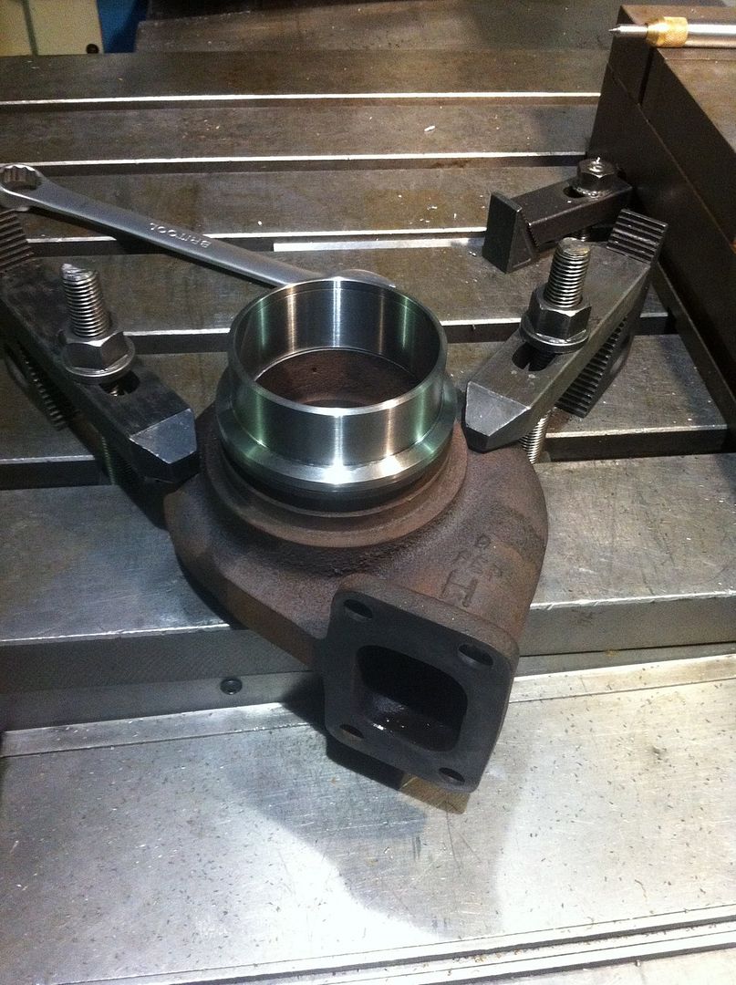

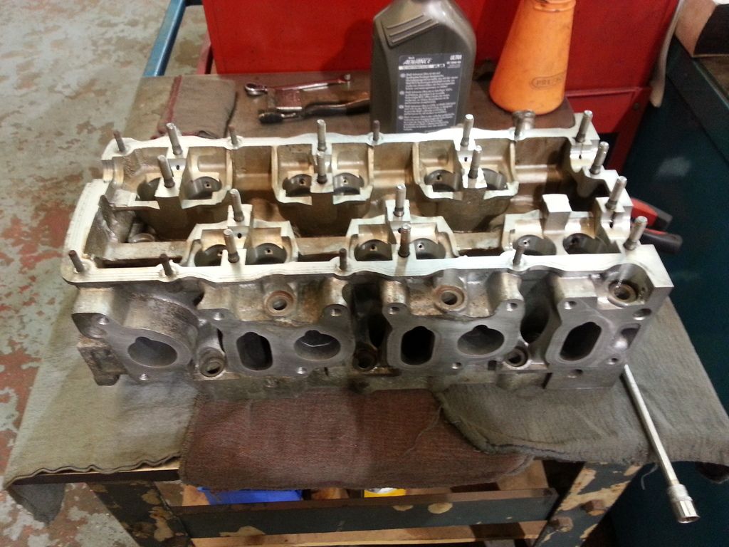

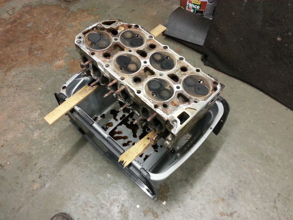

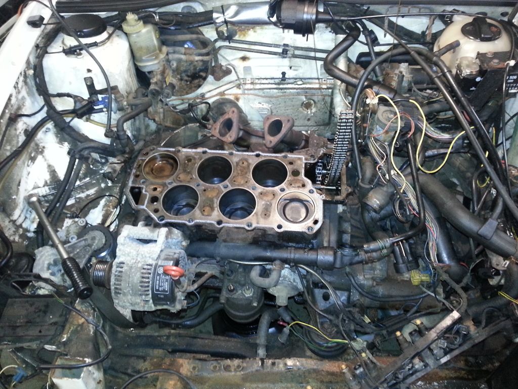

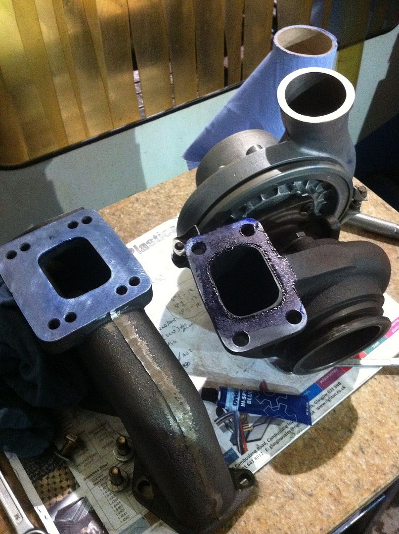

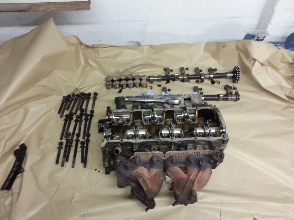

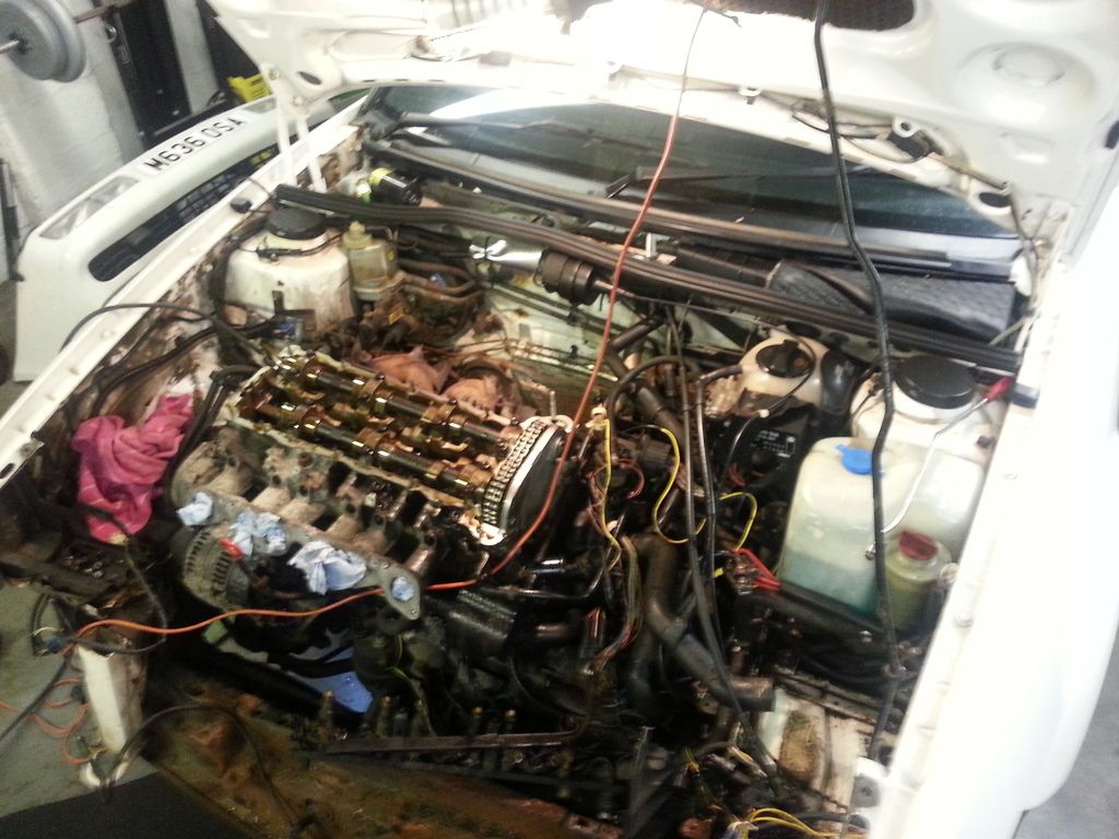

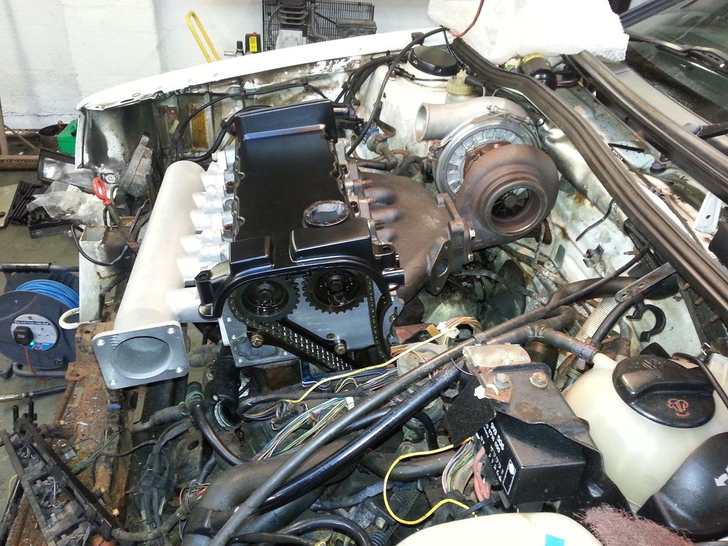

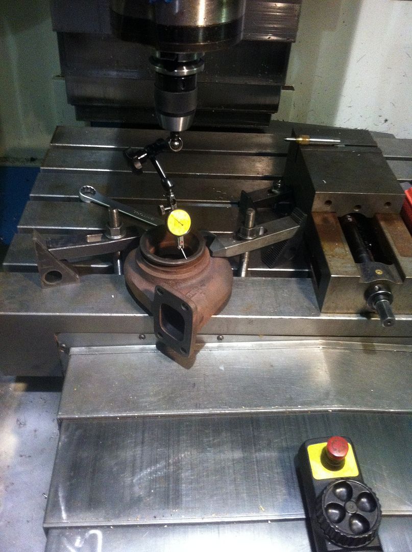

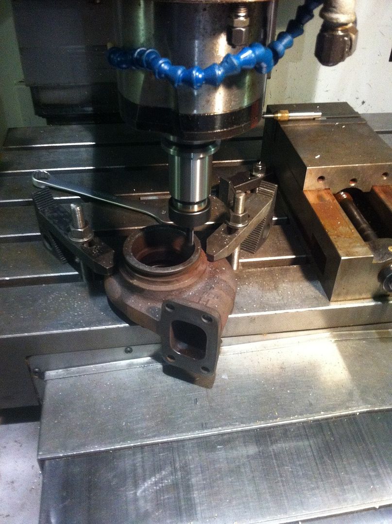

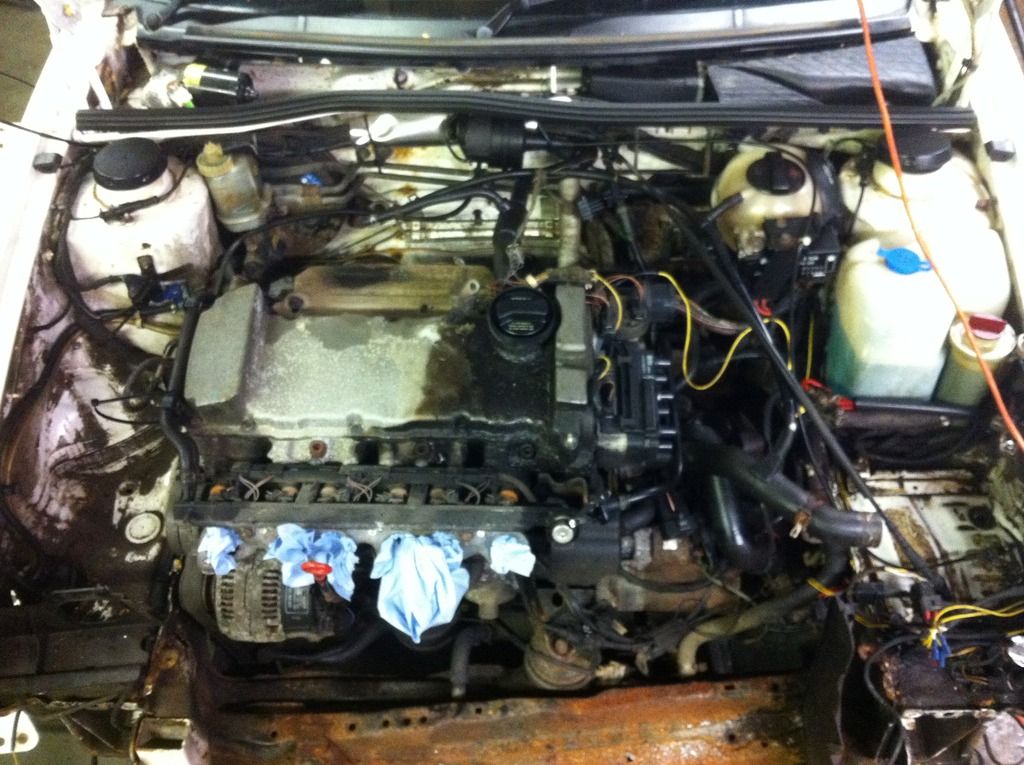

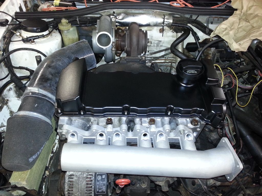

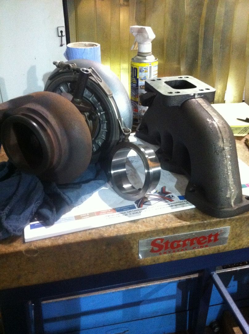

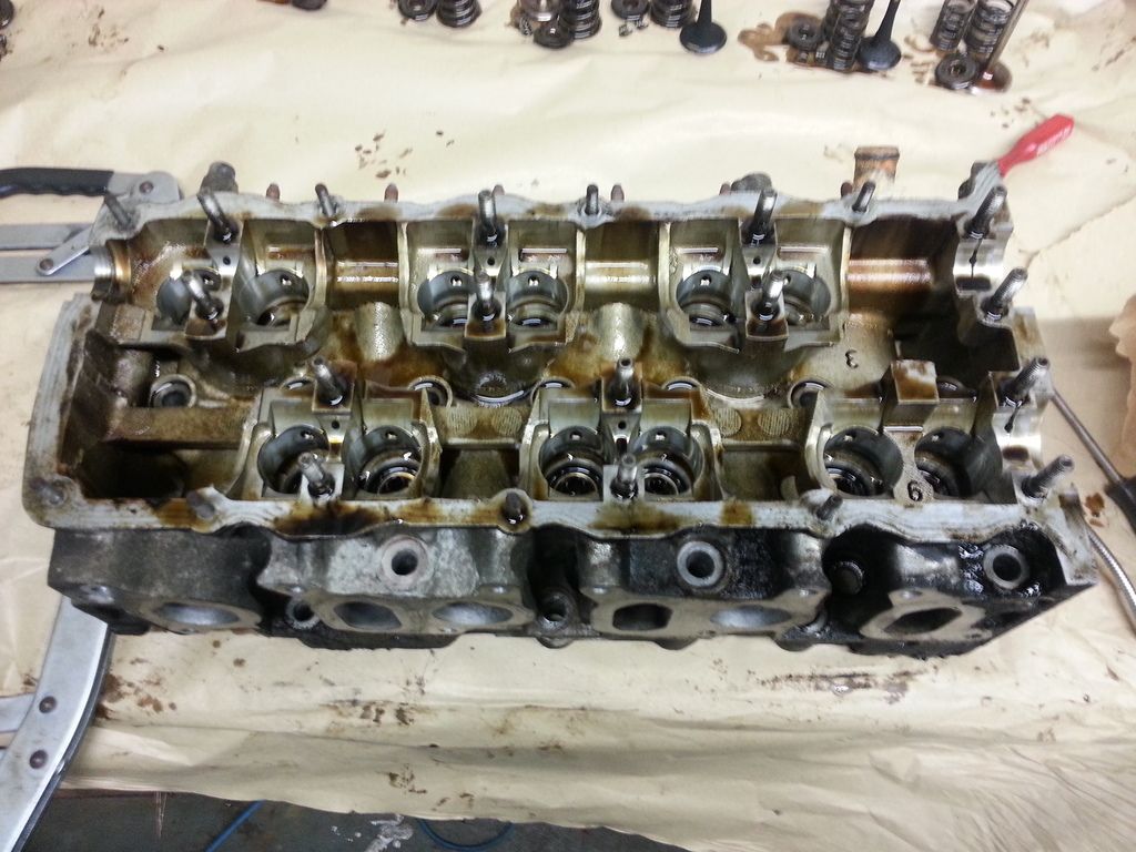

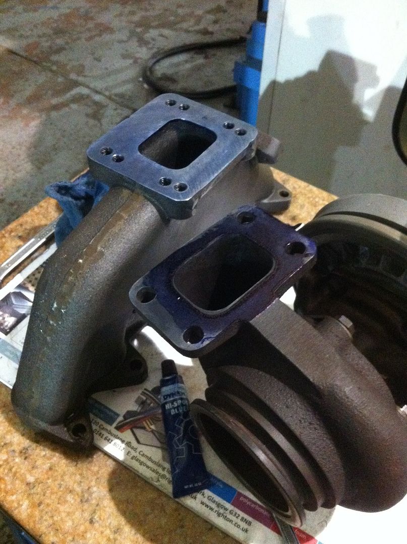

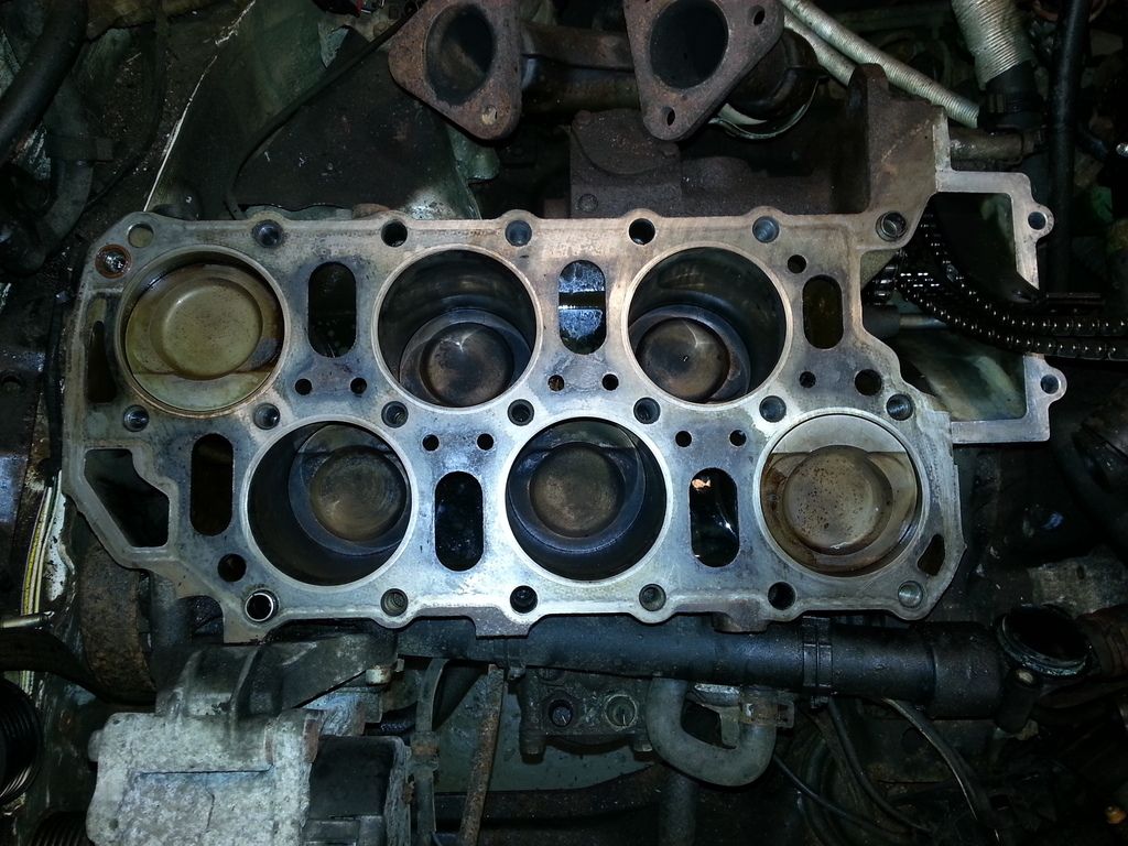

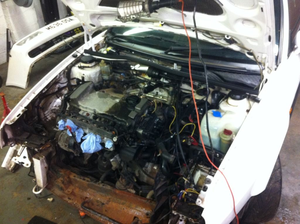

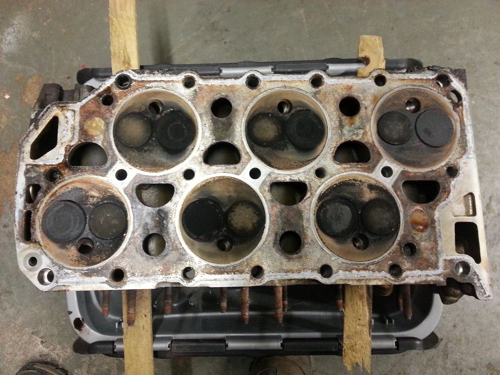

Little update, done a little profile matching between the manifold and the exhaust housing, a bit anal but why not. The head has been off and valve stem seal's have been changed. Cleaned both head and block faces then put on the decomp plate and refitted and torqued down head. Next I put the cams and sprockets back in and timed it up. Gave the cam cover a quick paint and and lay it on top for now. Still waiting on a replacement chain guide as mine is Broken, then I'll get the timing cover back on.
Profile matching
Let the excess oil drain out

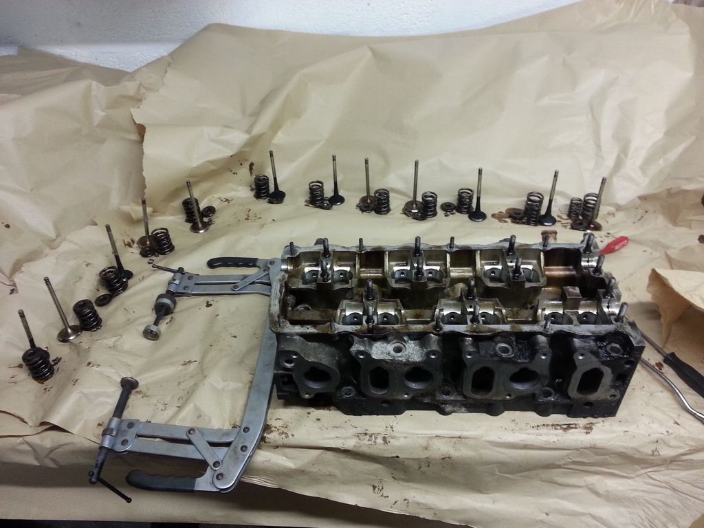

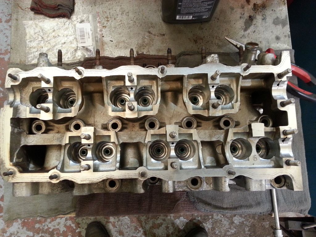

Stripped the head
Gave it all a good clean and inspection

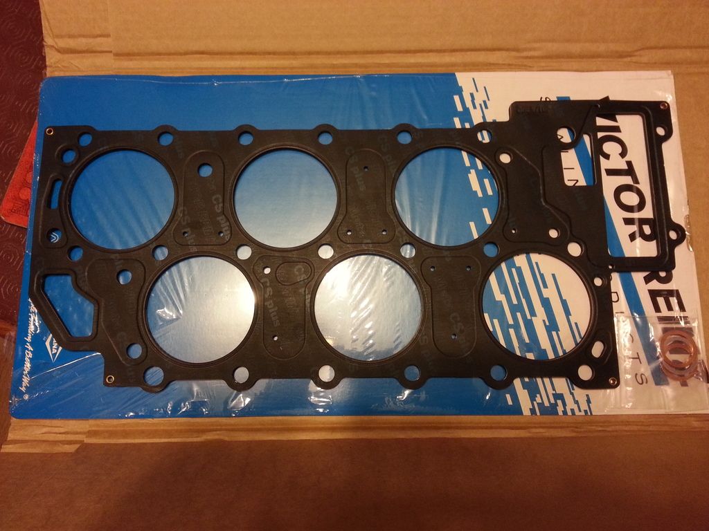

Spacer plate I got from Germany with multi layer gaskets
Built head back up
Cleaned up block face

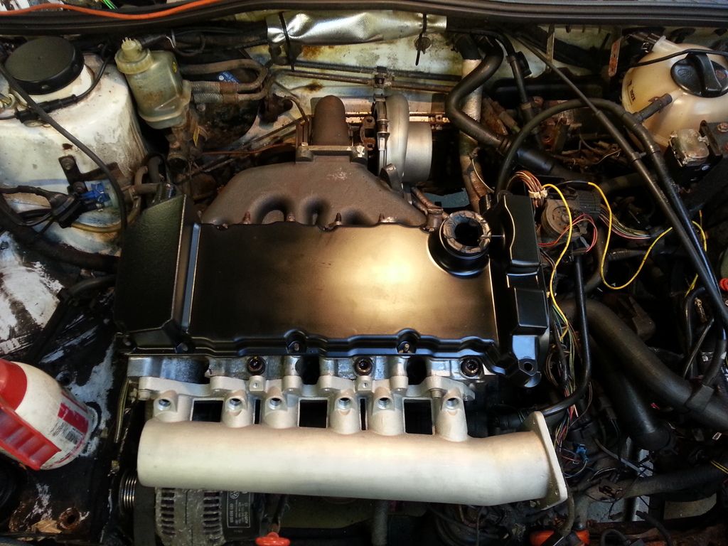

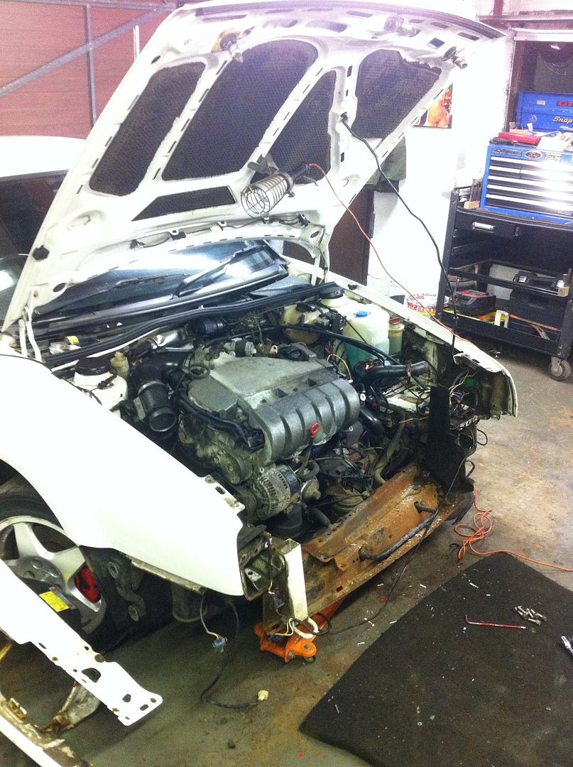

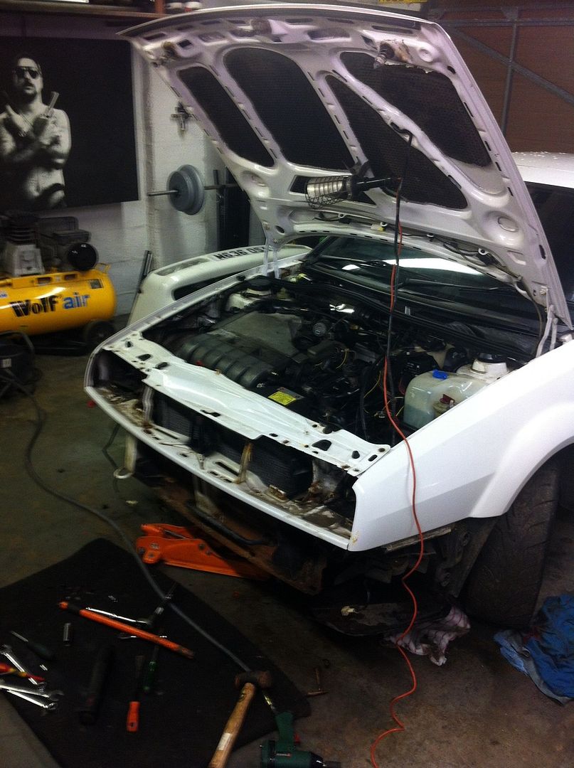

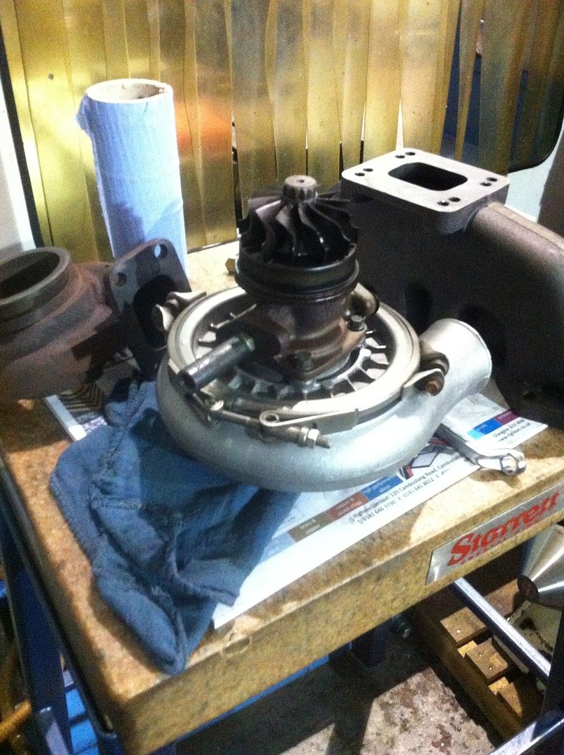

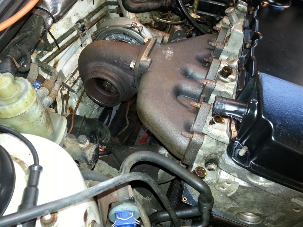

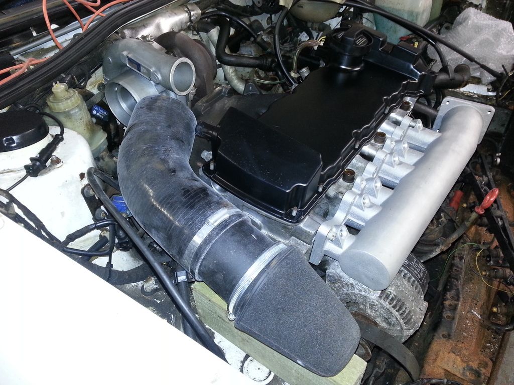

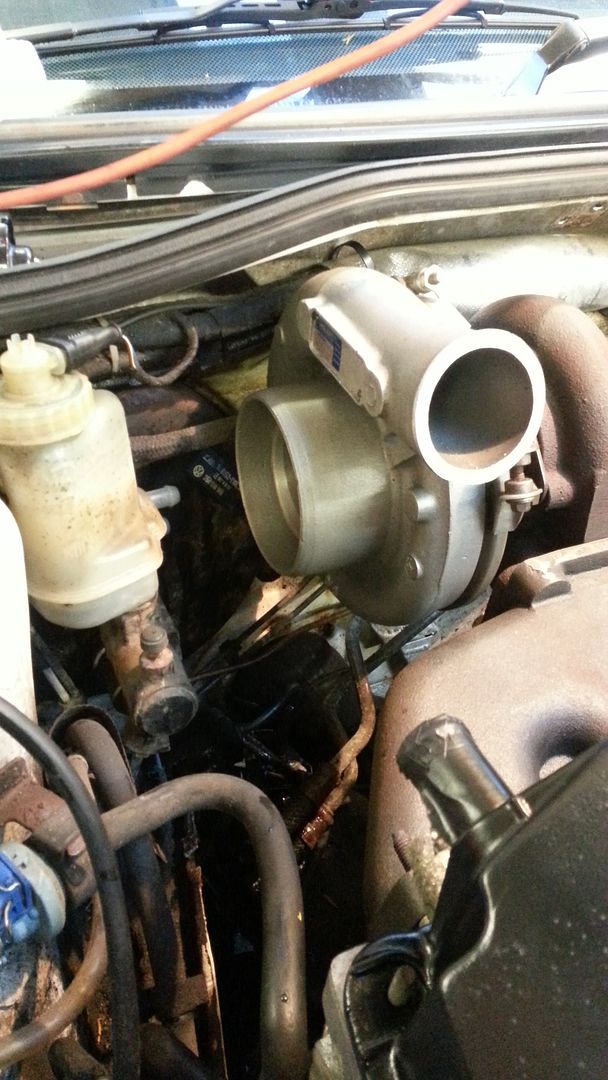

Got a bit excited and bolted on my turbo and short runner to see what kind of room I have.
I don't have a lot of room between the bulkhead and snail, plus no room for compressor inlet pipe because of servo reservoir. Thought about swivelling turbo up a little but have no bonnet clearance.

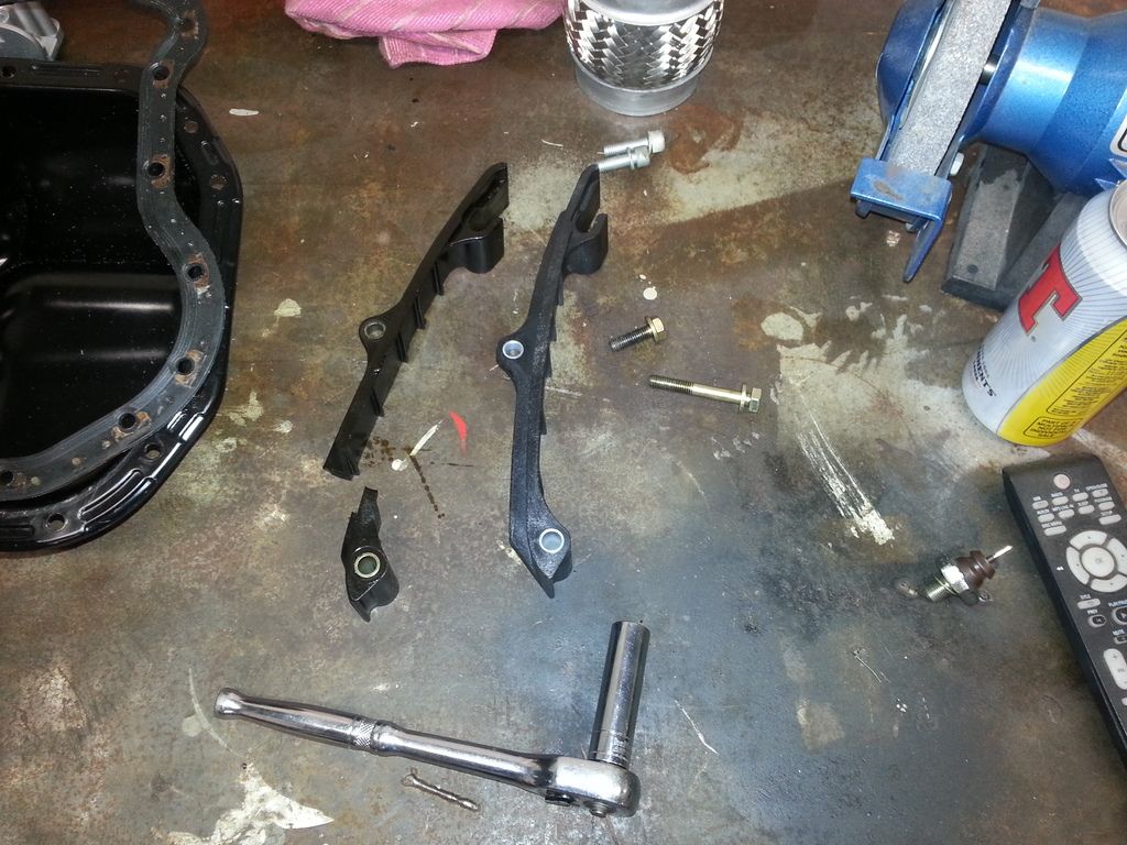

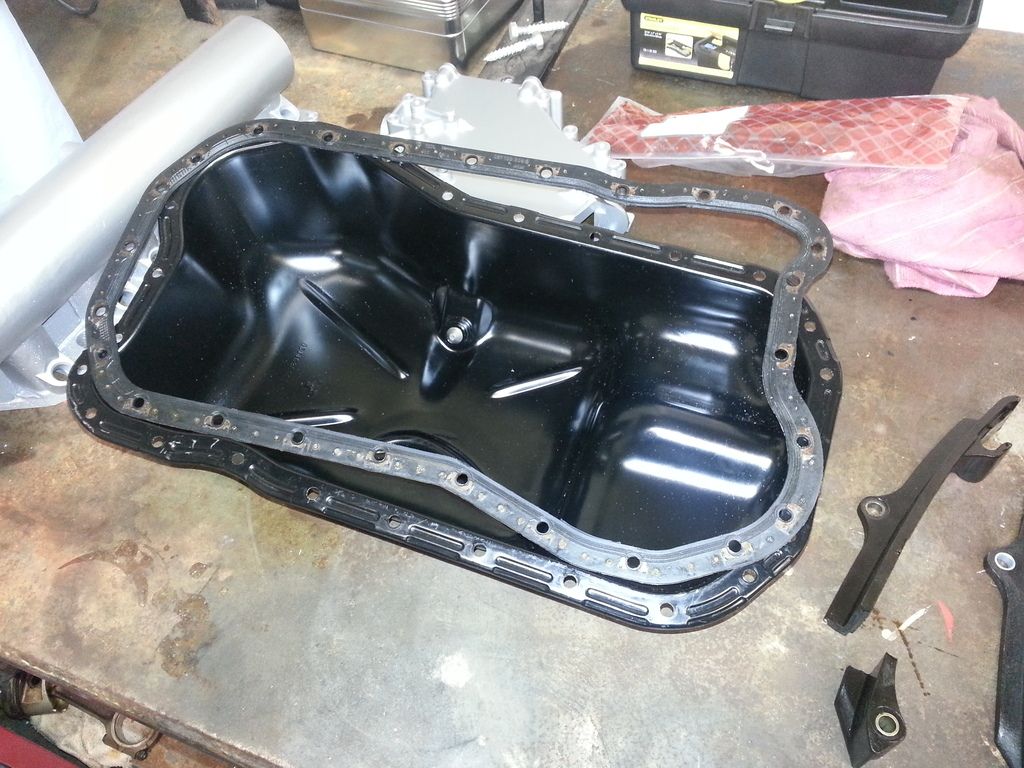

Changed my broken chain guide and put side cover and cam cover with new gasket back on.

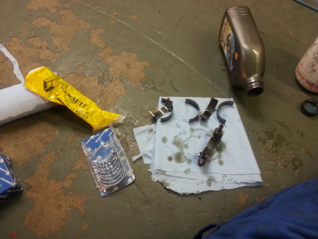

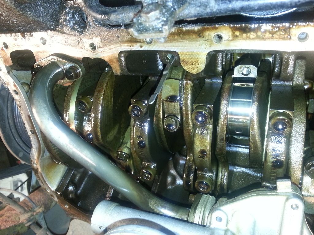

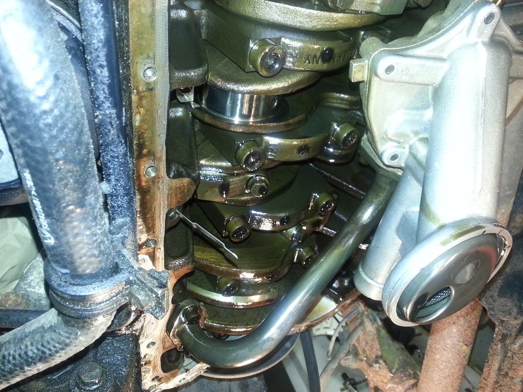

Fitted new big end shells. There was nothing wrong with the original ones.

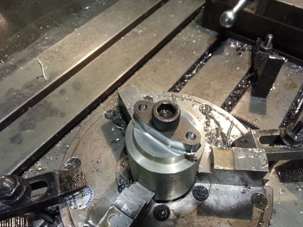

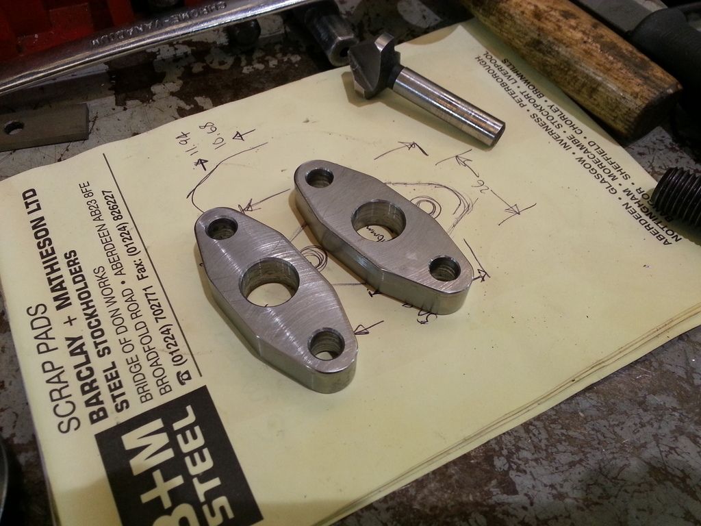

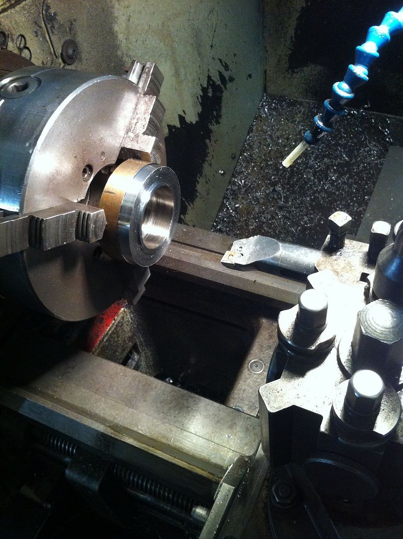

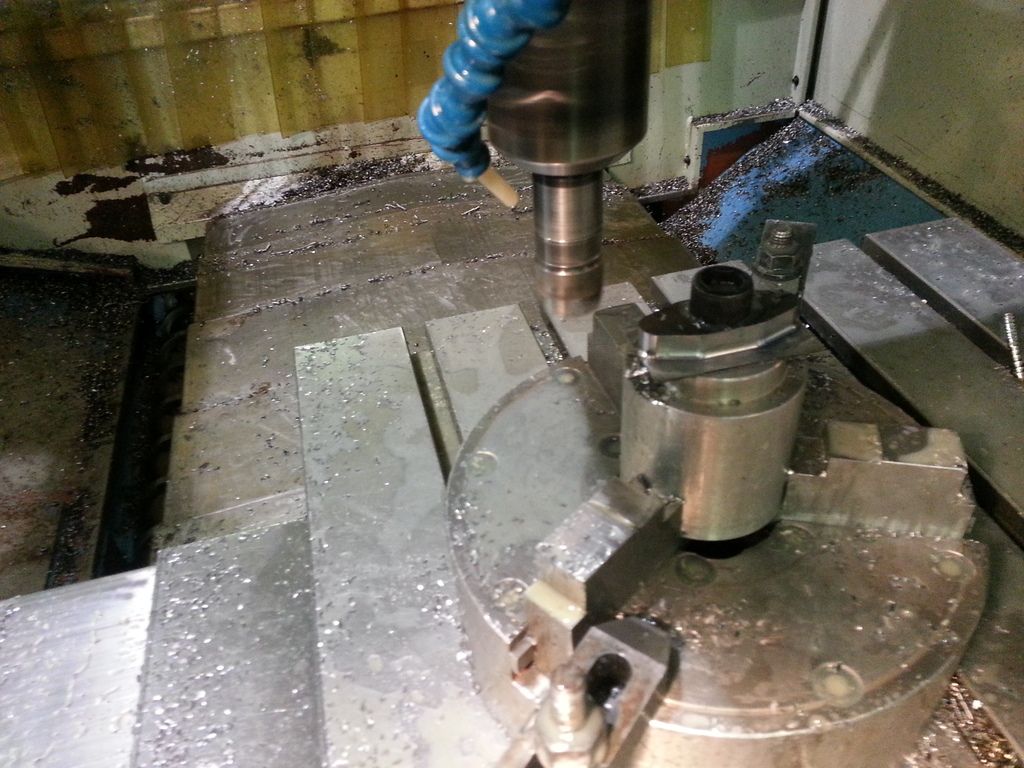

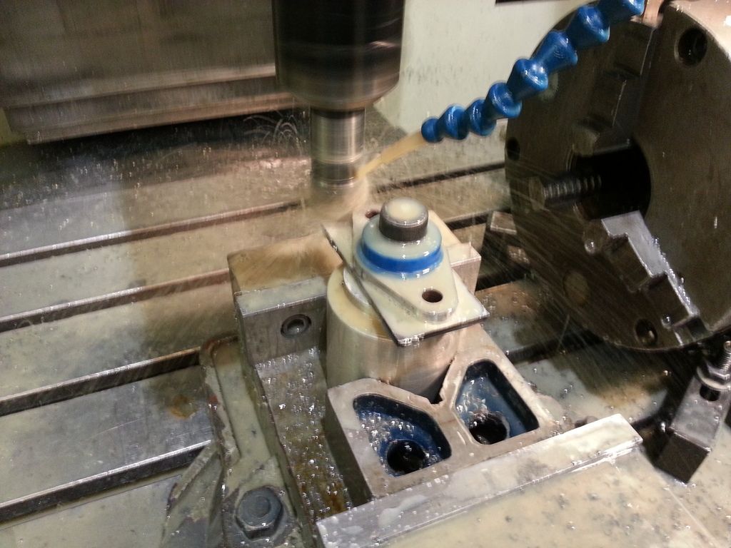

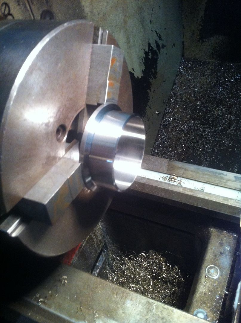

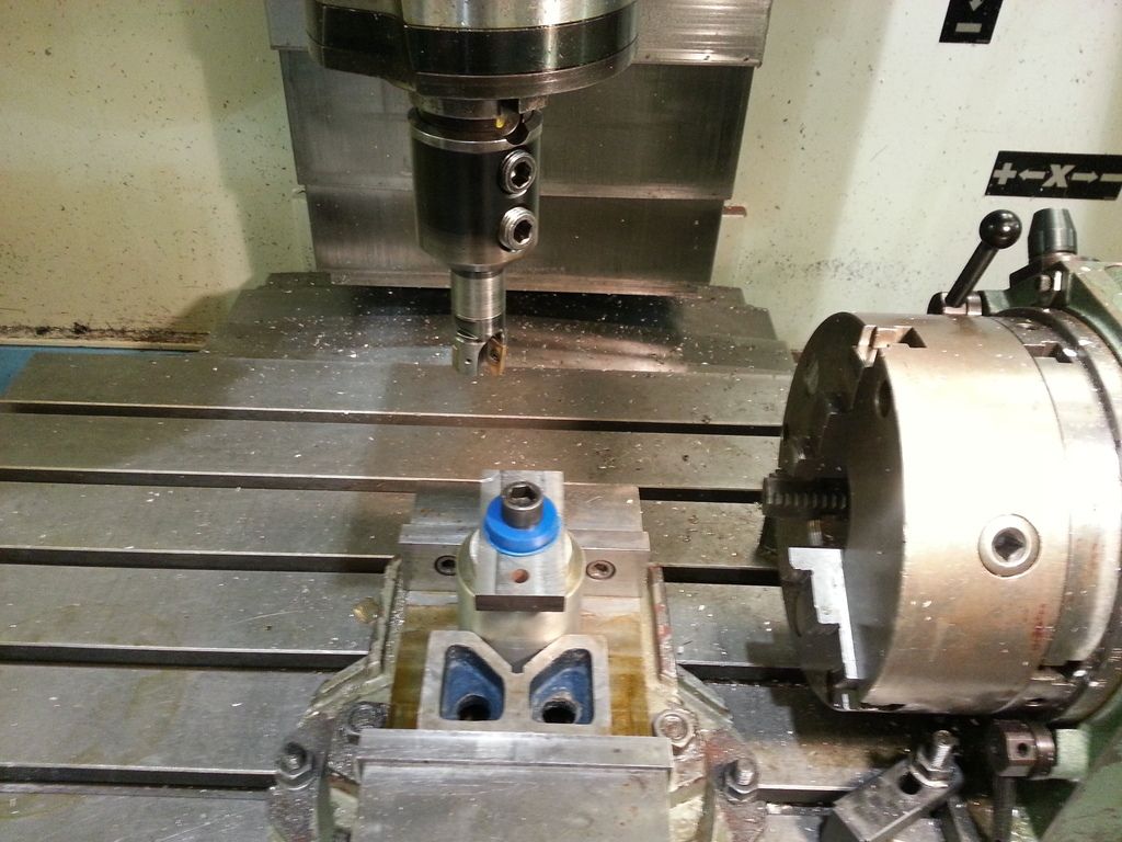

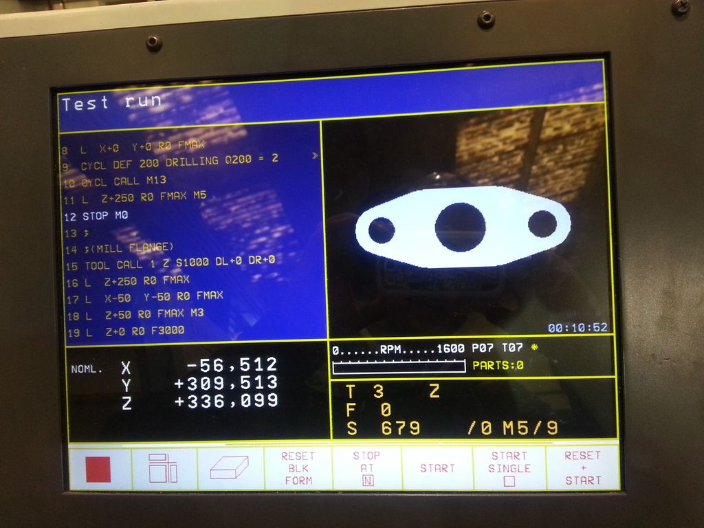

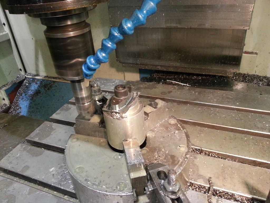

Machined up a couple oil return and external wastegate flanges.

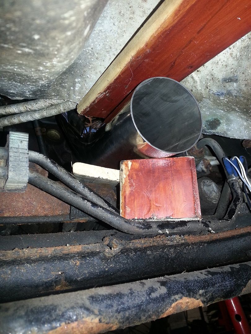

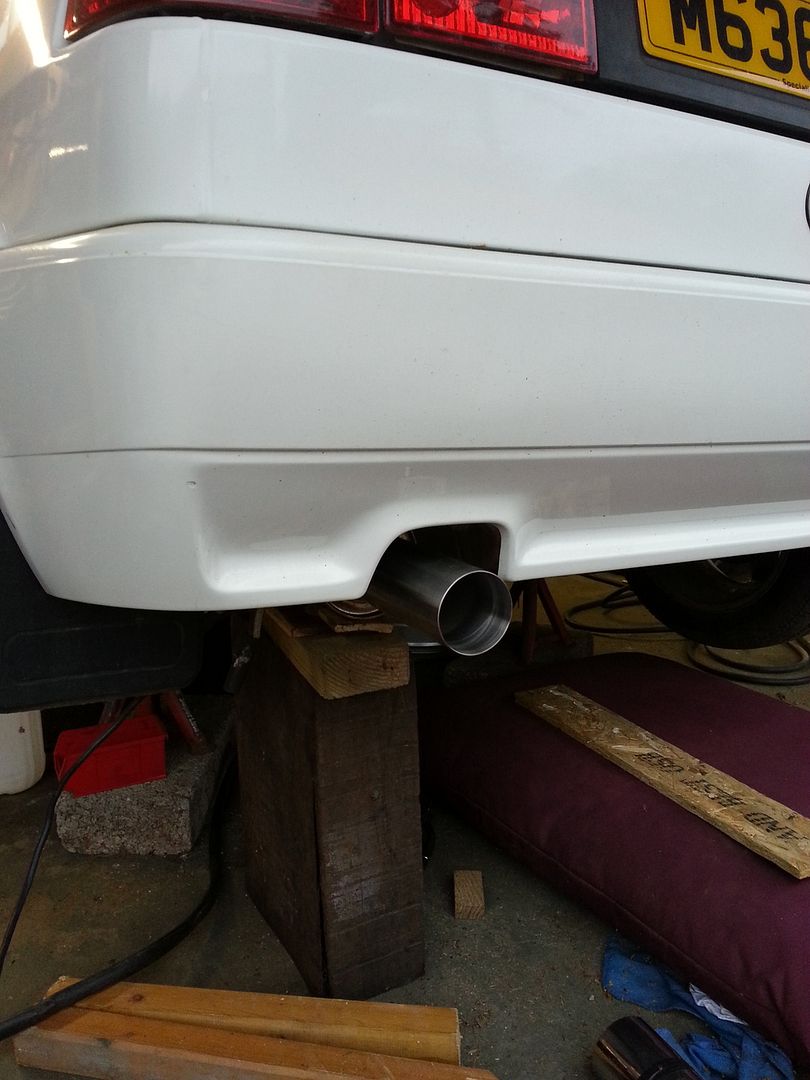

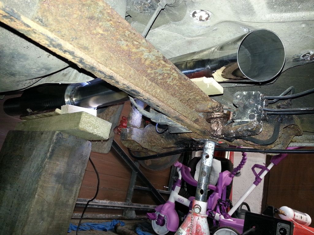

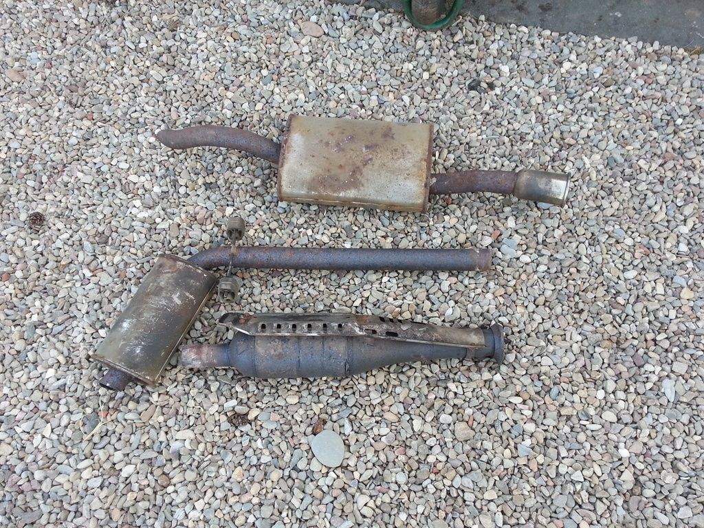

Bought 3 meter length's of 3 inch stainless exhaust pipe from eBay. Also orderd two 90 bends, one a tight, and six 45 bends. I found that was maybe a bit excessive. Also bought 3" v-clamps and flanges, a joiner and clamp, and a 4" long flexible.

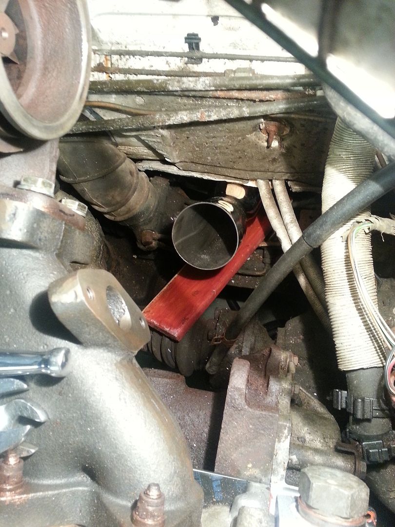

I then started mocking and tacking up the downpipe.

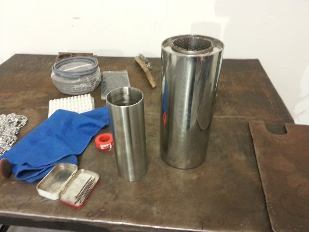

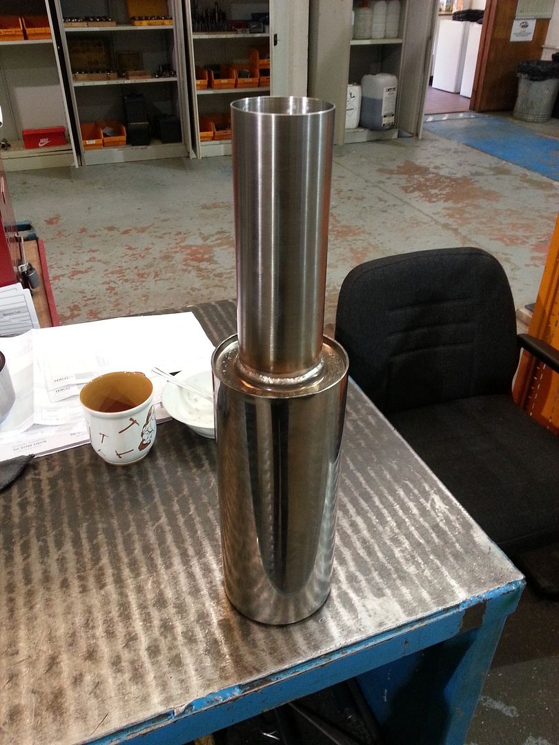

Fabricated together the backbox using a 5" silencer and some of the 3" straight pipe.

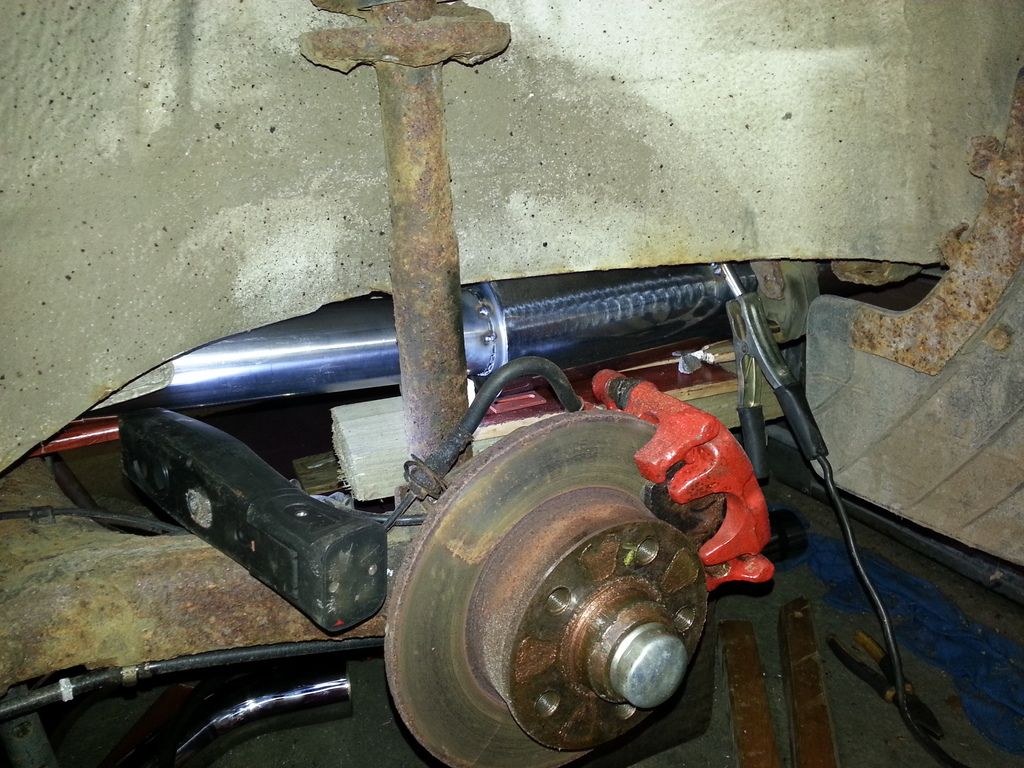

Mocked up and tacked the rear section.
Things really start to tighten up when using 3" stuff 😁

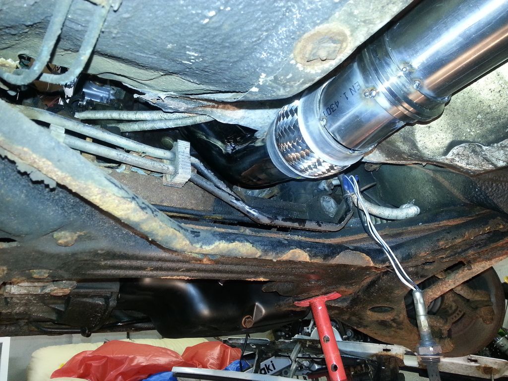

When clearing the rear beam you only need a fingers width between pipe and exhaust heat shield. Too big a gap and the beam will knock once it's back on the ground..... well it does on mine and I'm only running 2.5 inch system!
Some great work going on here. Wish I had the skill/tools to undertake such a project.
Cheers. Yeah its not so bad as it goes over right at the pivot point of the rear beam. I've tried my best to keep it away. Is your car lowered?
Yeah mines about 60mm lowered, maybe a touch more. I realigned mine the other day, and to be fair I'm not sure I could fit a 3 inch pipe through there!
my VR is lowered, such that there is a 2 finger gap between top of tire & the wheel arch
it has a 2.5" longlife stainless & Paul who fitted it said it was a challenge due to the ride height - he did an awesome job though & ive not heard single knock from it
