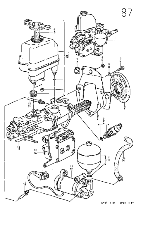

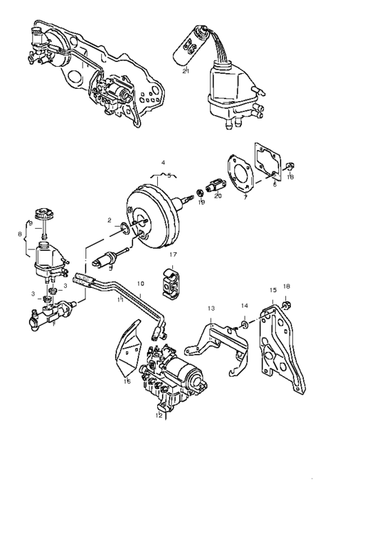

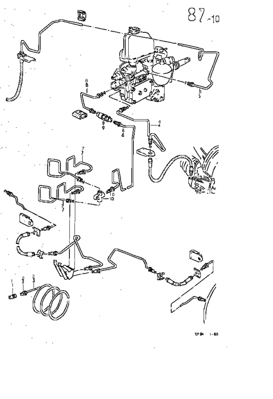

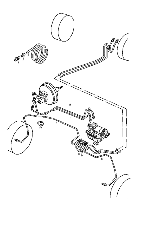

Got these from vagcat, i had them all downloaded on pc already for some reason
Might be worth a double check as i've not looked at them 100% properly
They're very helpful mate - thanks.

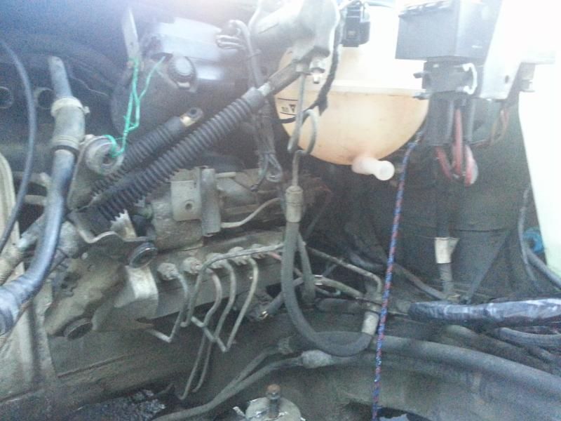

The VR6 has 6 ports out of the front of the ABS pump and 1 has a bigger connection nut.
Yeah, just checked old photos and you are correct, not sure what the diagram i posted is showing then.. Confusing

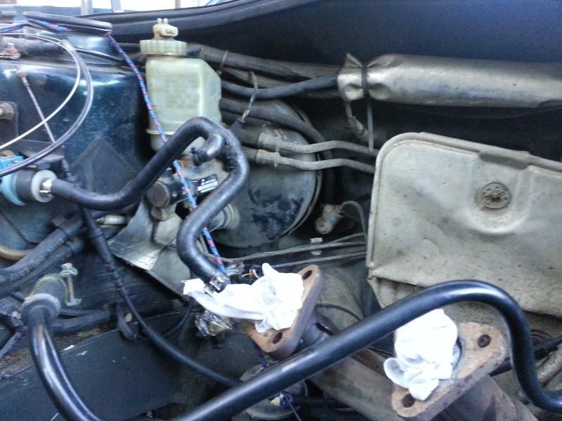

Some of my old pics, not sure if they help at all?
