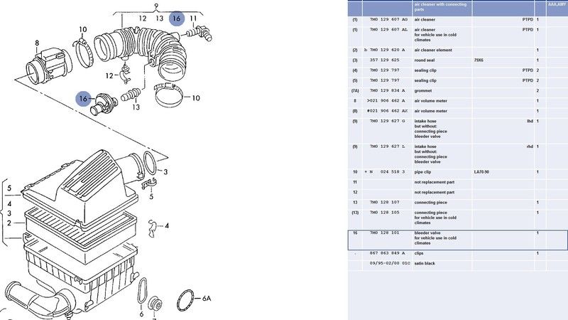

Yea, you can get the part from Ford - I got mine there a while ago - However after playing around in vw's parts catalouge VW actually DO have this part as a standalone - but they have to look in in the Sharan - so might still be available:
Part number: 7M0 128 101
(I don't think there should be any differences to this one):
