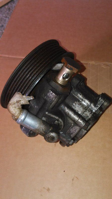

Thanks for the PM (didn't see it before today) - a bit hard to see the lower connection - I would presume it differs from this one:
This is the one out of my 1991 Passat VR6 - I think my Corrado have the lower pipe bending the other way around...........
Tje lhd has the outlet like the one on rhd cars but seems to no have the outlet pipe for some reason. On the pic I send the outlet position is where the red is
Ok,
anyone got any idea if this connection can be turned the other way ? (unscrew it somehow or is it part of pump ?)
