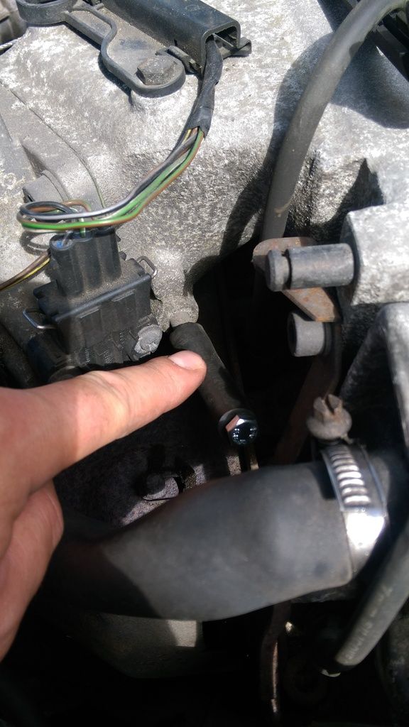

Couple of issues, firstly, I have noticed a breather pipe coming from the back of the inlet manifold by the throttle body. It has ben blanked off with a bolt. What is it for, and where should it go? When I removed the bolt, the engine revs drops and the splutters then dies

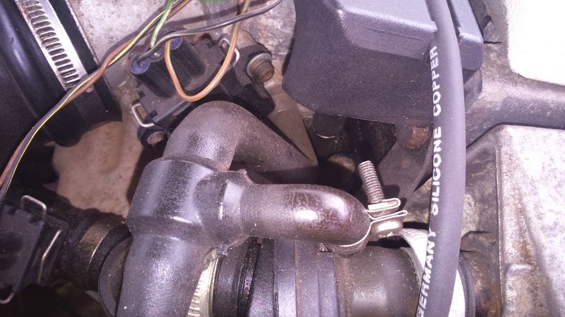

It connects to the pcv valve via t as seen on my pic and then continues on to the carbon canister located under the airbox. I see your pcv has been removed.
I'm removing mine the moment. I was going to connect that inlet pipe to the blue valve mounted on the suspension arch turret.
Is your carbon cannister etc all still there?
It's a common enough deletion if done properly from what I've read- but maybe others here can comment, some may even have it done on their cars. Mine is still original. The PCV/activated charcoal/carbon cannister system all seems to be emissions related. You may have a vacuum leak causing erratic idle. It's easy enough to test with a pressure gauge.
