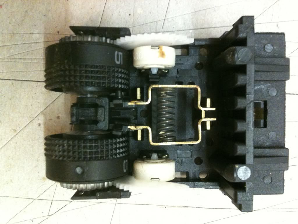

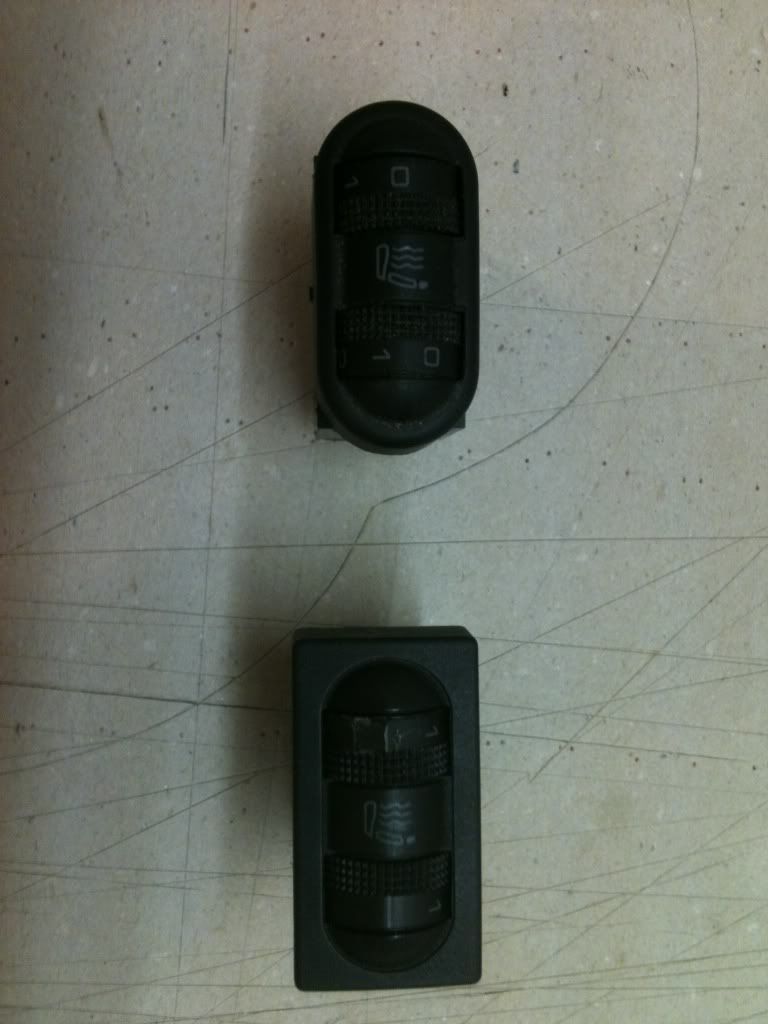

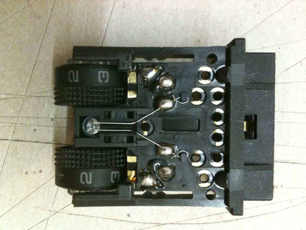

easypops 8 Posted August 1, 2016 The switch from a sharan/galaxy will work and will fit, it's just not quite the correct shape as the Corrado one. I got one and swapped the internals into my switch as my ones dials were delaminating . Plus they are usually much cheaper than a Corrado one Quote Share this post Link to post Share on other sites

easypops 8 Posted August 2, 2016 Is this the correct one, it looks very similar to the corrado one albeit with no surround. http://www.ebay.co.uk/itm/HEATED-SEATS-SWITCH-1998-MK1-FORD-GALAXY-/151840636182?hash=item235a683d16:g:R2QAAOSwMmBV6~-o Yes, and although it looks like there is no surround, the circular bits at the side are the surround. It must fit into that shape hole in a sharan where as the Corrado hole is a rectangle. I have pictures somewhere of when I did the outer casing swap, I'll see if I can find them Quote Share this post Link to post Share on other sites
easypops 8 Posted August 2, 2016 Really poor photos, I thought they were ok Can't remember which is which, but as far as I recall, the dials on the sharan one wind the opposite way, but work just fine Quote Share this post Link to post Share on other sites
culshaw 1 Posted August 2, 2016 Thanks for this, I really appreciate it. Next to find a surround to butcher! Quote Share this post Link to post Share on other sites
