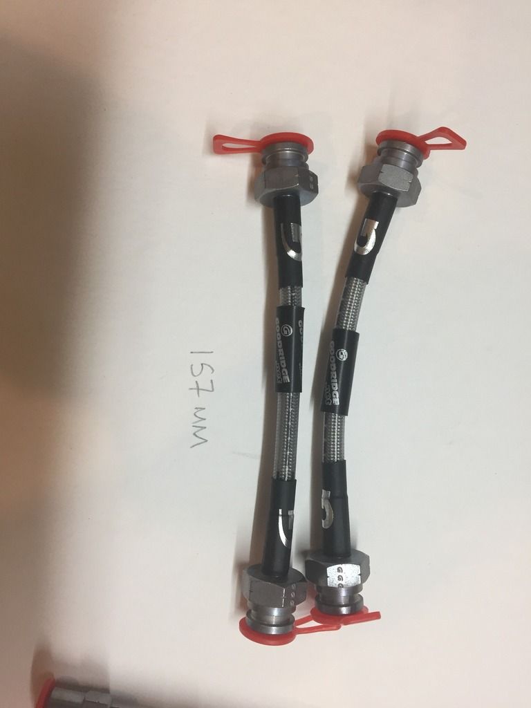

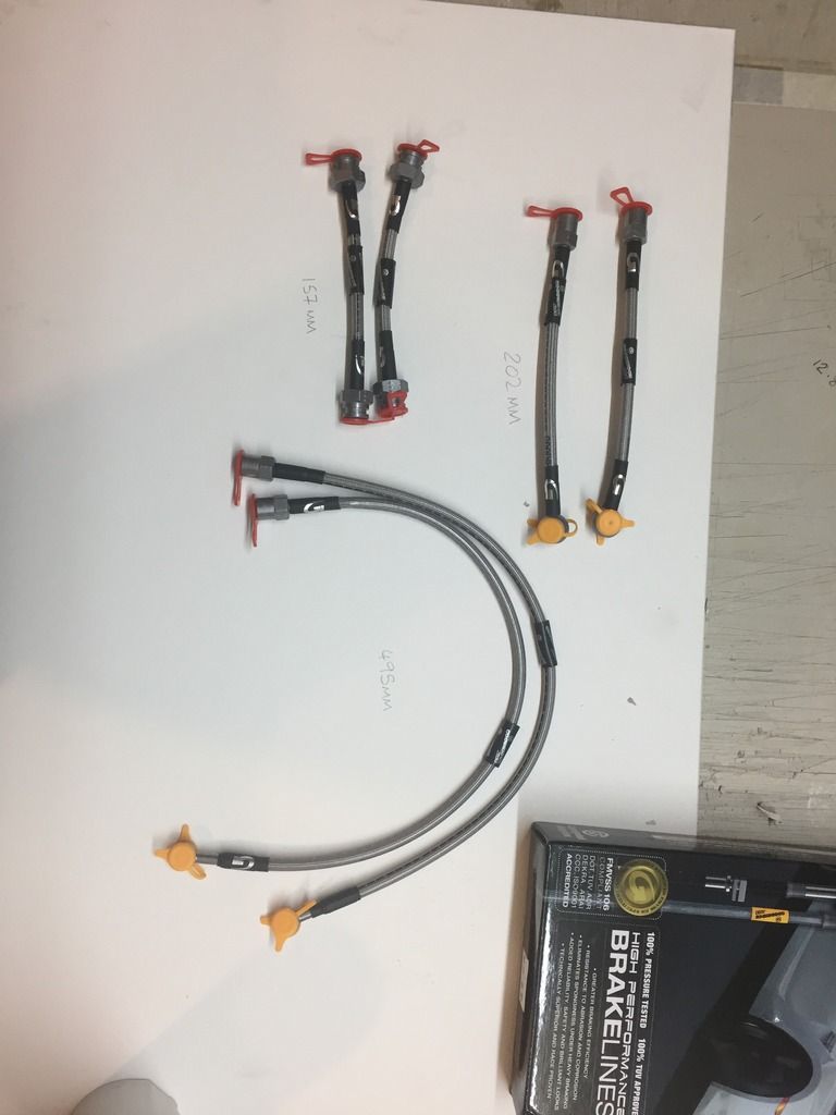

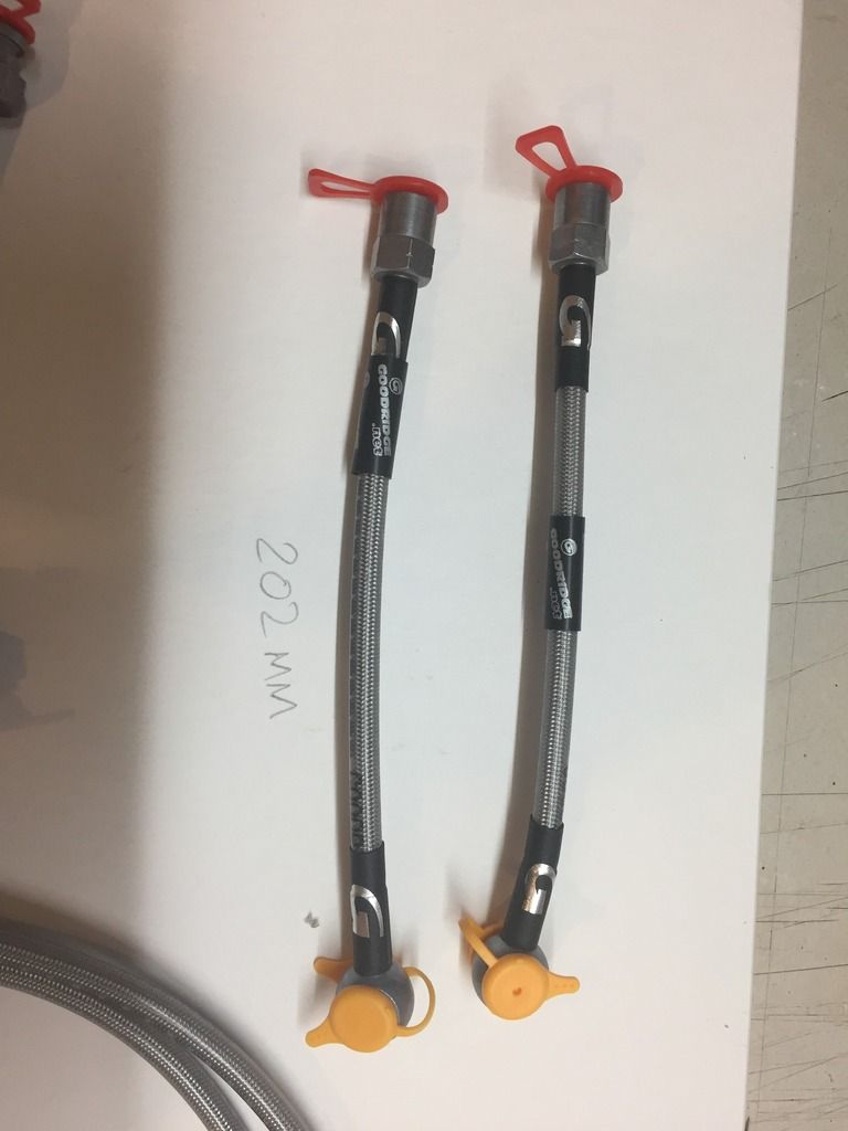

I have a set for this setup from Goodrich still in the box, I'll dig them out later on and get you some pictures and sizes

Ah, forgot all about this, I'll do it once I get home.......unless I forget again :lol:
