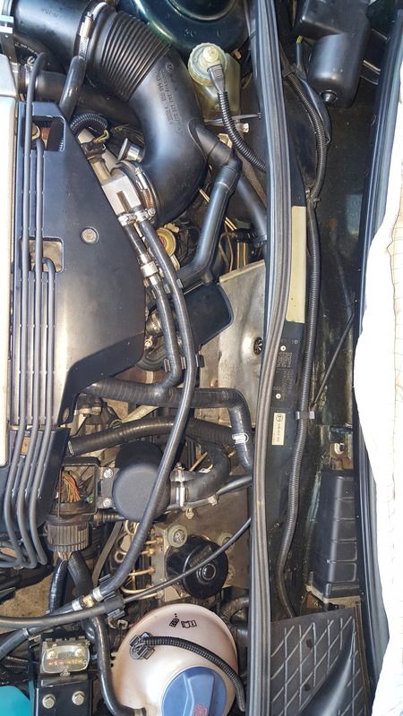

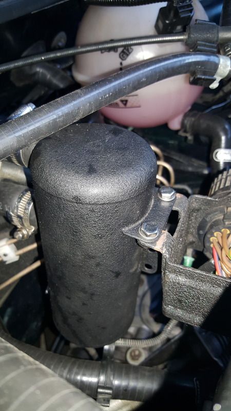

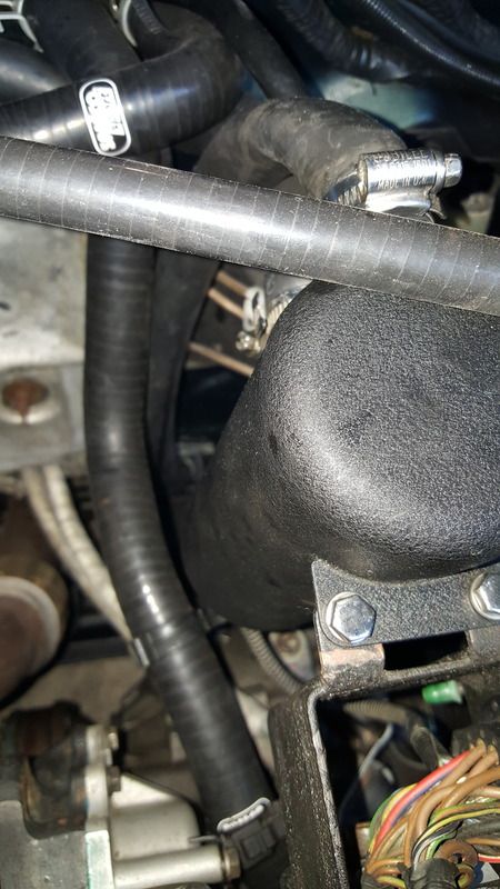

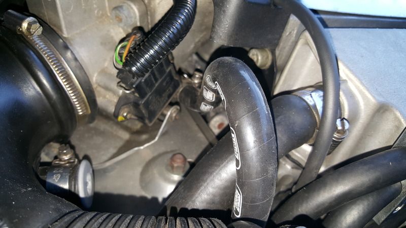

Jim Bowen 1 Posted May 8, 2017 Its the small vac pipe bit that's hard to get hold of. Mine just perished so got rid of it. I'd fit a catch can instead tbh. Stops all the oil going into throttle body and inlet. Quote Share this post Link to post Share on other sites
cmck32 10 Posted May 8, 2017 Can u show me pics of urs?? Jus to give me an idea Sent from my iPhone using Tapatalk Quote Share this post Link to post Share on other sites
Jim Bowen 1 Posted May 8, 2017 Yeah can do it now. Just about to go out to garage. Quote Share this post Link to post Share on other sites
cmck32 10 Posted May 8, 2017 Cheers Sent from my iPhone using Tapatalk Quote Share this post Link to post Share on other sites
Jim Bowen 1 Posted May 8, 2017 So i have the inlet elbow blanked off and the pipe from the blue valve to the throttle body (same as yours) The pipe from cam cover runs along the bulkhead and to a catch can mounted near the aux water pump Hard to see but the catch then has a breather hose which i've run down to the steering rack, has a small filter on the end. Quote Share this post Link to post Share on other sites
