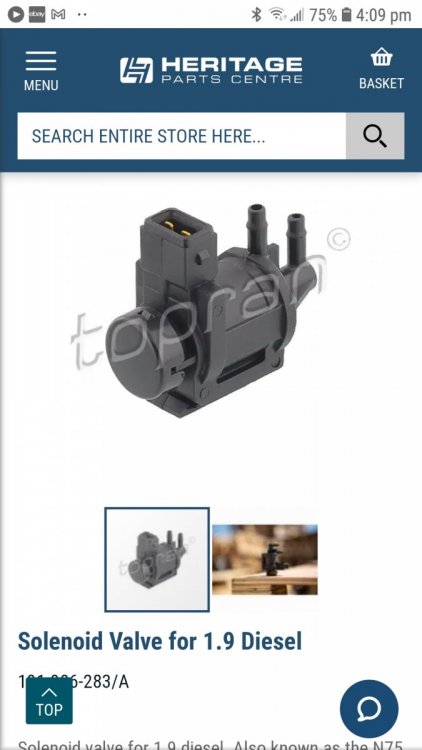

Cress does that one work on my one has part number 191806283A (golf 191)
They would all work as basically the switch operates allowing the vacuum through. Just used your part number and vw heritage have the exact one and exactly the same as mine. Keep building up your spares 😇
ooops my bad thought the 9 was an 8 = no need to worry about that part then its the same part for a Mk7 transit egr valve .
