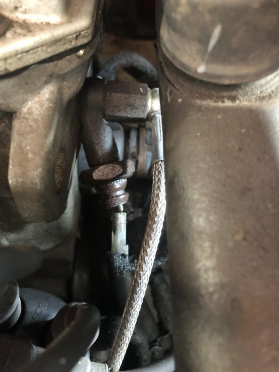

does anyone know the part number for the following oil pressure sensor
it is located on the braided charger line at cylinder head
cannot find it on etka and vw dealer cannot find it either - its brown in colour
my own has decided to ooze oil

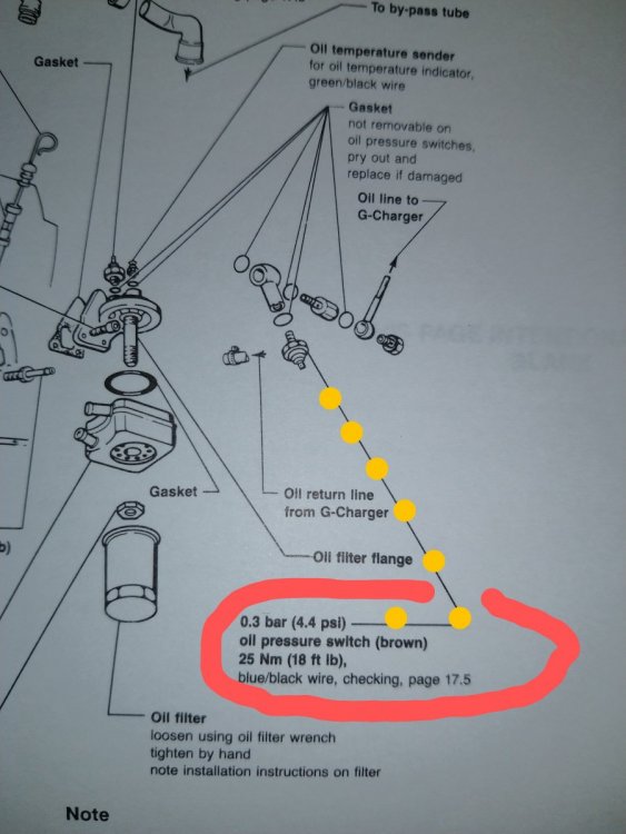

  On 11/10/2020 at 6:47 PM, ger040 said:
Thanks Si,
That's a great help
No worries.
According to the Bentley manual the torque setting for the oil pressure switches is 25 Nm (18 ft Ib)
Photo image from the Bentley manual attached below.
Si
