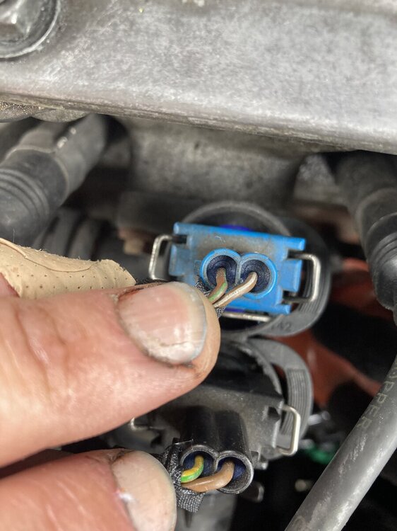

Blue and Black temp sensors:
I have 4 wires (plugs missing atm) which don't seem to match bentley:
Brown, white/brown, brown/green, yellow/green

The one shown loose does not connect to anything it left the factory tidy like that just leave wrapped up in loom .  Seen this on a few g60 all the same- I will get the other bits for you .

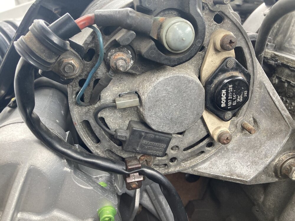

> Have a blue cable with single plug which I understand to be the 'alternator excitor wire' - where does this connect? (image attached)

54 minutes ago, Stone0311 said:
Couple of others if you know:
> Have a stray brown/white loomed up with the o2 pot sensor?
