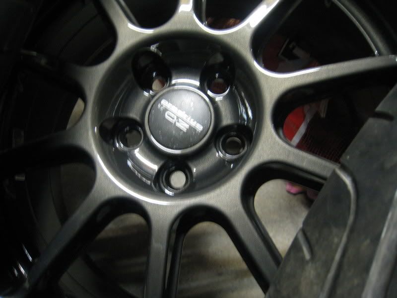

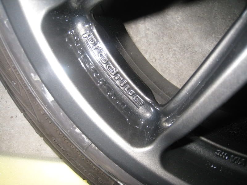

wheels should be back from the refurbishers on monday, the toad ai606 alarm i am waiting for should be arriving today i hope, the porsche brakes are getting machined on monday so should be ready to go on soonish aswell.
Just got the rest of the bodywork to sort out, and refit the interior and i am in business!
no they are 7*17"s, with normal 205/40/17 rubber on them. shouldn't have any rubbing problems, especially as i am not dropping the car on its arse.
4motion wheels will be getting sold as soon as it comes back from the bodyshop. You interested like?
