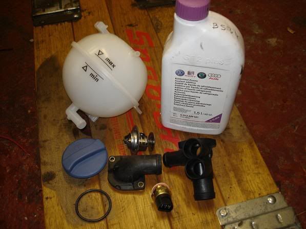

This afternoon i changed the thermostat and the flange, flange on front of head, fan switch, expansion tank with cap and G12.

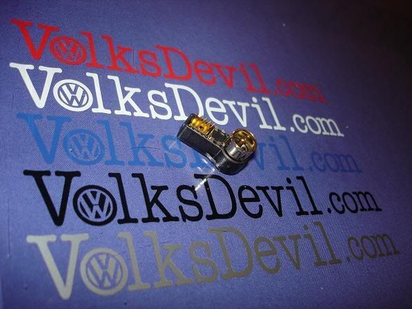

New oe style but gold plated aerial connector.

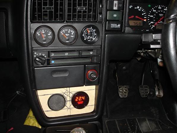

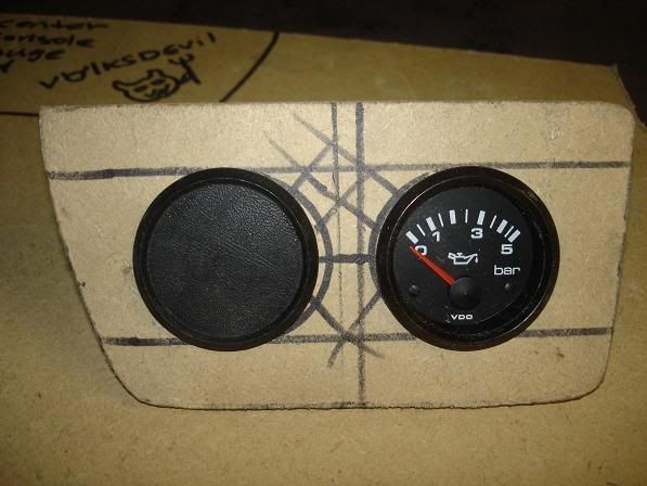

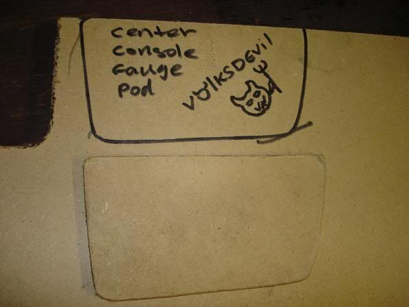

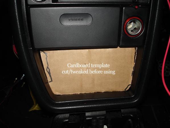

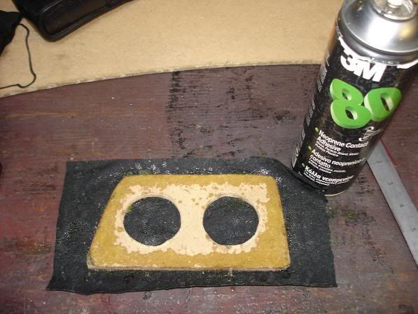

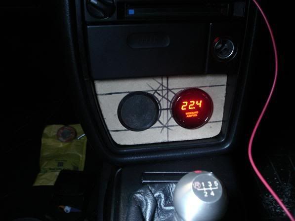

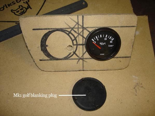

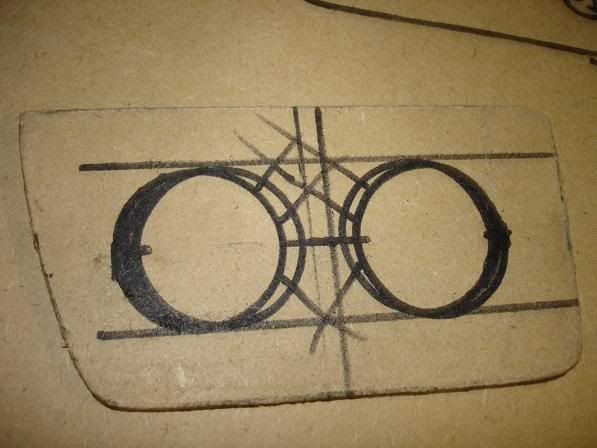

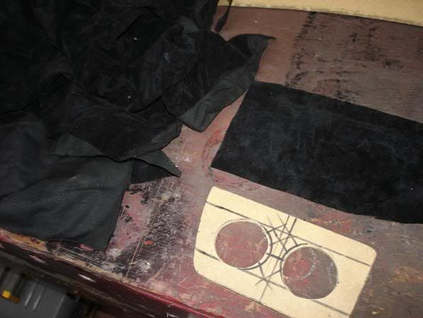

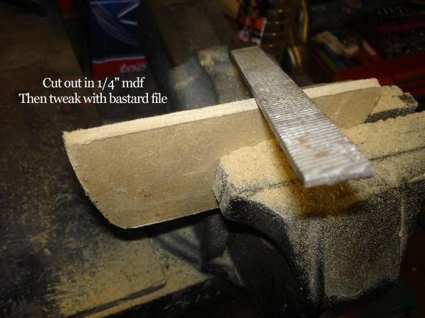

Since ive run out of money, and having an extra gauge to mount (the afr/wideband gauge) i made up a center console gauge pod, people pay crazy money for these things for the corrado's
In this pic you can just see the push button for the wideband, i later moved this obviously...see pics
I drew round the first one again incase i fecked it up.

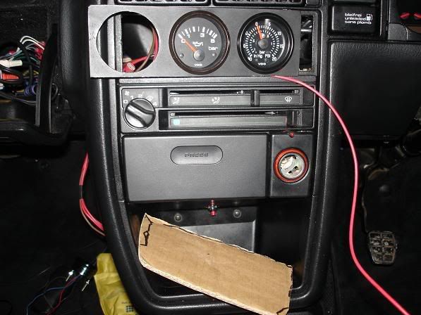

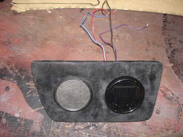

1 Gauge mounted, and a mk1 golf blanking plug came in handy.

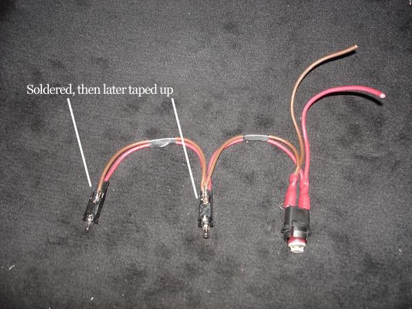

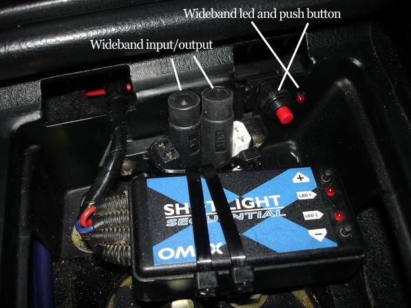

I then mounted the wideband calibration button and led under the gear gaitor along with the plugs/shift light jobby.
Finally made a lighting loom up for the 3 vdo gauges where the stereo used to be.
All mounted up, pleased with sommet for once.

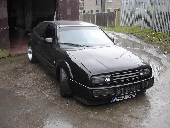

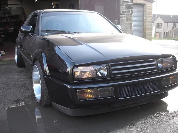

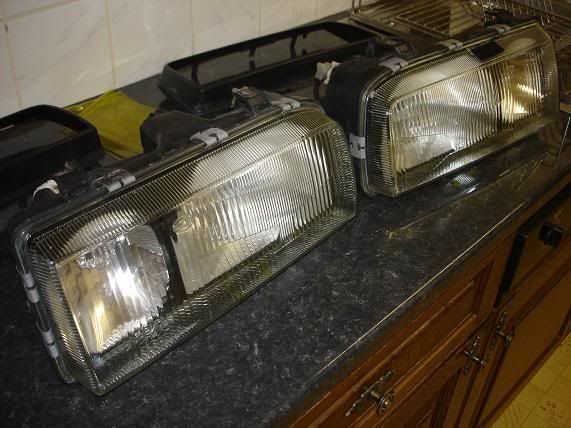

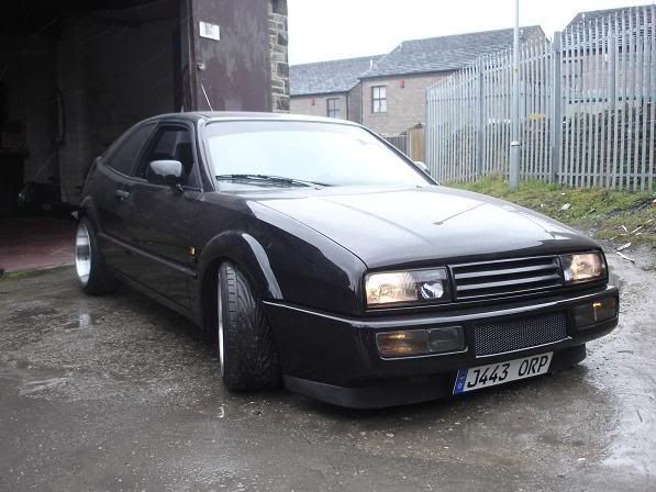

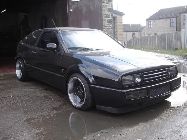

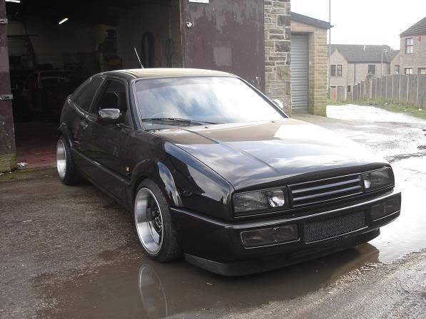

Also decided on a change...You may have seen that in the video, the yellow headlights have gone.
The headlights are obviously as mint as they were before the Lamin-X was applied!
New SubtleTint applied to one...
Both done.
Excuse the absolute filth!!!
Cheers lads...but people are supppoed to say i should have kept the yellow :( :lol:
Phil, a single piece of 12"x16" will protect/cover the faces of both headlights mate, £15.99+p+p 8)

I don't have time to paint or cover with ally then paint the gauge pod...so i used some black suede type sh|t for now...

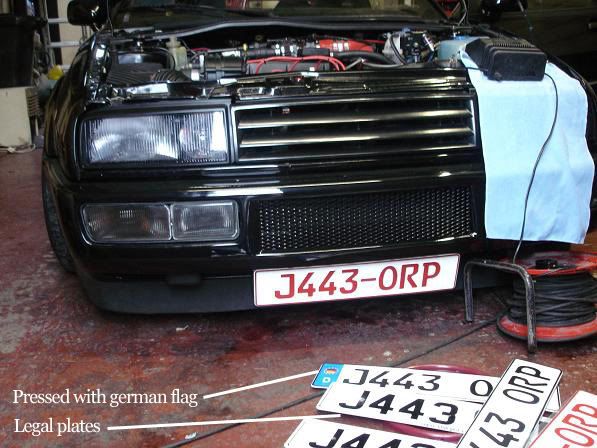

Also forgot that ill be needing a front plate for the mot! Not gonna run one otherwise i don't think.
Mounted on the mk1 golf plate holder...Red font and many others to choose from :lol:

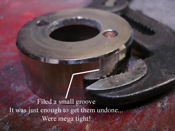

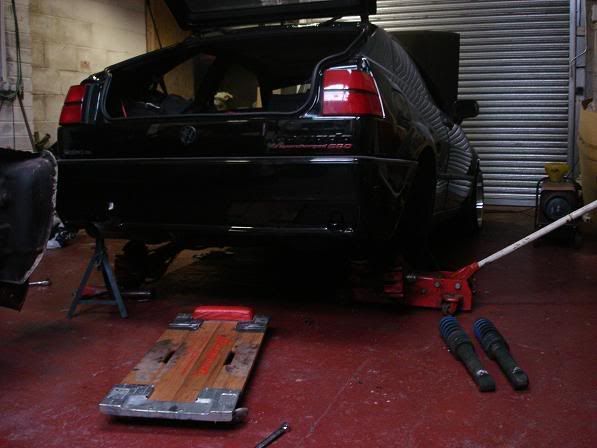

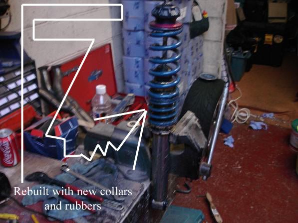

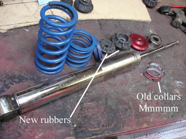

Got around to removing/dismantling the rear coilovers to fit new collars...As you can see, just like the fronts i recently did they are still generally in good order apart from the original collars which again literally fell off in bits.
The caps were MEGA tight compared to the fronts, i had to resort to filing a small groove for the adjustable grips to get a hold.
Rebuilt/Greased to death again and then refitted, i also removed the silly camber shims. Shame i got all the brakes/disc/wheel bearing back on before realising id forgotten to fit the back plates! Idiot!

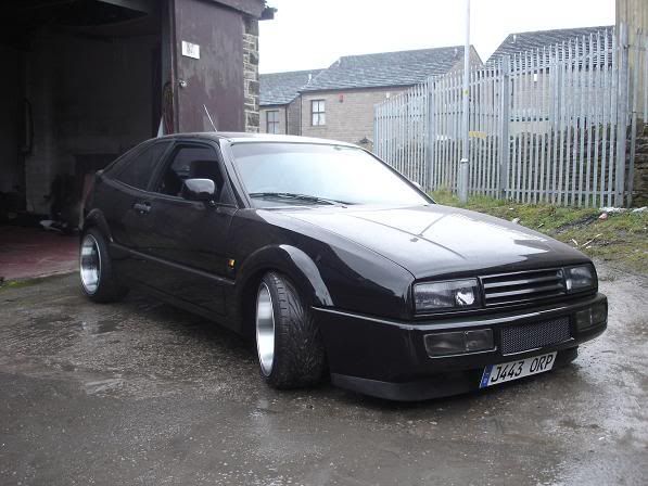

Its back home! :D
Mot time tommorow!
It seems to drive alright, nice and tight with the new wishbones/bushes/track rods/ball joints/top mounts etc etc Just needs the tracking/camber tweaking.
Im just really wary of it having done so much work on it over the past god knows how long...
Sidelights on.
Low beam.
