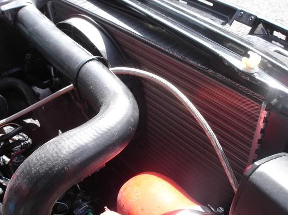

New radiator fitted.

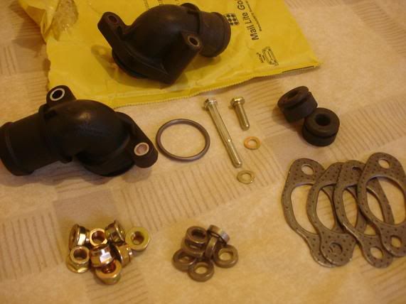

Still need a new radiator elbow etc before i can finally stick (some more!!!) coolant in as the original one had snapped/seized bolts (ive replaced it before) and a spare ive put on has broken on the end. Which means the helpfull dealers...
Temp cable tie on the charger oil feed as the radiator is slightly diffarent.
535 121 647 - elbow.
535 121 687 - seal.
N010 3664 - long bolt.
N0102228 - short bolt.
N010 2265 - 2X washers.
535 121 275 2X rubbers.
Does this look like £55 quids worth to anyone else? :(
New radiator elbow.
Elbow seal.
2x elbow bolts and spring washers.
2x Radiator mounting rubbers. (one was split)
8x Zaust manifold copper squash nuts.
8x Washers for the above.
4x Zaust manifold gaskets.
Got the radiator elbow/bolts on and finally got to flush the coolant (again) and fill up with a g12+ mix.
The zaust stuff is for when i possibly fit the 4 branch, i fitted all new zuast studs/nuts/washers when i had the head off, but thought best to replace em again minus the studs hopefully.

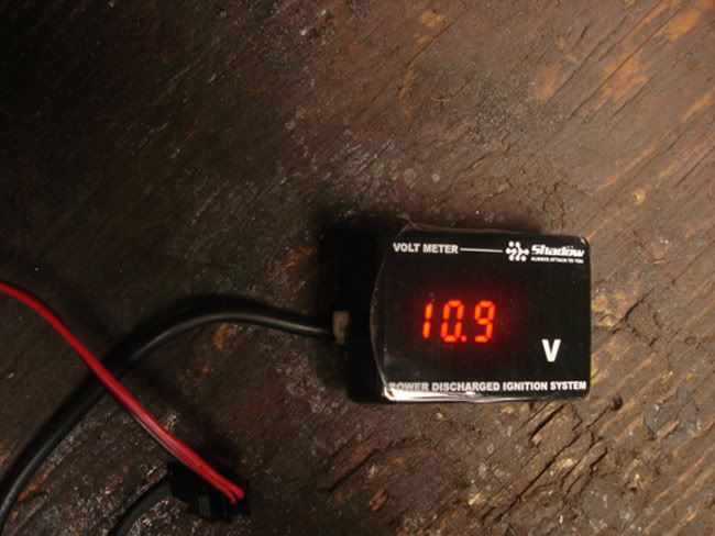

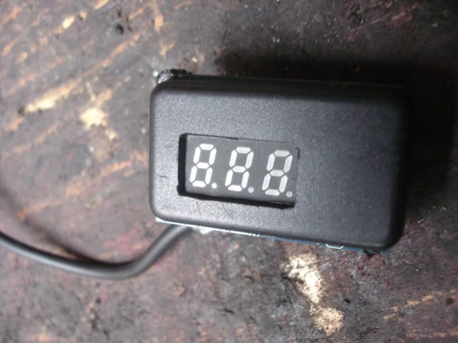

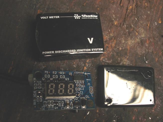

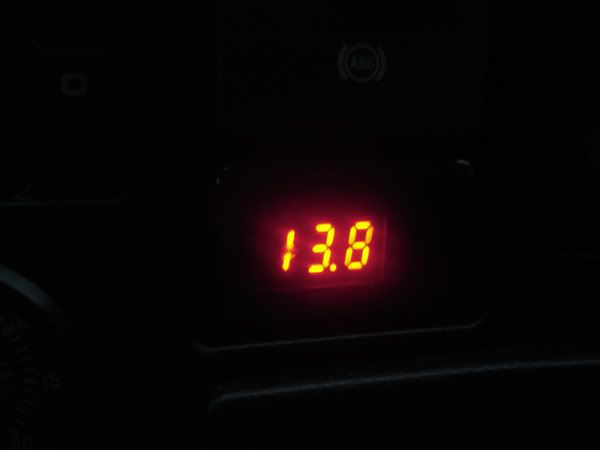

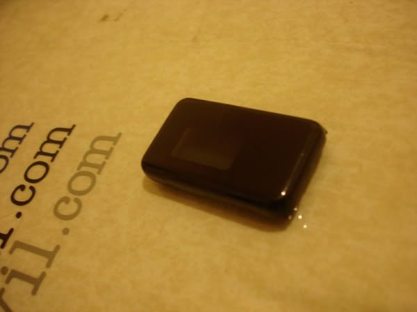

Bought this digital voltage gauge as i may end up doing away with the VDO one in the dash.

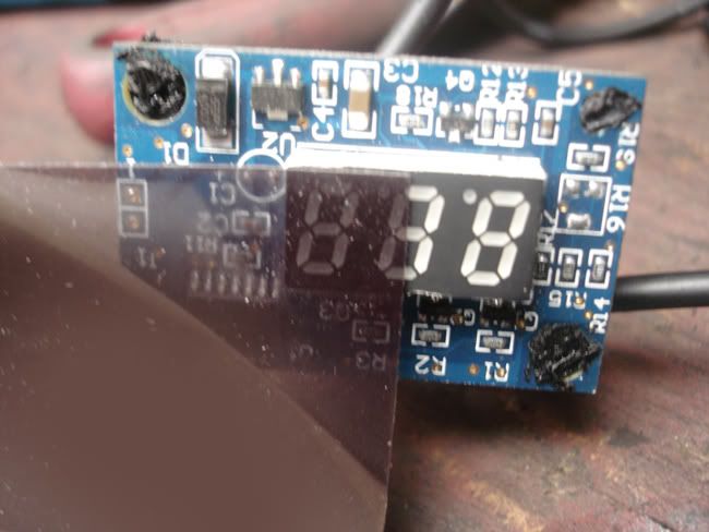

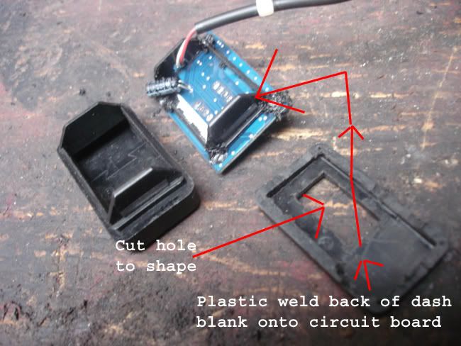

Nowhere for it to go without looking like an 'add on' type thing, so split the box open.
I bet ya know whats coming next? lol

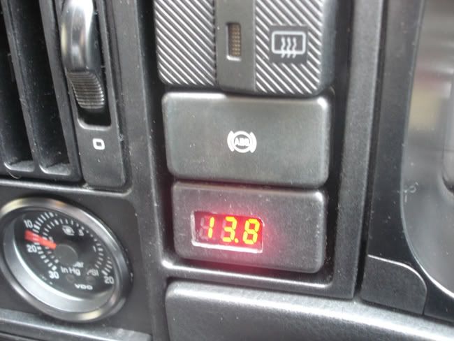

Take a dash blank and chop the back pegs off, and cut a hole in it. Plastic weld the pegs from the dash blank onto/through the circuit board.
I forgot that the box it was in provided a sort of blank for the non lit digits, so i stuck some Lamin-X over the face. You can see the effect.
Fitted!
Its off center because i haven't finished it yet, needs tidying around the edges and i have another idea for it. When lit, it looks a lot more black/red than it does in the pics.
Wasn't happy with the 'obvious' cut out in the digi voltage gauge i made, so wrapped it in some GunSmoke Lamin-X to give it a glossy, more finished/standard look.

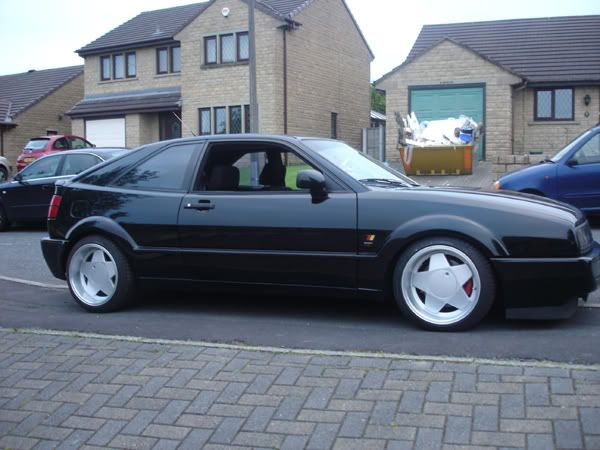

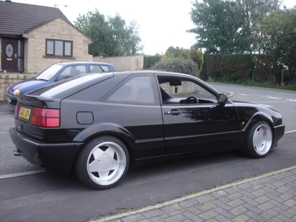

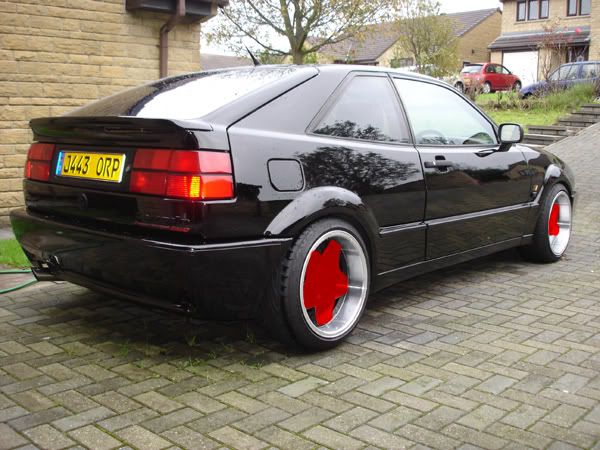

Ive also just bought two more 9x16 Borbet A's... :?
Just bought two more 9x16 borbets...Just because they were the right money with the same size tyres as im currently running. 215/40's.
Was planning on either going red centers, or black centers with red dishes and run them on one side of the car. But after fitting them, i think im gonna leave em as they are and look for another two.
And fitted, looks totally diffarent to how i imagined. Maybe i should have never painted the new ones i bought!?
Poor photoshops of what i was going to do...
I like the standard wheel colour fella, car looks really mean and I think the red spoils the look.
Love the car though.
Rich.
yea i agree, i like what you have done with the black centres but there is something about the all silver wheels which is very cool :D
Awesome car! I think the wheels look mint as they are. red on dark Cs is nice in little bits- badges, lights, calipers, but too much spoils it!
hi i like the black centres on the wheels very nice C you have
fitted some subtle tint on the headlamps very happy
wood like some red 4 the back lamps :grin:
Cheers lads...The corrado is back on the 4 borbets that i painted black now while i look for another two original/silver ones. Still undecided which i prefer tbh.

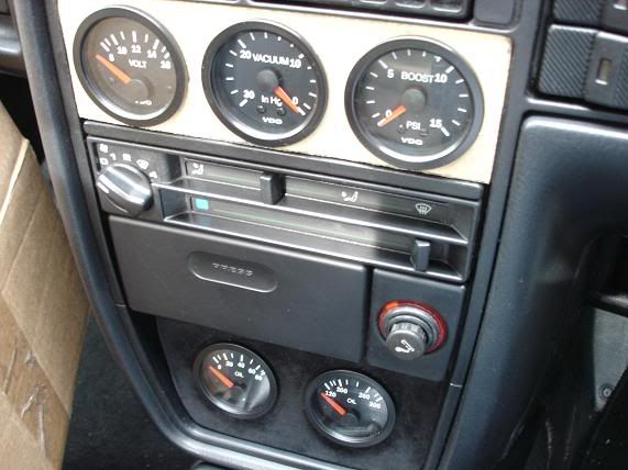

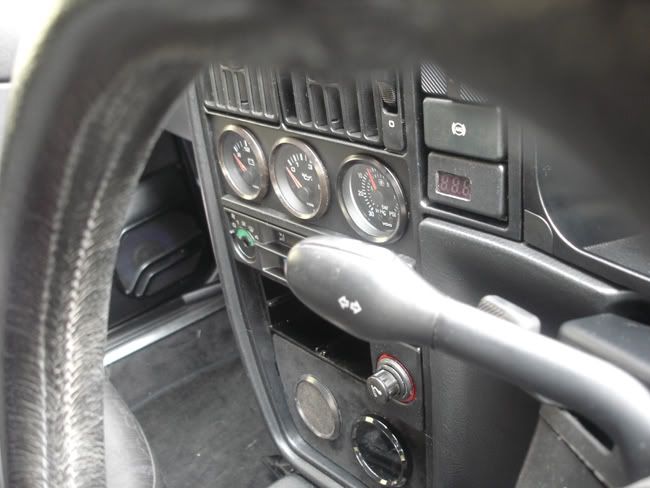

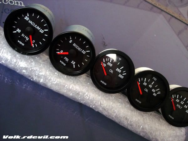

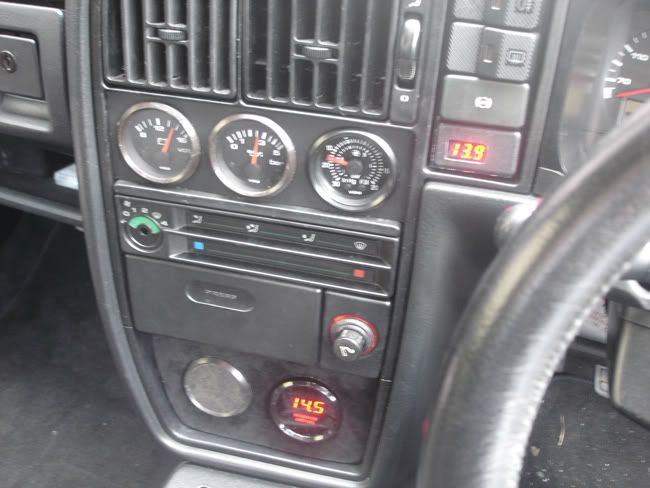

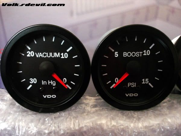

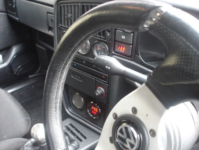

Not much happened lately really. But ive been collecting brand new vdo gauges for a while to replace the ones i currently have.
Still awaiting finding an intake temp gauge, and need an a-pillar pod to mount the afr/lambda gauge as it now has no place in the dash.
Ive gone for a diffarent route as far as boost, using both vac and boost which looks great as one needle rises to zero then the boost shoots up. Its just more accurate imo.

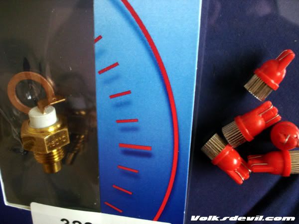

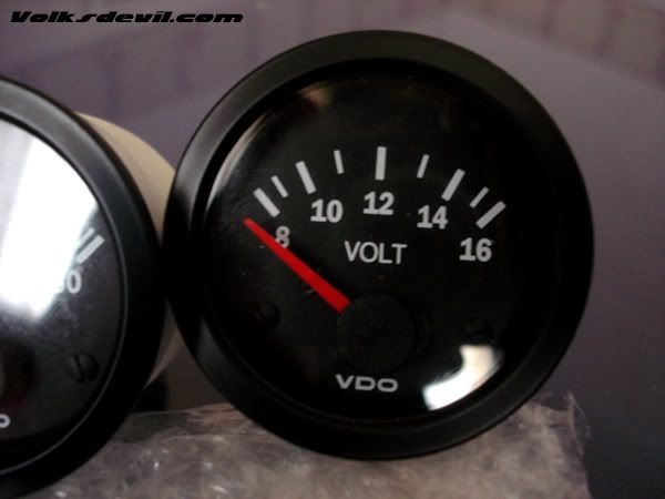

The collection so far:
Vac, Boost, oil temp, oil pressure, volts. Along with sump plug oil temp sender and red led bulbs.
Then i made a new panel out of 1/4" as the one i made previously from ally plate was a bit too thin.
Then fitted all the new gauges, bottom gauge pod was one i made previously.
Retrimmed it to match the lower one.

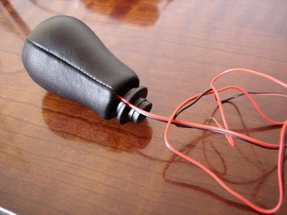

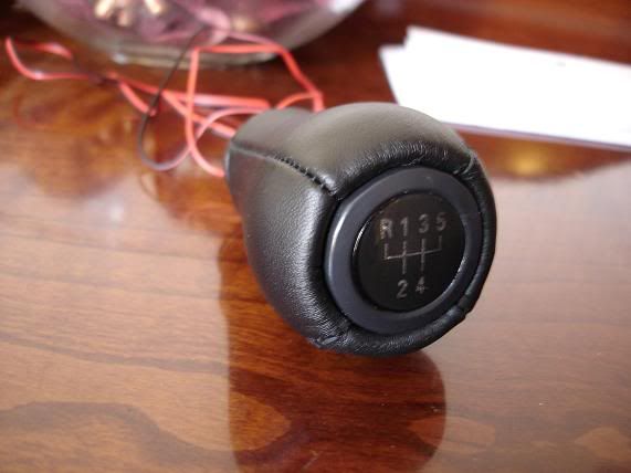

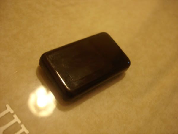

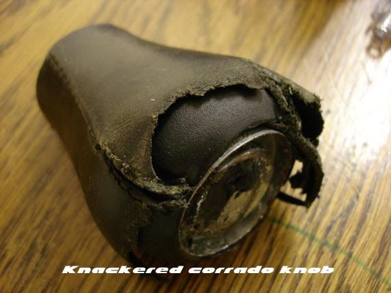

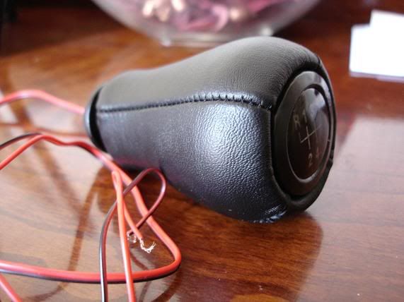

Spare knackered corrado gear knob.

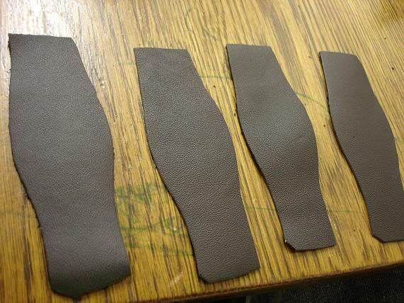

Some new leather cut out and sewn together.

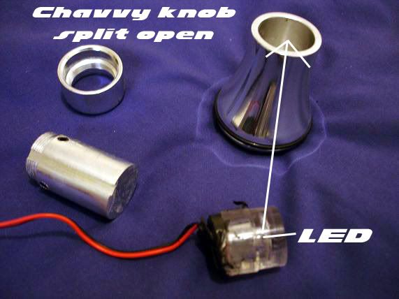

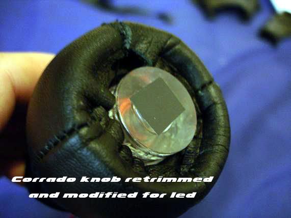

Won a chavvy red led gear knob on ebay for 99p! And stripped it of the good bit
Drilled it out and fitted the led part from chavvy one, and recovered in the new leather.
Spent some time modifying the top but didn't manage pics.
All Fitted. Although i never knew the threaded part was damaged so its no good. Ill modify another...
All the red looks much more red in real life, like the only pic i could manage to show it below.
Crap video of the vac/boost.
Superb work, looks really good, something really cool about loads of gauges...........think I need some.
Rich
Cheers mate 8)
Ive still got more yet, just don't have the room for them :lol: Gonna have to decide on which ones to use!
Can I ask where you bought the gauges from?, look really 8) and VDO stays with the OEM theme.
TIA
Rich
Yet again Riley... :notworthy:
Watched the video a few times and its still 8)
