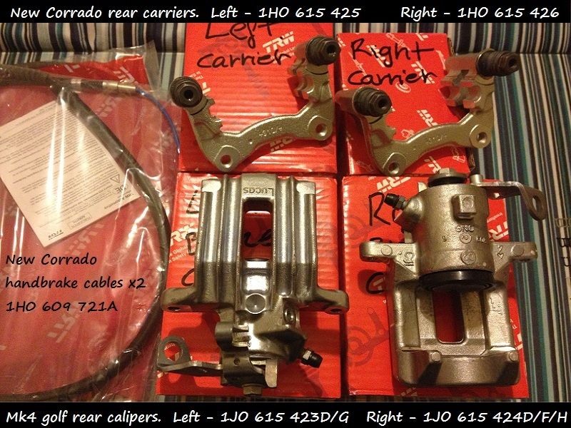

Riley 0 Posted October 25, 2012 Haha I do keep getting asked about them, but I'll probably keep them as a half decent second set once the A's are sorted. Have hit a small hurdle with the car (Knackered rear caliper carrier) so I'm going for all new rear brakes consisting of new corrado carriers/bolts/handbrake cables etc and new mk4 calipers. Will update soon and do a write up/guide on the conversion, there will be too many pics as always:thumbleft: Quote Share this post Link to post Share on other sites

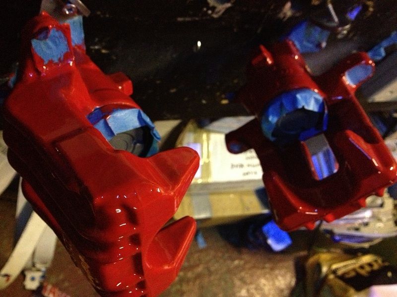

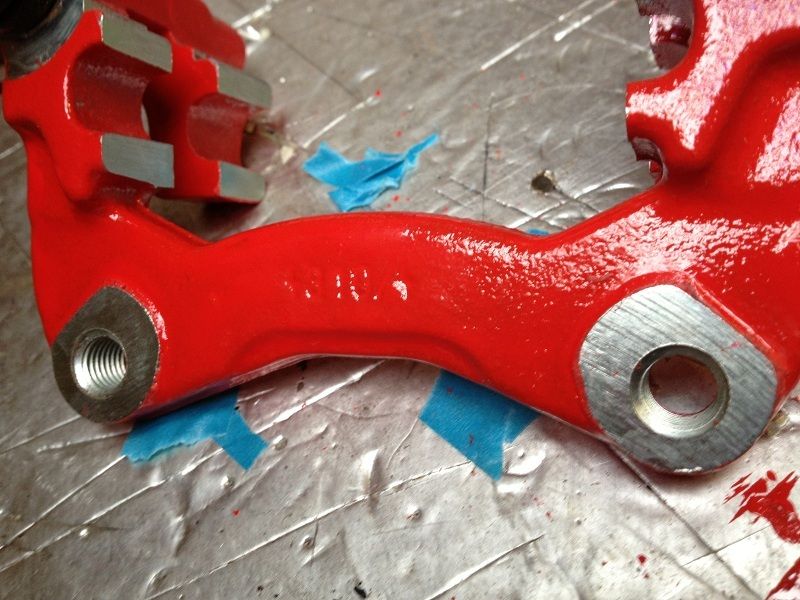

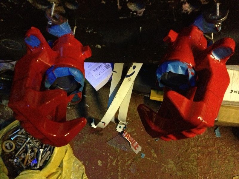

Riley 0 Posted October 30, 2012 (edited) Lol, coming soon. Have been waiting for more parts for the rear brake conversion but today I painted the new carriers and mk4 golf calipers. Pics/update soon. EDIT: Oh and tonight I've just finished my spreadsheet of total costings on the Corrado over the past 7/8 years of ownership. Have added all receipts I've got and the total... £21,382.70!!! Seriously! :bonk:That's without buying the bloody thing! Edited October 30, 2012 by Riley Quote Share this post Link to post Share on other sites

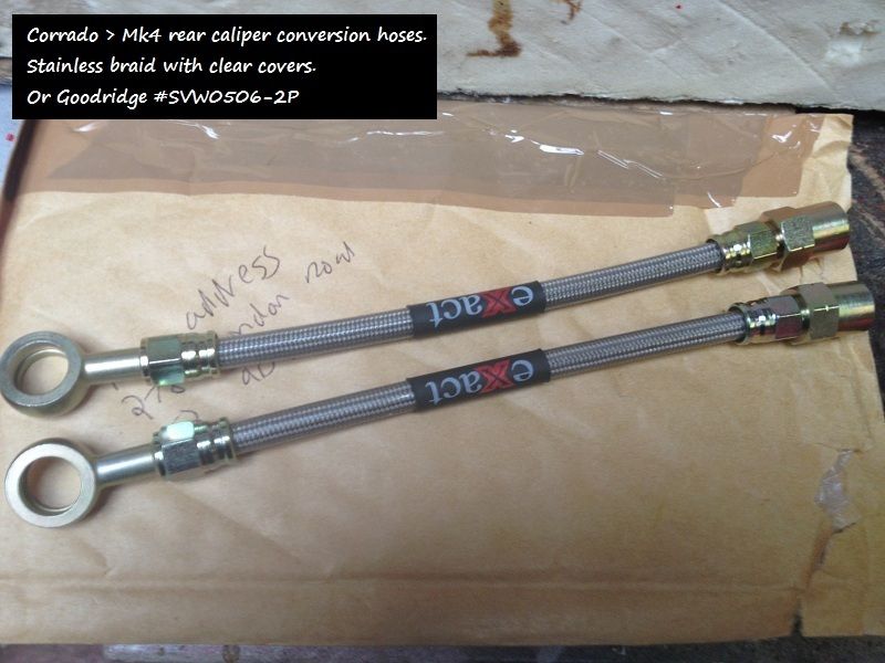

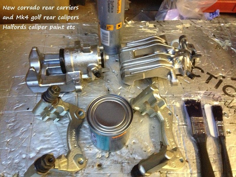

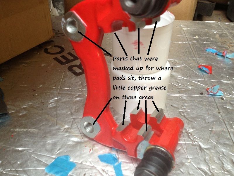

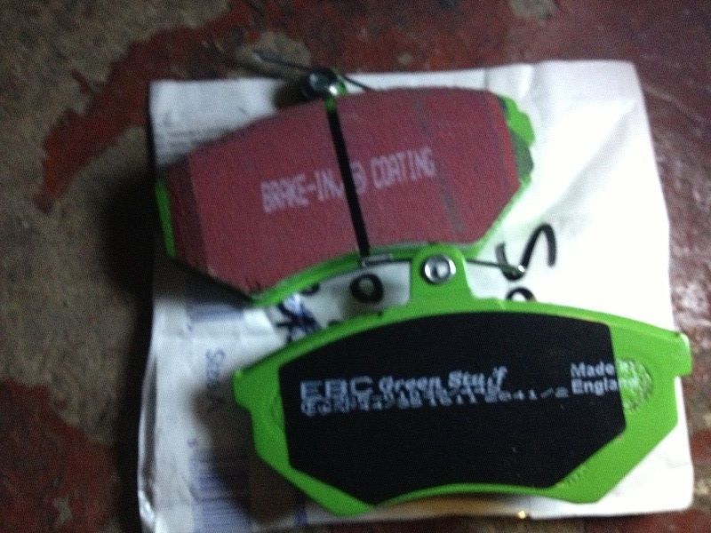

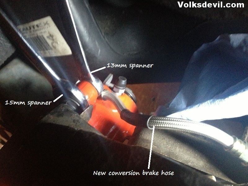

Riley 0 Posted November 1, 2012 (edited) I hope you've got agreed value insurance ! Seriously Neil,your car is one of the best out there,I'd love to see it in the flesh Wow mate, that's a hell of a thing to say! :notworthy: Much appreciated but it's nothing special really, I'ts no show car or anything but it does get used! I just do my best with it and try and do what I want to do myself.:thumb right: I've just (Nearly finsihed) fitting the Mk4 golf calipers on the rear. I went for: New ABS sensor New Handbrake cables. New Corrado Carriers. New Mk4 Golf calipers. New brake pads. New greenstuff front pads for the hell of it. Banjo bolts. Conversion stainless braided hoses with clear covers from on here. And some Halfords red brake caliper paint lol. Thought I'd try something different to the hammerite I've always used before. I've done a massive/comprehensive guide on Volksdevil here too. :thumbleft: New Carriers, Calipers, Handbrake cables. Halfords brake caliper paint, cleaner/degreaser etc. New carrier bolts, banjo bolts etc. Conversion hoses, from on here, very nice. Masked up all the bits where the pads will sit on the carriers (Then copper greased the masked areas), masked bits on actual calipers. Then painted and all fitted up. The finish on the carriers was a bit rough cast unfortunately, hence a crap finish, but they will do. And a pic fitted up from the guide I've done. Edited November 1, 2012 by Riley Quote Share this post Link to post Share on other sites
Riley 0 Posted November 1, 2012 Not much managed today, just went around torquing up bolts etc. Fitted the new Greenstuff front pads and bled all the brakes. Clutch is super light now! I wanted to go for the pagid fast road pads again as I found them to be really good, but no longer made unfortunately! Quote Share this post Link to post Share on other sites

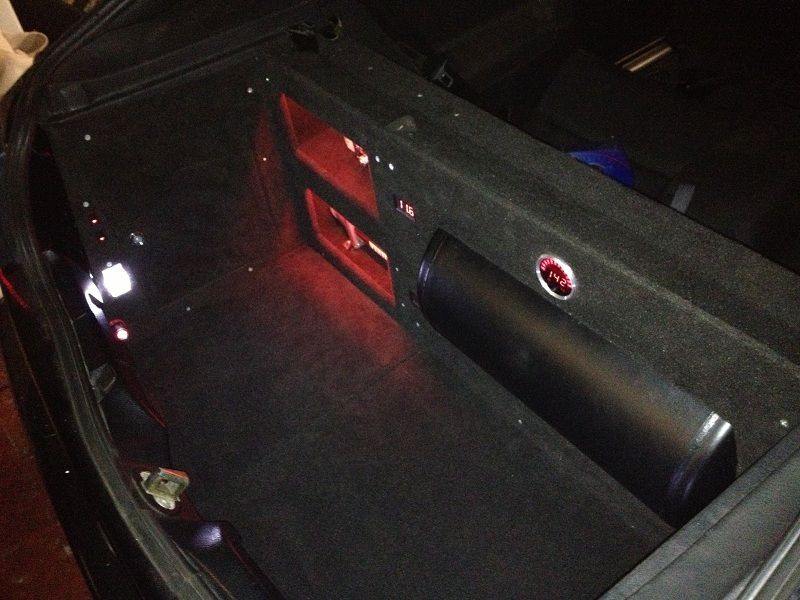

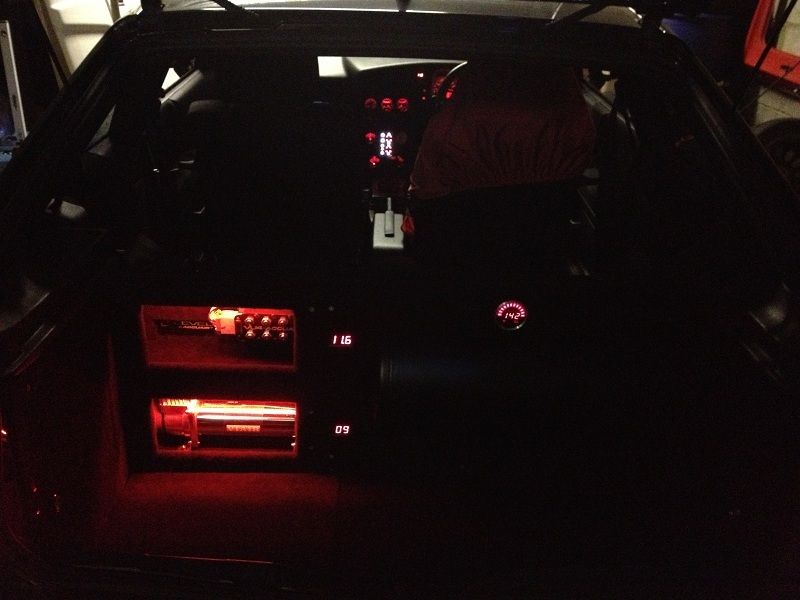

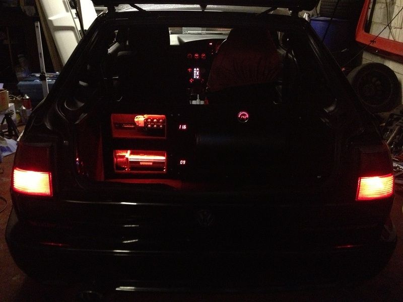

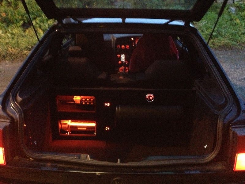

Riley 0 Posted November 4, 2012 Finally got the boot build back together and near enough finished after having to dismantle it all to sort other issues. Crap pics for now...Neons, custom led boot lights, cig lighter torch all lit up, powered up and working. All lighting goes off when the boot lid closes. Digi volt gauge and compressor compartment temp gauge both working good. Tank pressure gauge working good. Just need to fit some perspex in the two compartments, fit my black screw head covers, and fit my Vw badge door handles on the side compartments. ---------- Post added at 3:03 AM ---------- Previous post was at 2:13 AM ---------- Whoops, forgot my silly little crap video! [video=youtube;2KUD0-u1SEk] Quote Share this post Link to post Share on other sites
