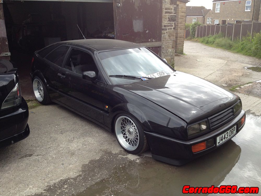

Riley 0 Posted May 22, 2013 Went up to my unit earlier as I needed some tools to work on the house...Thought I'd fire the Corrado up just to hear it. Forgot my button for the leccy shutter door! :roll: Gutted! Quote Share this post Link to post Share on other sites

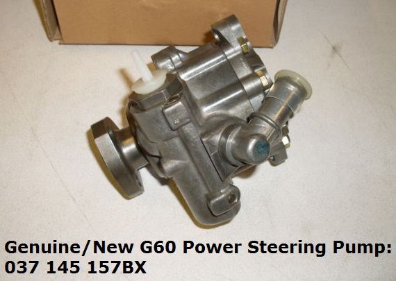

Riley 0 Posted November 20, 2013 Hello all, Well although the Corrado is off the road I came across a New/Genuine Power steering pump and promptly bought it! Long obsolete and specific to the G60, I've been searching for one for ages! 037 145 157BX That is all :-( Neil. Quote Share this post Link to post Share on other sites

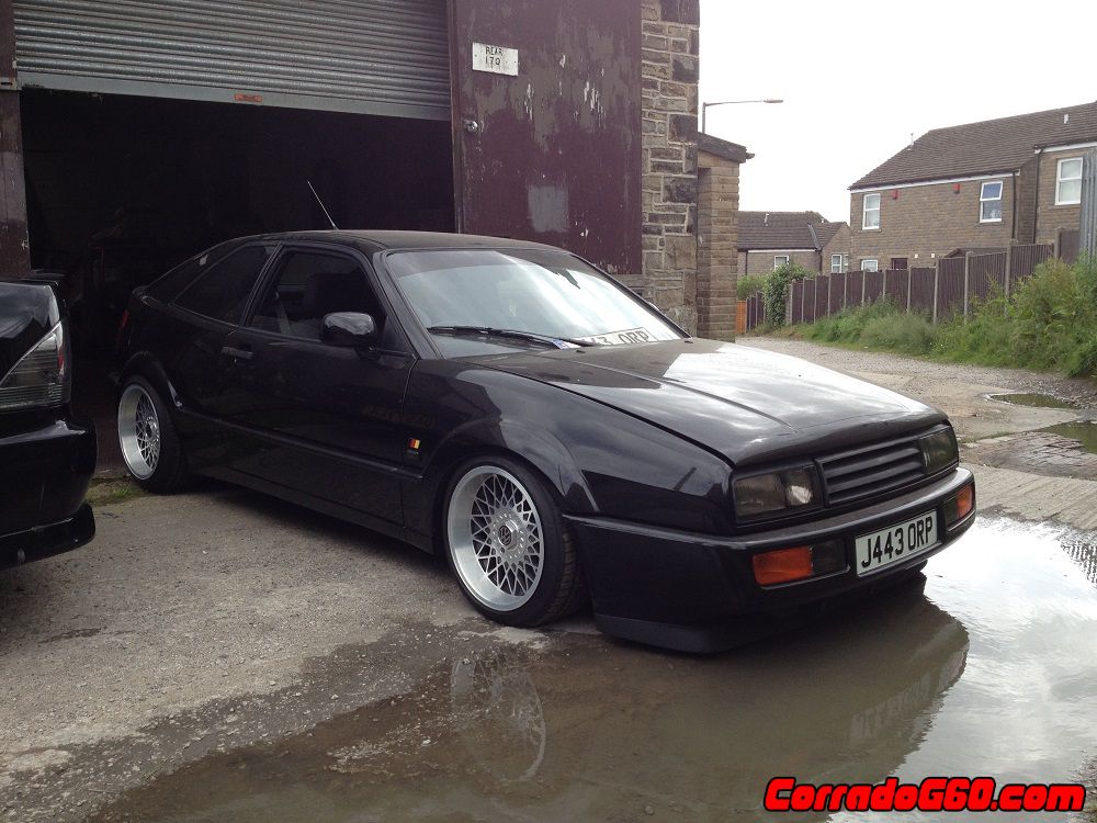

Riley 0 Posted June 9, 2014 Dragged it out of the unit today and ran it for a while. Felt a bit 'Meh' about it tbh. It's the absolute worst it's ever looked, properly filthy and has gone a bit moldy inside! Quote Share this post Link to post Share on other sites

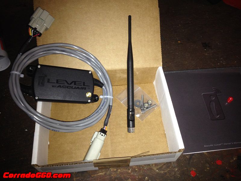

Riley 0 Posted February 16, 2015 Well...New toy to accompany the air ride. Accuair I-Level. Getting it up and running has been easy peasy...But I've been trying to properly finally finish the air ride by fitting the E-Level height sensors and OMG, absolute nightmare! I'd honestly rather do the heater matrix again! The instructions presume that you have a simple swinging arm rear end, where everything aligns nicely. But we know that's not the case with the Corrado! The measurements are critical so that the sensors aren't damaged (Over extended) and that they read over as wide a sweep as possible. You have to aim for 2.75" of travel on the sensor, adjusted by moving closer to, or further away from the rear beam pivot point, but wherever I tried it (Just putting marks and measuring) it just didn't ever get anywhere near enough. Not helped by the fact that the inner arch runs away from the beam...All sorts of silly angles to consider! After months of searching I haven't found a single picture of the e-level sensors fitted to a Corrado, mk1 or mk2 golf! There's just no easy way to mount them on the rear, but after literally three days I think I'm getting somewhere...Have made up some brackets to mount to the bottom strut bolt. And that's where I'm up to. Haven't even bothered to look at the fronts yet! I nearly threw the towel in a few times on the whole car game tbh while trying to sort these sensors! Wondering if I was getting too old for it all, knees and back killing crawling under the car, freezing cold, p|ssing about with an ol' banger! But seems I'm still going for now... Quote Share this post Link to post Share on other sites
