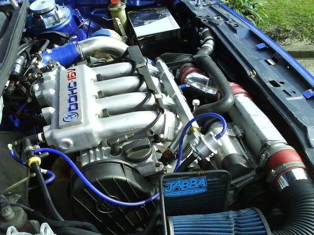

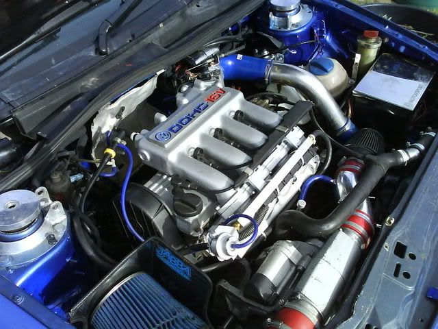

Yandards 0 Posted March 3, 2008 Looks good, you use a modded G60 bracket with an mk 3 goof alternator bracket? As for the boost pressure, pressure is simply a sign of back pressure in the system. As the standard 16v head breathes as well as a CNC big valve head for the G60 (near as damn it) I would expect less boost pressure - does not mean you are down on power though. Quote Share this post Link to post Share on other sites
flusted 0 Posted March 3, 2008 I bolted a vr6 alternator to the standard g60 bracket where the aircon would go. I had to grind a bit off the alternator which i regret doing as its not a straight swap if the alternator ever goes. I need to get it taxed and get my bumper back on and give it a pasting Quote Share this post Link to post Share on other sites

dirtytorque 0 Posted March 3, 2008 You know what...I keep looking at this and that engine bay really does look good. Well done mate.Quite jealous. :) Quote Share this post Link to post Share on other sites

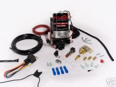

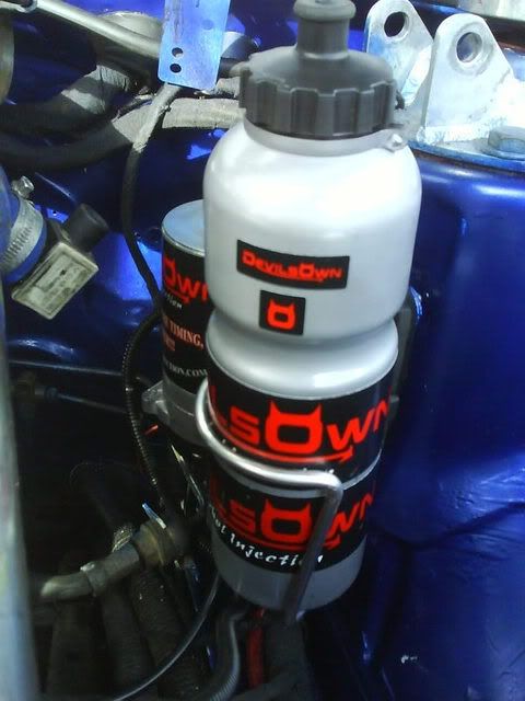

flusted 0 Posted March 4, 2008 Heres my devils own water/methanol injection kit And a short vid of injection nozzle that i fitted "] Heres a pic the water/meth reservoir, its basically a alloy drinks bottle i painted and stickered up lol Quote Share this post Link to post Share on other sites
mrbeige 0 Posted March 4, 2008 Heres a pic the water/meth reservoir, its basically a alloy drinks bottle i painted and stickered up lol I like you ingenuity! Good skills :afro: Quote Share this post Link to post Share on other sites

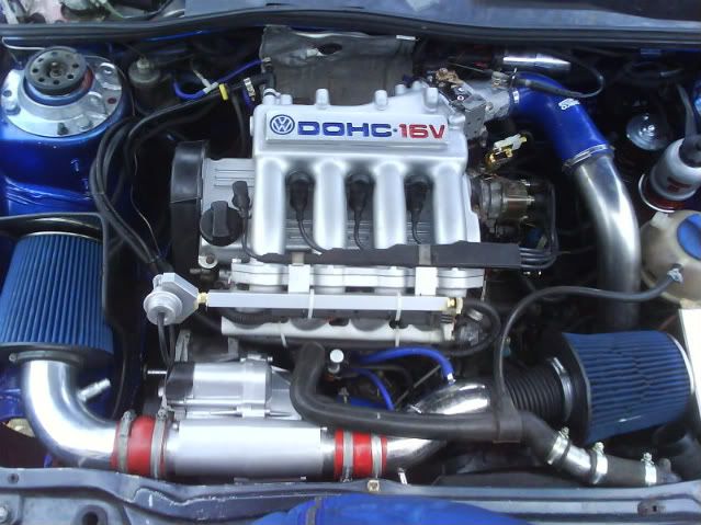

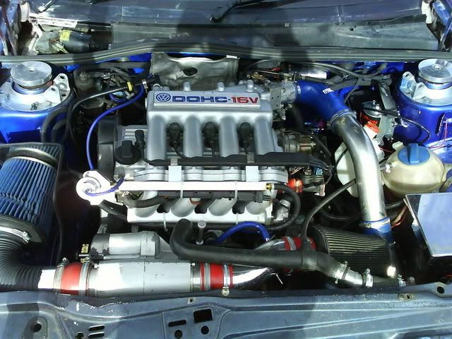

flusted 0 Posted March 24, 2008 just a up to date pic of the bay after a quick tidy up. hopefully will be on the road 1st of next month Quote Share this post Link to post Share on other sites
junkie 0 Posted March 24, 2008 That twin filter set up is looking 8) mate :roll: Quote Share this post Link to post Share on other sites
flusted 0 Posted March 25, 2008 just waiting on a heat shield for the right filter. got another jabba shield comming and guna mod it to fit the otherside. 3" inlets all the way to the charger Quote Share this post Link to post Share on other sites
