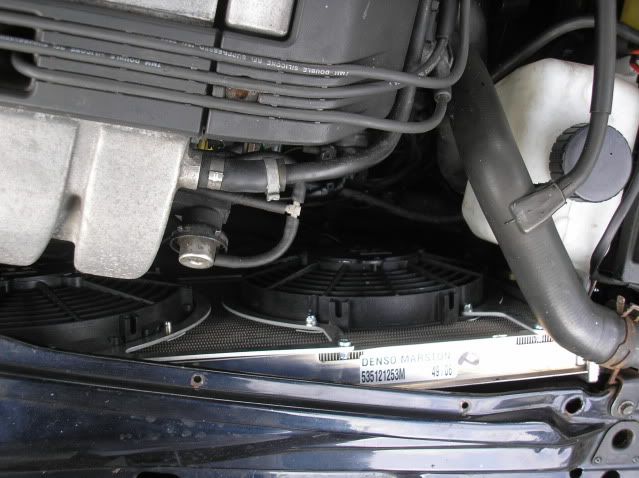

bananawhip 0 Posted March 24, 2010 Recirculating valve... Little vacuum port at the top of it, run a hose to the abs vacuum feed like a Schrick (little green caps) or does it need a feed from somewhere else? I've got it in my head to pop a Y piece into the line that comes off the FPR but I don't know why I'm thinking to do that :confused4: :D Any ideas? Does it even need a vacuum feed, I've looked at pictures of engine bays for the past 30 mins but can't figure it out Quote Share this post Link to post Share on other sites
The_Dude 0 Posted March 24, 2010 bananawhip said: Recirculating valve... Little vacuum port at the top of it, run a hose to the abs vacuum feed like a Schrick (little green caps) or does it need a feed from somewhere else? I've got it in my head to pop a Y piece into the line that comes off the FPR but I don't know why I'm thinking to do that :confused4: :D Any ideas? Does it even need a vacuum feed, I've looked at pictures of engine bays for the past 30 mins but can't figure it out Like this? Quote Share this post Link to post Share on other sites
bananawhip 0 Posted March 24, 2010 Quote Like this? That's where I've seen the picture, I knew I had it in my head for a reason :D If I'm honest I accidentally deleted your very informative PM so I couldn't double check, Was that for the recirc valve then? Quote Share this post Link to post Share on other sites
The_Dude 0 Posted March 24, 2010 bananawhip said: Quote Like this? That's where I've seen the picture, I knew I had it in my head for a reason :D If I'm honest I accidentally deleted your very informative PM so I couldn't double check, Was that for the recirc valve then? Yup! Quote Share this post Link to post Share on other sites
bananawhip 0 Posted March 24, 2010 Quote Yup! Coolio, Pretty much done then... Test drive tonight :clap: Quote Share this post Link to post Share on other sites
The_Dude 0 Posted March 24, 2010 bananawhip said: Quote Yup! Coolio, Pretty much done then... Test drive tonight :clap: Awesome! You'll love it. :nuts: Quote Share this post Link to post Share on other sites
