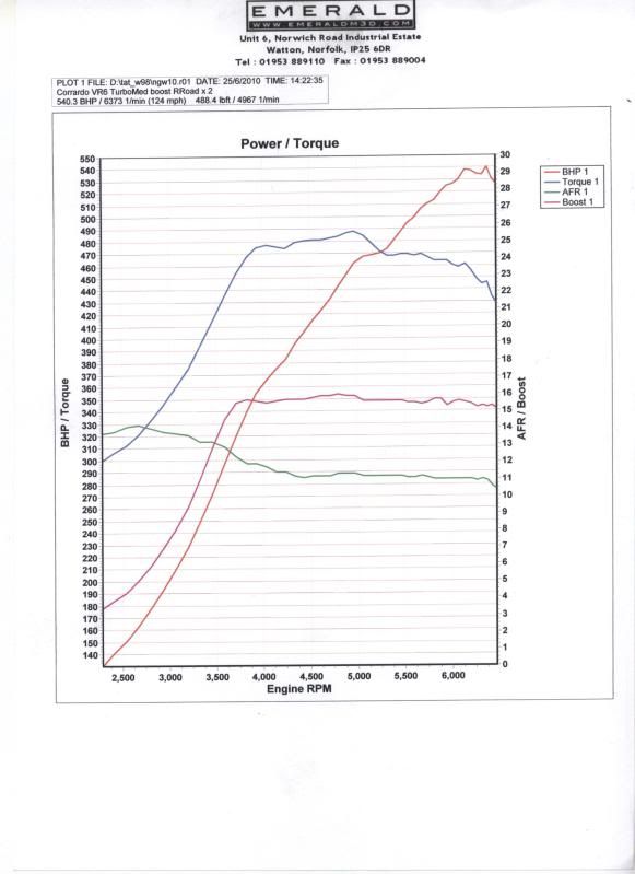

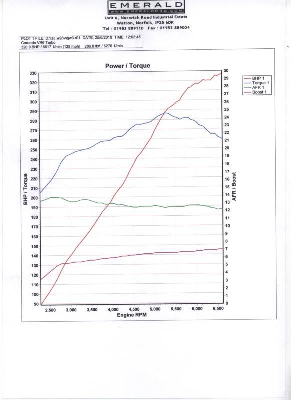

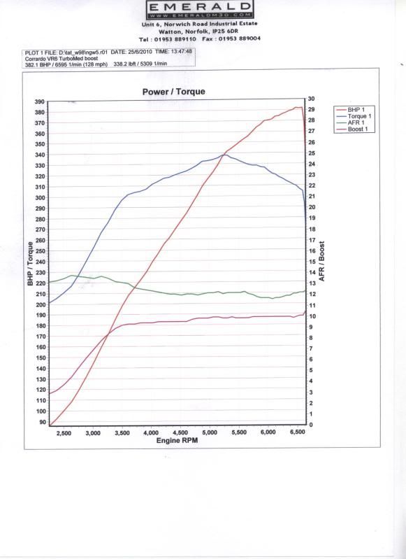

jamminvr6storm 0 Posted July 19, 2010 scoot spanker said: went out in this today...had alot of fun against an Aston Martin DB9. came off a private slip road and managed to catch it and keep level with it even though we lifted off briefly! VRTs rule! LOL... this was good fun, VRT's are very quick :D Just a shame I didnt have the confidence that it would corner as well as the DB9.... Otherwise I wouldnt have had to lift off :lol: So here are the graphs: Graph 1 - Measured using Emeralds standard rolling road software, shows 326.9bhp @ 7psi Graph 2 - Measured using Emeralds standard rolling road software, shows 382.1bhp @ 10psi That's a 56 bhp gain for 3psi more boost. (Kevs makes 392 @ 11psi / Shauns makes 400 @ 14psi) Graph 3 - Emeralds standard rolling road software only reads up to 400bhp so Dave Walker use additional software to measure bhp figures over that. I was advised by Dave Walker that this software reads approximately 5% out and I should remove 30bhp from this graph (Shaun, you can check this with Keith at JKM as they have a very good relationship with Dave Walker) - shows 540bhp (-30bhp) Given that the difference between Graph 1 and Graph 2 is 56bhp for 3psi it would make sense that its running around 500bhp on 16 psi. The end of the day, I can only go by what I have been told at Emerald as this is the only rolling road it has been on. Fair enough what you say Shaun, these figures are different to yours on the same turbo (GT3076) but my engine specification is different to yours. Charlie, arent you running the smaller GT3071? This would give a quicker spool but less top end power. Tell you what, how about if my car makes 500bhp @ 16psi at the Stealth shoot out.... Shaun and Charlie can pay for my run :norty: I'll await the comments...... Quote Share this post Link to post Share on other sites

Kevin Bacon 5 Posted July 19, 2010 Mine averages 27mpg (worked out the old fashioned way) if driven normally. 'Normal' for me is 85mph cruising speed and the odd bit of boost when some chump tailgates me. I don't do steady 56 or 70mph nonsense. I'd rather do that in a car built for economy. VRTs are built for acceleration. If I go out on a bender racing everything in sight, then mpg can drop to about 10 very easily :lol: Ben, sorry mate, I haven't spoken to Vince yet, I didn't go on Saturday. I was too p1ssed and hung over from the previous night's entertainment :lol: Cheers for the graphs Ben, very impressive indeed :D This precisely why I suggested a VRT dyno day as it gets together a bunch of cars with different specs on the same dyno, on the same day. I don't think it's ever been done before, certainly not in this country? I think, no, I know, some people will be dissapointed. Others will be elated....but one thing's for sure, it will settle a few arguments :wink: Bear in mind that Ben and I have an 'unfair' advantage with our additional head flow. It is the biggest bottle neck in the whole VRT intake/exhaust path. Could that be the reason for the freakish outputs? I don't know.... there's only one way to find......FIIIIIIIGGGGHHT!! Quote Share this post Link to post Share on other sites

StormchargedVR6 0 Posted July 19, 2010 Knew should have gone to Dave walker for my mapping :lol: Sorry Ben, nice work buddy :) Quote Share this post Link to post Share on other sites
