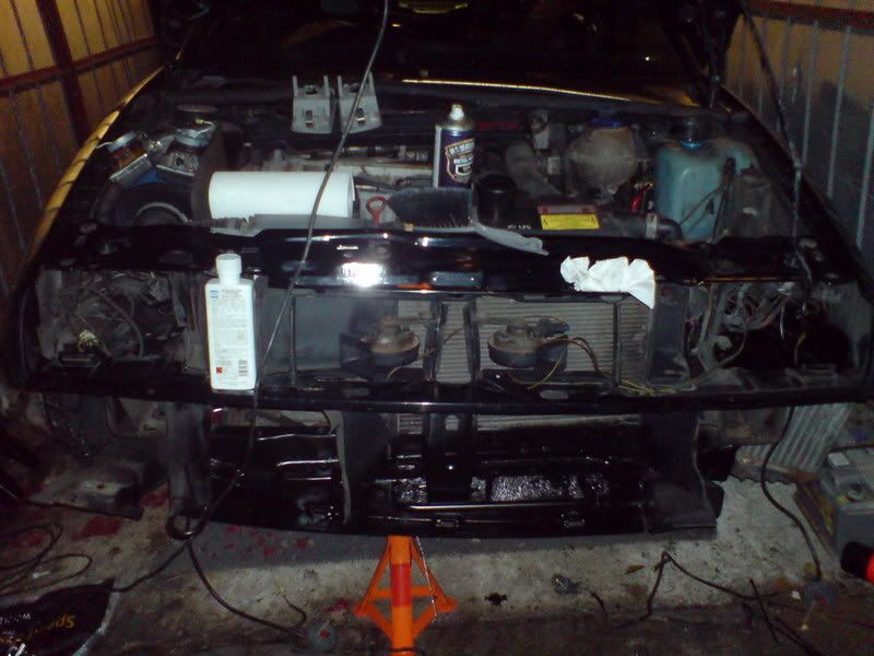

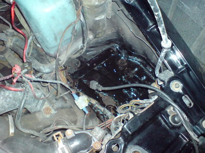

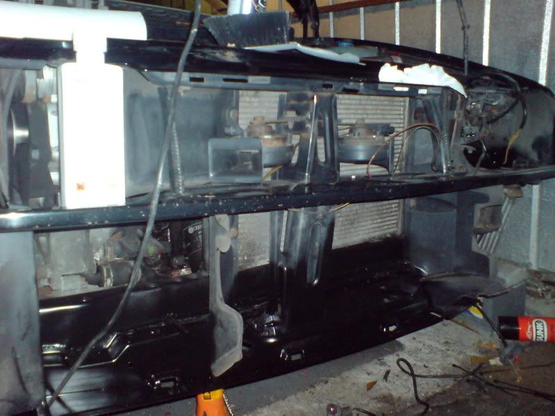

timg60 0 Posted March 21, 2007 Well. she is looking pretty poorly at the moment but I am getting there. Have taken off the old mashed bumper. The new rs one is at the spray shop getting preped and painted and should be back by the weekend :D Whilst having the bumper off have cleaned the intercooler and all the metal I can get too. Took the battery out and was horrified. Rusted to buggery. Have cleaned it and hammerited it to try and stop the rust but what is the best solution???? Have refitted the plastic arch trim where it was pushed back against the wheel and thankfully that was the only problem.. :D I had horrible visions of bent metal bits but there isnt really that much under there. And have also rubbed back and hammerited all the front under the bumper and the front slam panal that I can get to. So all in all quite a healthy exercise. Have also rubbed back and hammerited the bumper mounting struts.... Anyhows some piccies 8) Quote Share this post Link to post Share on other sites
ben16v 0 Posted March 21, 2007 mate i just failed mot on rusted battery tray, quite common if old batt has leaked, got a new panel from gcp i think for 18quid and got it welded in Quote Share this post Link to post Share on other sites
timg60 0 Posted March 22, 2007 How much did it cost to get welded in and was it a pain to get the old one out? cheers Tim Quote Share this post Link to post Share on other sites
ben16v 0 Posted March 22, 2007 i left it at a garage whilst getting a whole load of other stuff done too, but from my receipt it looks like he spent around 3hours working on it, but i cant tell its been done now, Quote Share this post Link to post Share on other sites
