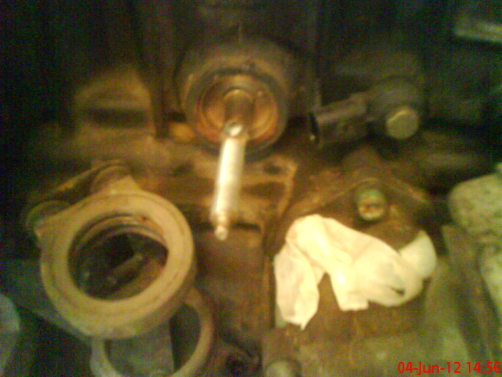

VW_OwneR_85 2 Posted May 30, 2012 FishWick said: You need to use the 24V alternator mate cheers buddy, anyone wouldnt happen to know the part number for the core plugs by any chance ? also the core plug to the AUX pump hard to remove? iv seen DIY vids on youtube on different engines and doesnt look to bad, Quote Share this post Link to post Share on other sites

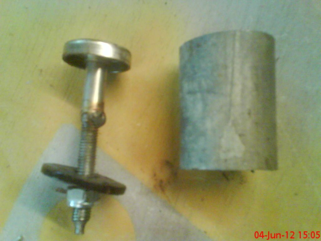

Kevin Bacon 5 Posted May 31, 2012 I would tap the spout in the middle of the core plug and then you can wind the bolt in against a big washer and a tube outside of the spout and pull it out, if you follow me? Failing that, you might get away with levering it out with a screwdriver. I was going to do that myself but I didn't have anything of the right diameter to knock a plain plug back in with! Quote Share this post Link to post Share on other sites
VW_OwneR_85 2 Posted May 31, 2012 yea im with ya, just dont have anything with a thread that big, but im sure i could come up with a puller of some sort, its just getting a part number so i can order one thats the problem , i'll look at my block tomo to see if theres any blank ones and then etka it. Quote Share this post Link to post Share on other sites

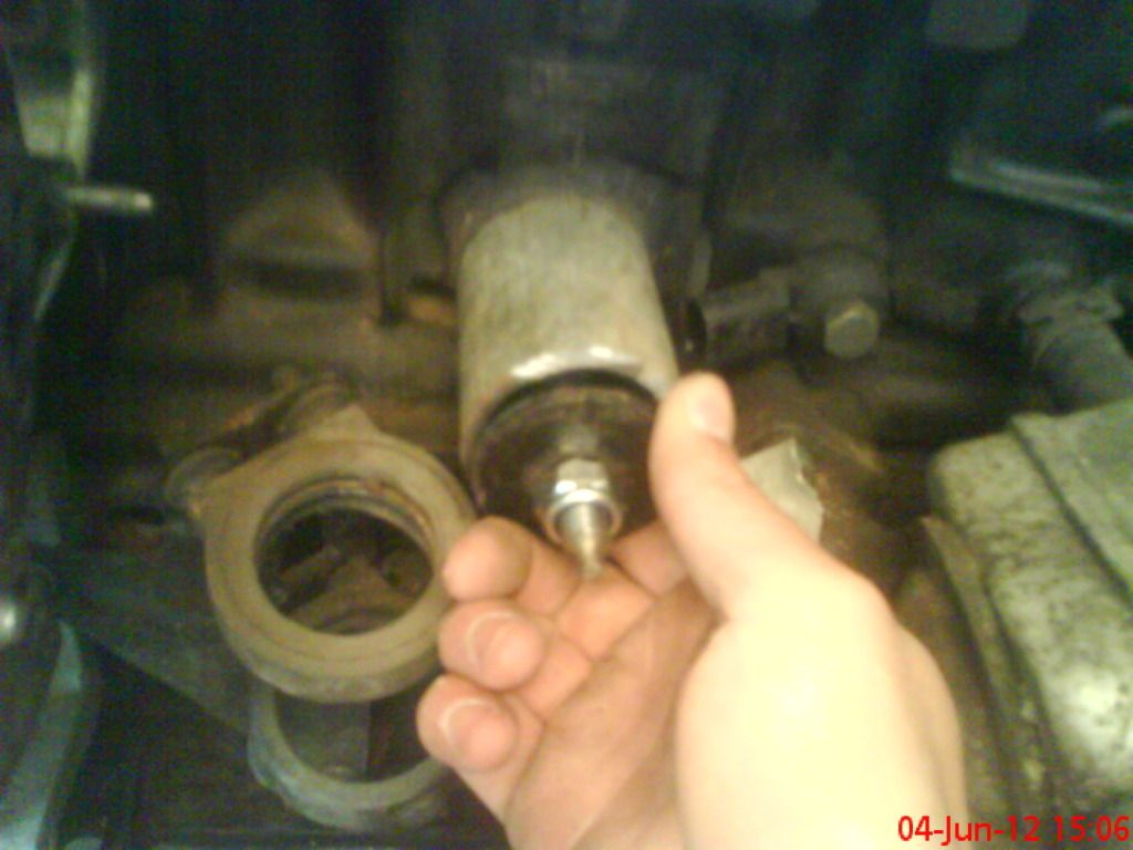

VW_OwneR_85 2 Posted June 4, 2012 no worrys mat all sorted, got the old core plug out today, ended up useing an off cut of scaffold tubeing and a threaded stud welded to the tube on the core plug and basicly pulled it out, Quote Share this post Link to post Share on other sites
