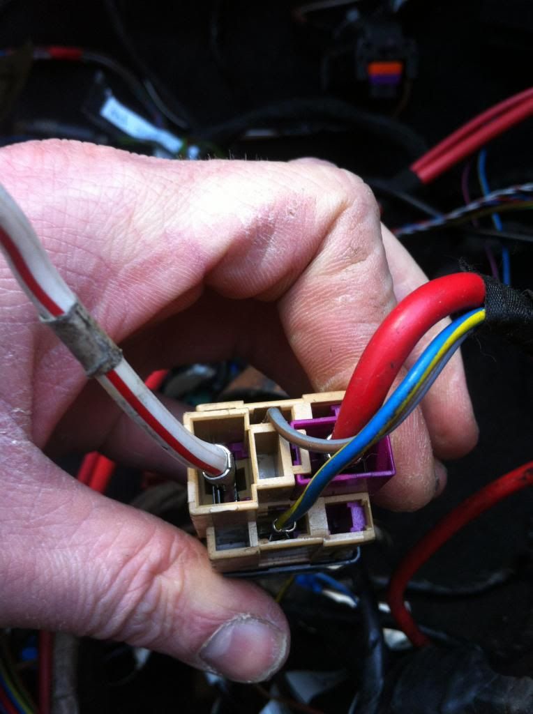

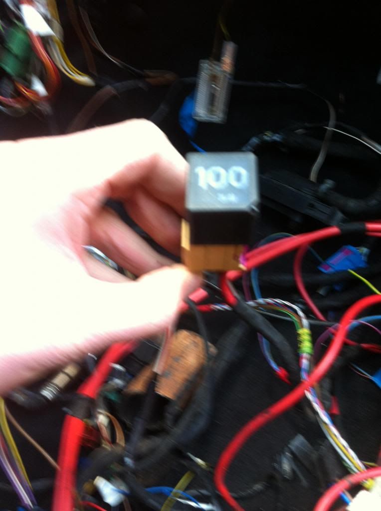

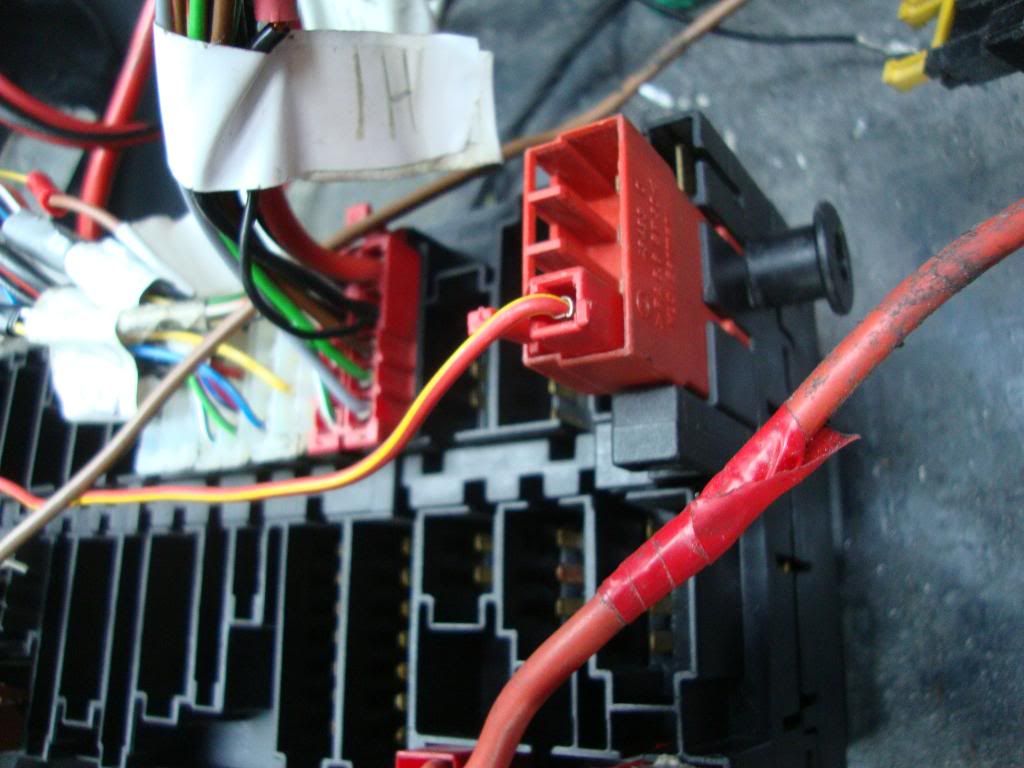

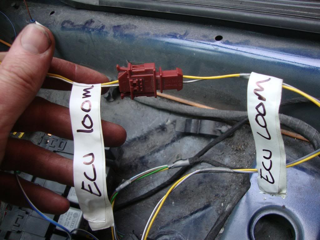

so here is where im at wiring wise, engine is a 2.8 24v aue (i know not an r32 im a pussy but the 2.8 was a good price i think for everything i got plus i didnt wanna blow a r32 up trying to get it in haha)
O should add this engine was still in the car running when i picked it up and took it out myself to make sure i had everything i wanted /needed haha well i think i did
so ecu sent to stealth and de immobilised (cheers guys amazingly fast service sent it wednesday had it back first thing monday morning)did have the clocks keys and rings so didnt really need to do this but just decided it was the better option and one thing less to try and and work around or think could be the problem
ive used the vr starter motor wiring from to F in the fuse/relay panel so havent touched this one bit.
^^^ i was wondering weather i needed to connect the 24v to this but as im not using the 24v fuse board or relay panel ive just left this loose in the bay
engine does turn over but not surprised by this as thats just a case of putting power to the starter motor
so now for the fun part haha so to make it easy for people to change and edit ive used the great write up that rubjonny did on clubgti and ill just keep the stuff how i wired mine up so to make easy for people to change and edit after the pin number ive left that box as rubjonny has written as then i'll leave a gap for people to put in where they have put there wires and hopefully this should really help people get an idea of how other people have wired there cars up
o and before people say ive copied this and it still doesnt work well this isn't a fool proof guide to fit an engine its just so maybe people can get an idea of where they might have gone wrong and to share info and things they have learnt if they choose, o and if people make changes could they please use a different colour to make it easy to see where they have changed please.
