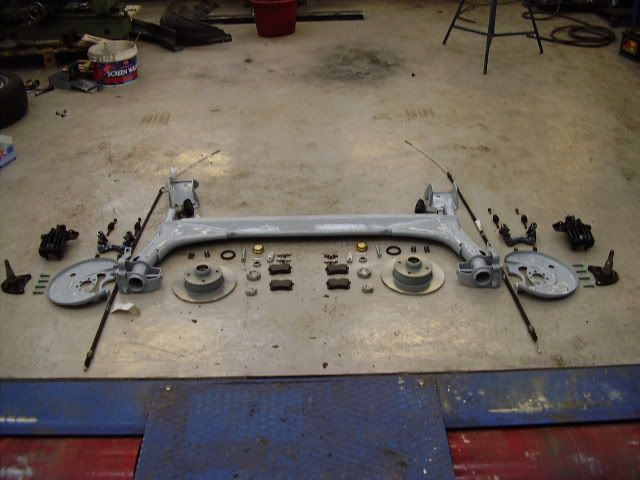

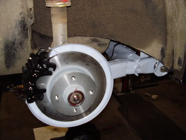

jezzaG60 0 Posted March 19, 2006 I did this conversion a little while back. I picked up some calipers off ebay from a skoda fabia vrs. I used mk2 pagid fr pads, pedal feel is fine you just have to make sure you wind the caliper out to a close fit before putting it all together. As i already had goodridge hoses all round and i'm a tight arse i made some little adaptors which let me use the original hoses. I now have a handbrake which locks the rear wheels with 2 clicks!!! Something i have never had in 10yrs of gti/corrado ownership!!!! i got a little carried away considering all i needed was 1 new caliper!!!!! Quote Share this post Link to post Share on other sites
