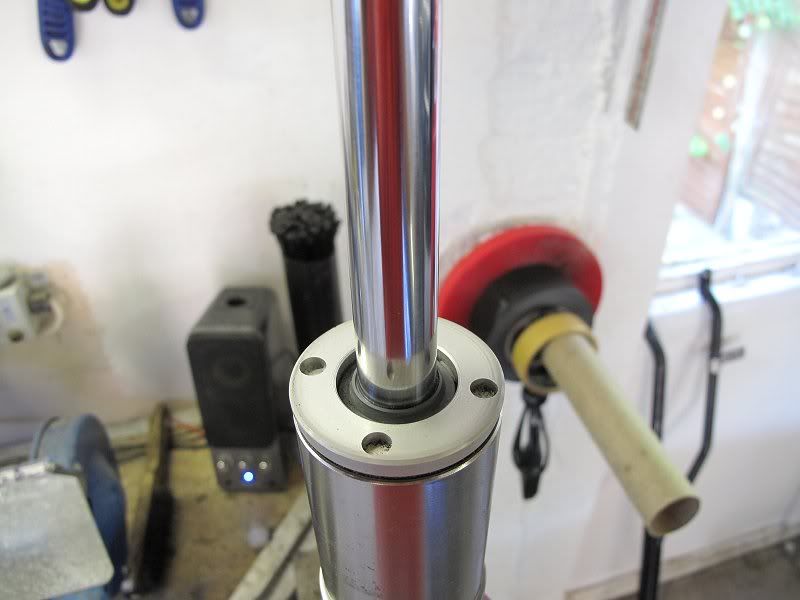

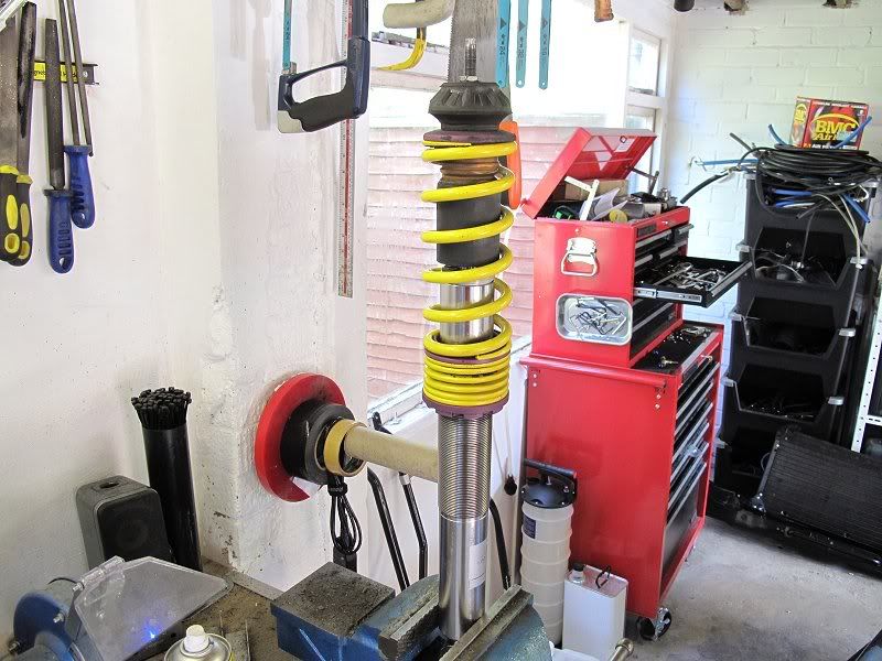

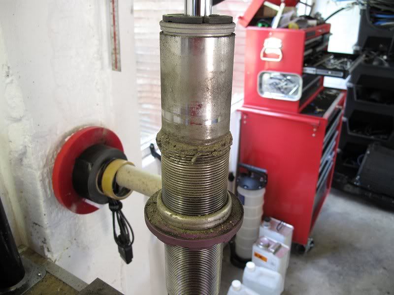

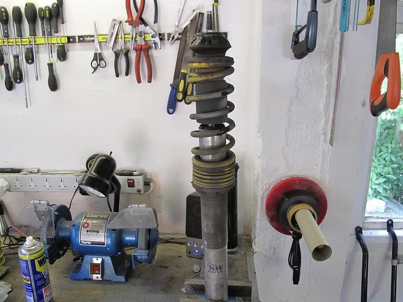

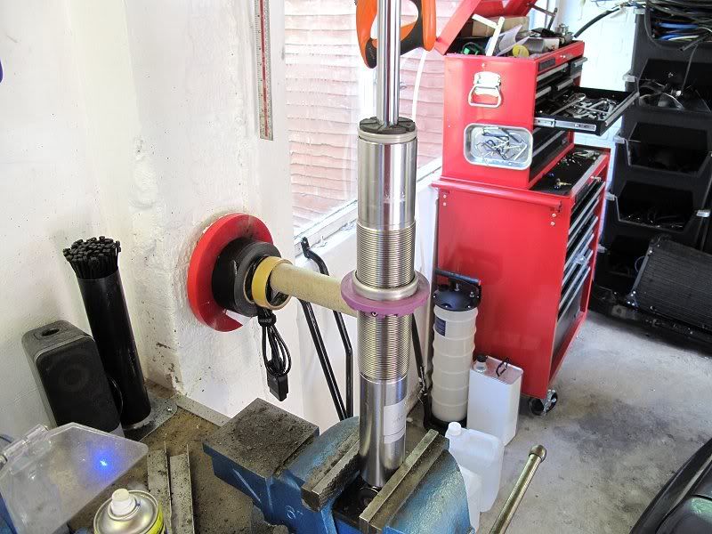

Kevin Bacon 5 Posted September 26, 2009 Just to support NeilVR6's findings, here's another example of why you need KW's inox in your life :D So yeah, I was c0cking about in the garage today fitting stiffer springs to my KW V3s and I thought I'd show you why they are so darn good :D Take one rear strut that's been on the car 2 years, and anyone that knows coilovers knows the rears never get hot and therefore corrode VERY easily, and this is typically what you see......crud, waxoyl, paint (if you've been rust treating!) and assorted road grime.... No word of a lie, after a very gentle wire brushing of the threads with WD40 and a wipe down, this is what the damper comes up like.... And a wipe over of the springs and perches and you have a new looking strut again! I've been through loads of suspension setups and I am very, very impressed by KW's quality :D And check this out, 2 years, 40,000 VERY HARD miles and not a single mark on the piston rod and not the faintest hint of oil leakage :notworthy: Note the removable collars = rebuildable, so the V3s are an excellent investment imo. Finally, a coilover for life :D Quote Share this post Link to post Share on other sites
