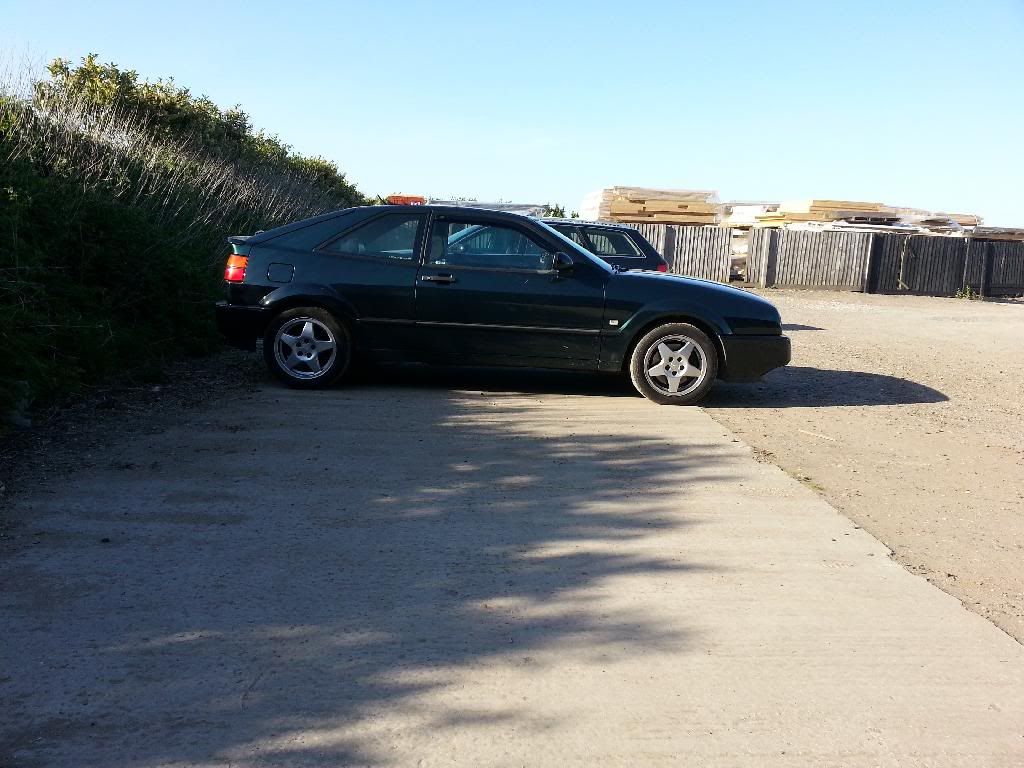

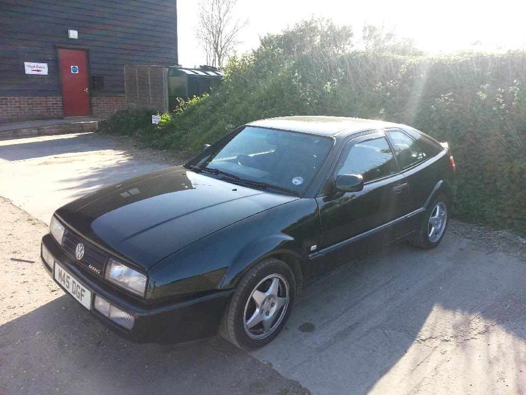

Jim Bowen 1 Posted April 16, 2014 SamG40 said: Have you got any pictures of the car on the konis/h&r setup please? I've got some konis and wondering whether to go for the h&r springs or something else, or put my fk konigsports back on. Cheers Hi, took these yesterday, although the rear end is on sachs advantage shocks, still H&R springs all round (i think the rear sat slightly higher with the koni shocks but i had the circlip as high as possible. Quote Share this post Link to post Share on other sites
