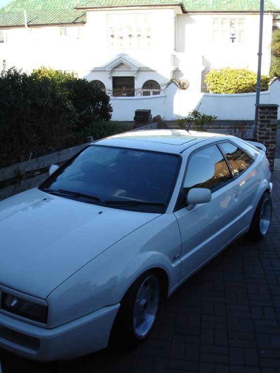

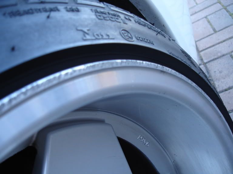

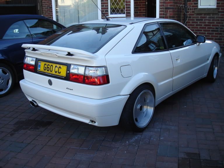

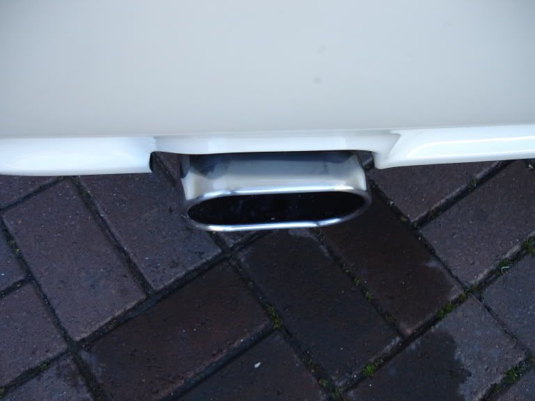

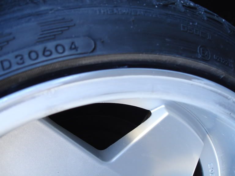

iow_corrado_g60 0 Posted May 7, 2006 here's what i've been doing very long process i've started with all the lips and been getting the curb marks out not done by me i must add! heres a pic of them then here's pic with no mark! then i got a little bored and polished my exhaust was very happy and it was like a stained stainless steel colour not good and here's what it looks like now! and here's just 2 pics of the beast after a clean! Quote Share this post Link to post Share on other sites

Riley 0 Posted May 7, 2006 good work m8 8) you are doing the right thing starting off with rough paper,can be a bit scary...but just try and get a nice/even non pitted mat finish all over,polishing is really rewarding when you get to the stages of using finer wet n dry. you want to finish off with at least 1000 grade,2000 ideally.and then move onto liquid polish. car looks good,ill take the wheels if ya get pi$$ed off with em :D :lol: Quote Share this post Link to post Share on other sites
ZippyVR6 0 Posted May 7, 2006 Looks Minty. Im not surprised your exhaust got dirty dude. All that popping and banging on lift off. Quote Share this post Link to post Share on other sites
gaz the geezer 0 Posted May 7, 2006 looking good mr iow_corrado_g60, must have had plenty of time on your hands this weekend mate, 8) Quote Share this post Link to post Share on other sites
iow_corrado_g60 0 Posted May 7, 2006 cheers riley i used 1500 on the exhaust i was really happy with that and didnt take ages but yeah with the wheels its just gonna take time! gaz yeah i dont have to play footys on saturday now so thats fee'd up a big chunk of time to allow me to fiddle! yeah i think the flame must be slighty tarnishing it zippy! lol Quote Share this post Link to post Share on other sites
veedub 0 Posted May 7, 2006 Looking sweet mate! Loving the polished borbets on that ibiza! Quote Share this post Link to post Share on other sites
