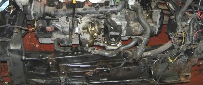

herisites 0 Posted June 20, 2009 Cheers guys! Quick visit with update. Got the R32 in today, rented a crane (soooooo glad I did, makes life slightly easier :lol) but at the moment the front is propped up with some blocks and wood as I haven't decided what to do with the front mount which to me looks waaaaay off! I don't know how to weld so couldn't mod the mount myself, so my other option was change the oil cooler as was told the VR one will replace the R32 one, well I don't think it does :censored: I took plenty of pics which are to come. I can't get on the tinternet at home at the minute as we haven't renewed contract which is annoying!! Quote Share this post Link to post Share on other sites
KADVR6 0 Posted June 20, 2009 the vr6 front engine mount does fit just fine, and the vr6 oilcooler also fits fine mate. have a look at it again tomorrow when your less stressed and you will work it out. Quote Share this post Link to post Share on other sites
herisites 0 Posted June 20, 2009 the vr6 front engine mount does fit just fine, and the vr6 oilcooler also fits fine mate. have a look at it again tomorrow when your less stressed and you will work it out. Yeah I have just come on here to save a bunch of Pete's massive photos, god bless him :notworthy: :lol: I will tackle it again tomorrow! It looks like the R32's filter housing and oil cooler is all in one but it must come apart looking at Pete's pics :scratch: Also it appears the R32 block is missing a chunk for the front mount, where the top bolt for the starter motor goes through :scratch: Ahh well, i'll have a good crack at it tomorrow and see how far I get! Quote Share this post Link to post Share on other sites

herisites 0 Posted June 20, 2009 Cheers karl mate. I need a mocal really, well i got one from my rotrex but it's the sandwich plate and fittings I need. Vince said the VR cooler will fit on so I'll have to try that for now, will just have to keep an eye on oil temps until I get the mocal stuff! Quote Share this post Link to post Share on other sites
KipVR 1 Posted June 20, 2009 I had to modify the front mount on mine, and you can't just stick the VR oil cooler on, I'll take some pics on monday if you like? Quote Share this post Link to post Share on other sites
pete_griff 0 Posted June 20, 2009 hey Rob, sorry to hear you're having problems pal - the front mount should just go straight on (if you haven't got an oil cooler in the way - mocal is defo the way forward here). also (you can probably see it in my pics (can't remember of hand without looking) i had a small adapter made up - basically it's just a sleeve to bridge the gap that you'll fnd is present for the long, thin bolt that goes through the top of the starter and into the engine mount. by etting the sleeve made up you'll avoid any potential bending of the engine mount... hope you get it all sorted pal - make sure you get some pics up - we can be more helpful then :D Quote Share this post Link to post Share on other sites
herisites 0 Posted June 22, 2009 hey Rob, sorry to hear you're having problems pal - the front mount should just go straight on (if you haven't got an oil cooler in the way - mocal is defo the way forward here). also (you can probably see it in my pics (can't remember of hand without looking) i had a small adapter made up - basically it's just a sleeve to bridge the gap that you'll fnd is present for the long, thin bolt that goes through the top of the starter and into the engine mount. by etting the sleeve made up you'll avoid any potential bending of the engine mount... hope you get it all sorted pal - make sure you get some pics up - we can be more helpful then :D Hi Pete, yeah I saved a LOT of your pics over the weekend and had my laptop setup with me in the garage with them up, very helpful indeed so many thanks!! :notworthy: I noticed you had a sleeve of some kind, I just put a big nut a some washers in it :lol: Got all my pics to come, I'm at work so will upload them in my lunch break :cheers: Quote Share this post Link to post Share on other sites
herisites 0 Posted June 22, 2009 I had to modify the front mount on mine, and you can't just stick the VR oil cooler on, I'll take some pics on monday if you like? Hmm I was told I could just put the VR cooler on, I have put it on and it fits perfectly. Do you know why it can't go on? Problem is, I don't know how to weld and don't know anyone who can really so modding the front mount wasn't an option for me. Quote Share this post Link to post Share on other sites
herisites 0 Posted June 22, 2009 As promised here are some pics for you all to enjoy :clap: Quote Share this post Link to post Share on other sites
