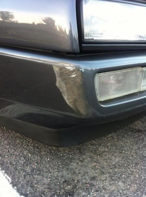

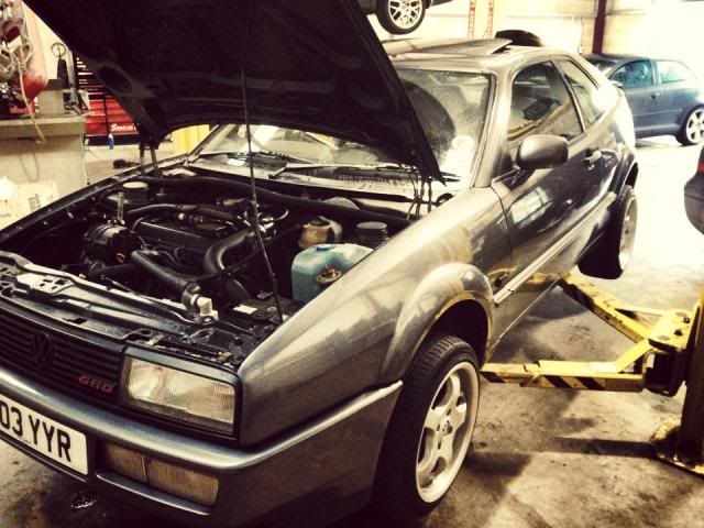

Bit off topic but why dont the garage justtake the head light and splitter etc off when spraying!!
nice repair though
nice repair though
I did think it may have been easier but it was a "mates rates" repair and i'm very pleased with the job he did for the price so cant grumble :)

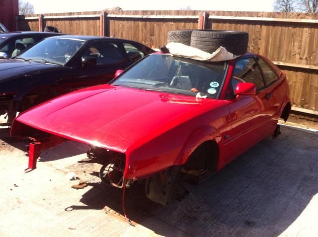

Sadly, the red valver did not get the same love after I sold it and now looks like this :(
still plenty of useful parts on there though (see the breaking thread on here by "twin45") so hopefully will help keep some others on the road! Some nice bits still available too like the half leather seats etc.

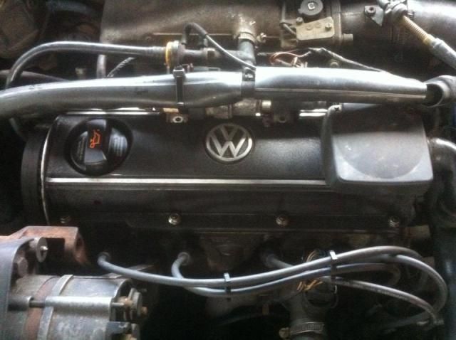

While we were at it, we finally fitted my new rocker cover to replace the nasty red one. Although it looks much better, it seems the tabs to fit the cambelt cover have been shaved off in the past so leaving it fitted while the orginal one is blasted and can then be painted a more subtle colour and refitted with the cam cover:

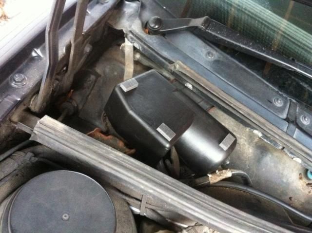

Wiper motor cover (avaialble from VW for about £10 3A2 955 128)

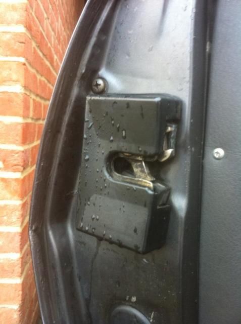

Door lock covers which i did not even know were missing! Kindly donated by steve:

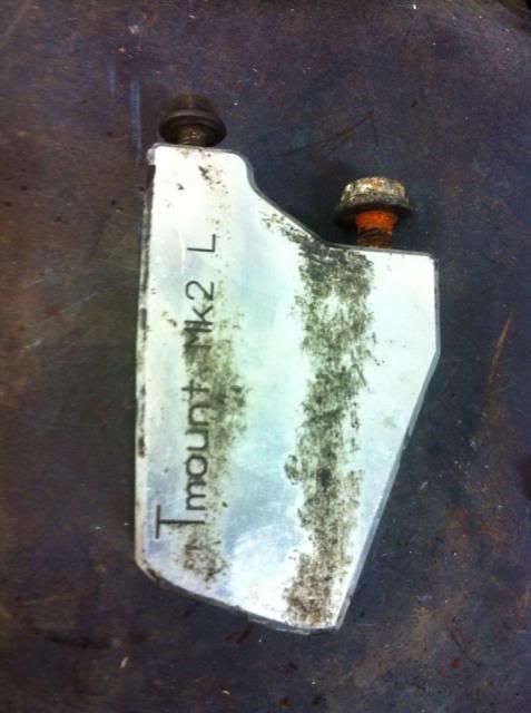

Fitted a solid front engine mount yesterday as mine was nailed, and some 8mm high performance ignition leads:

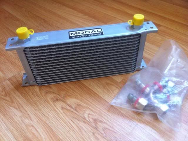

Also picked up a Mocal Oil Cooler but yet to fit:

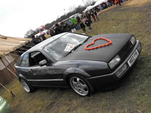

Really looking forward to the big display at Stanford Hall this Sunday! :)

I only saw 2 Corrado's at the whole show including mine! I heard that a few people got turned away at the gate as they could not fit anyone else in, did this happen to you then?

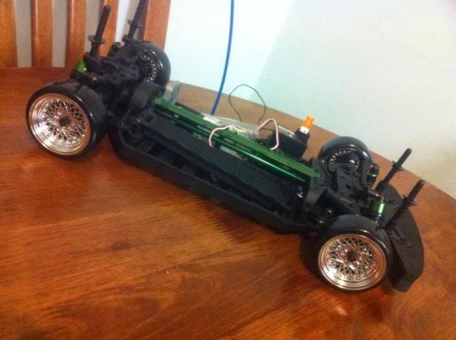

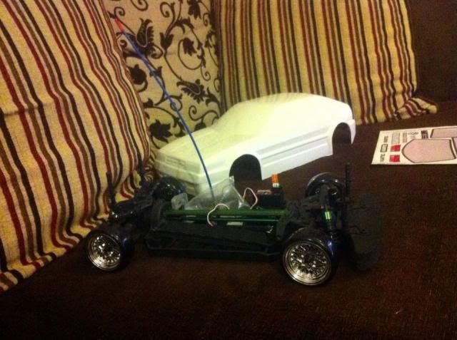

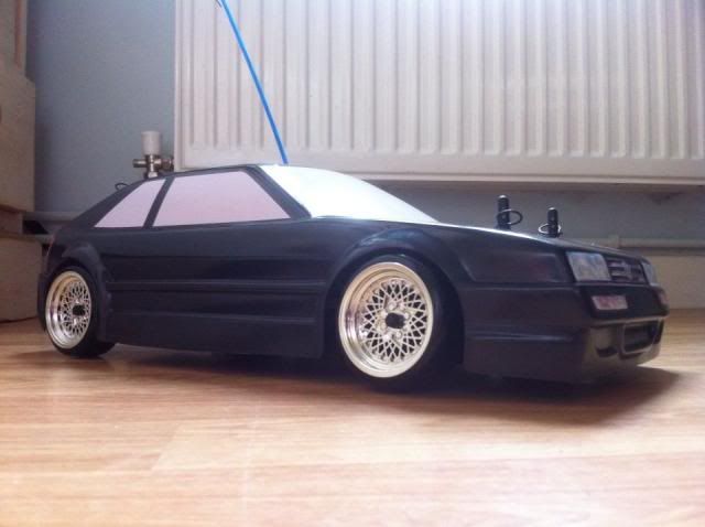

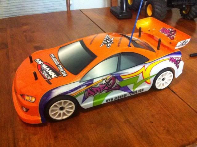

Not much to update on the G60, so thought I would post up the build on my other Corrado project. A mate gave me an old 1/10th RC car he no longer used:
fitted some new rims to it:

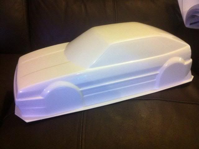

Then got bought this by another friend for my Birthday:

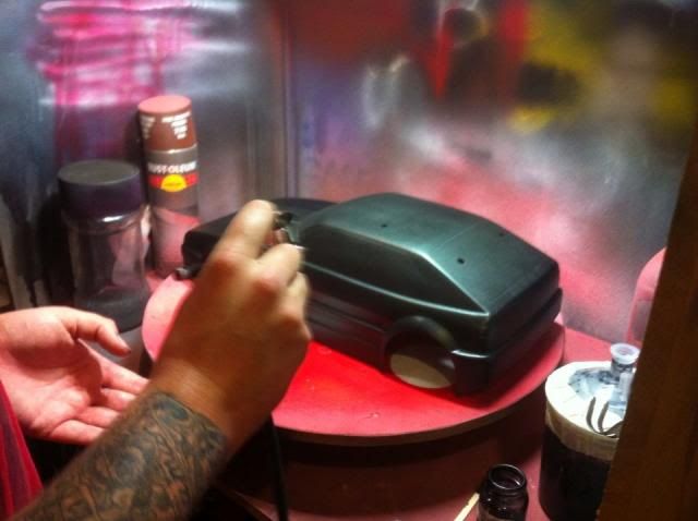

initially painted in Ford Graphite Grey as I was struggling to get hold of Pearl Grey, the colour was close to pearl grey but the finish was rubbish from a rattle can:
Then I remembered there was a small amount of paint left from when I had the front end of the G60 repaired from the hit and run. Rubbed down and back to the bodyshop :) :

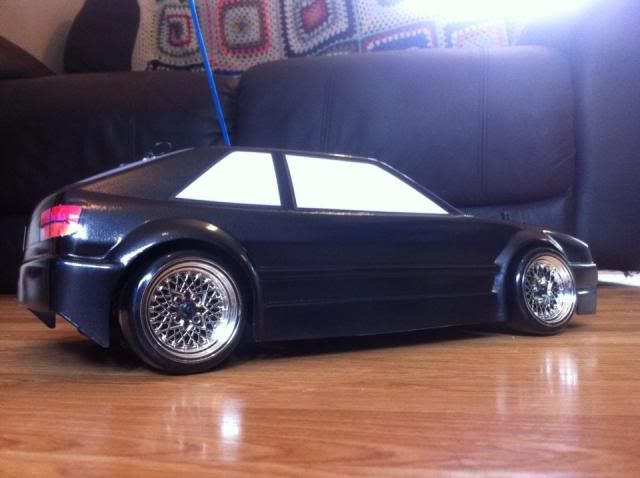

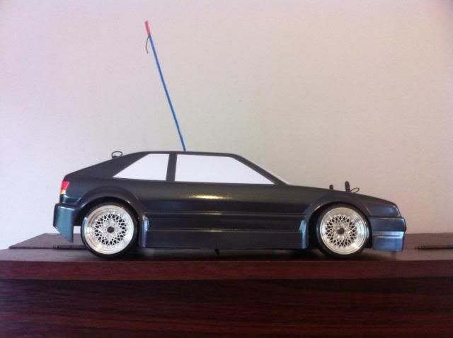

Almost finished, just got a few details to paint and the spoiler to fit. I have some Carbon Vinyl wrap to do the spoiler and may even see if I can make it moveable:
and one with the real one:
I could not find any 1/10 wheels to match my alloys so may have to get some alloys to match the RC! :)

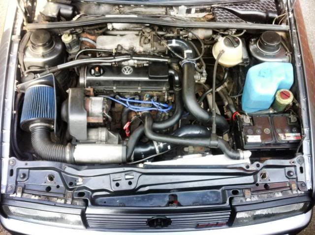

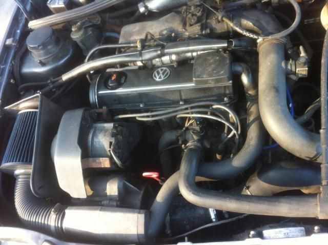

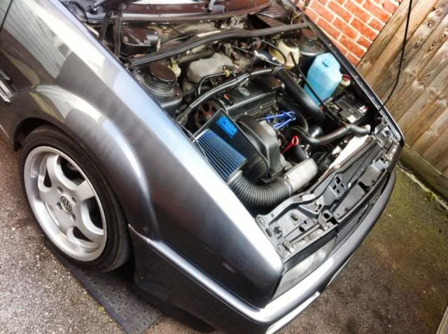

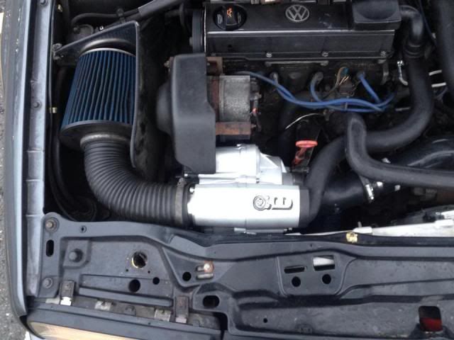

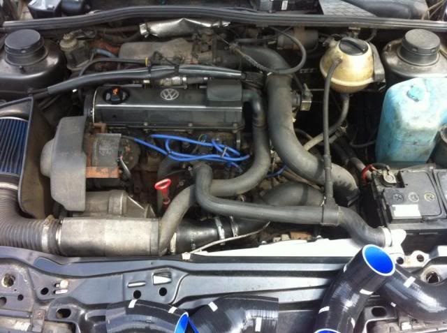

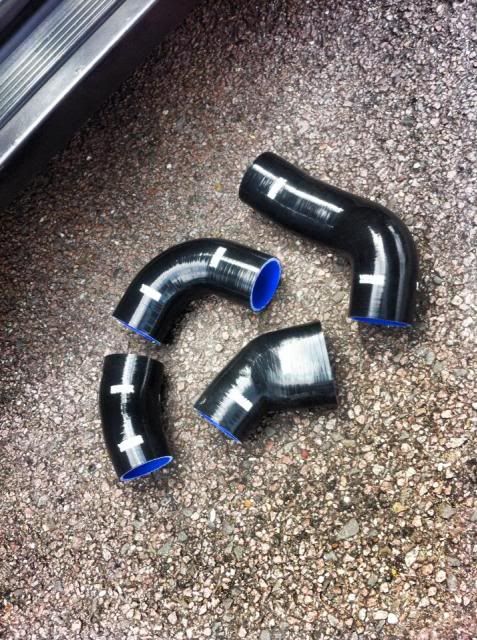

A few of my boost hoses were looking a bit tired to I thought it would be wise to replace & upgrade and give the engine bay a bit of a tidy up..
before:
A few more recent(ish) pics:

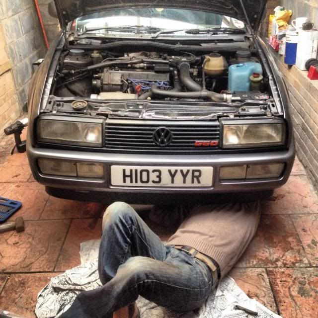

As I had some time off over Christmas I decided a good service was in order so Steve (twin45 on here) and I changed the Cambelt, Water Pump, Oil + filter, Coolant, Dizzy Cap and Rotor Arm as well as replacing the leaking rocker cover gasket.
What should have been a fairly straight forward job turned into a massive ball ache with bolts snapping off left right and centre, the car not running right initially when we got it back together and the distributer being somewhat seized when we were trying to adjust the timing!
Steve hard at work :

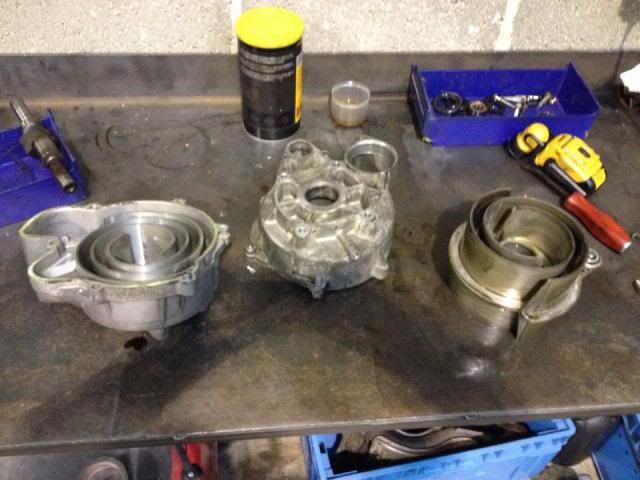

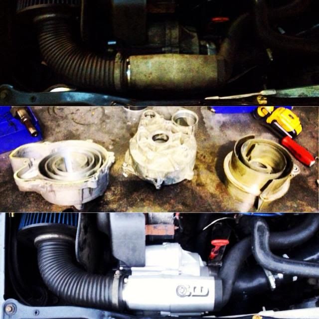

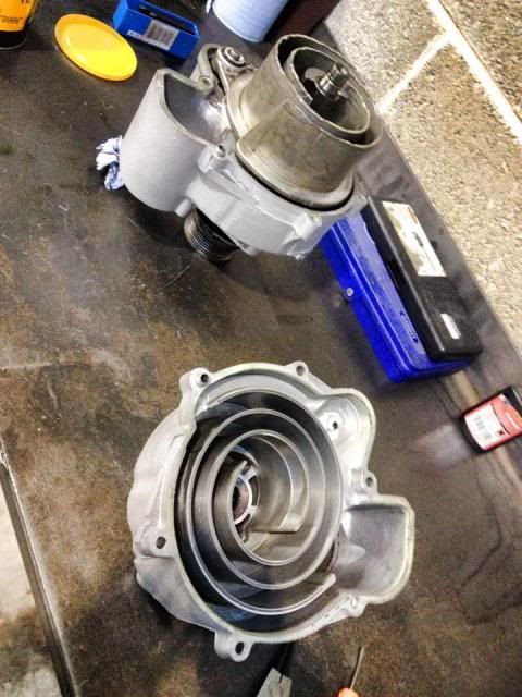

I have also been looking into having the Supercharger rebuilt as other than the previous owner stating that the guy he bought the car off said it had been done, I had no history for it.

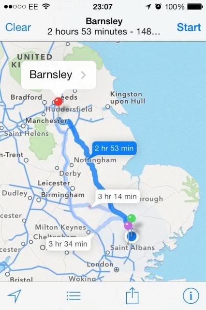

I looked at a couple of specialist companies for this, but Matt @ Only Charged Dubs has been very helpful with advice since I got the car and I had met him previously a couple of times at shows so after some research via the various forums I decided it was worth the extra time / mileage to take the car to him rather than a more local specialist so I finally took the plunge and got it booked in for a stage one rebuild earlier this week.
It was a fair trek and a very early start to get to Matt for 9am on Tuesday morning and I think its the furthest north I have ever been :
Things started well enough as everything had recently been removed when we did the cambelt but once Matt had the charger off and taken to bits he did not think the charger had EVER been rebuilt (supposed to be every 40-50k and my cars on 169k ) and noticed some slight damage to the displacer.
Although Matt was able to repair this it meant I would have to spend the night in Barnsley. I did venture out to explore a bit and found it quite funny how many people commented on my southern accent - we have a yorkshire lass at work and often have a joke with her about her accent but the boot was on the other foot now so I will think twice in the future! After a 5am start that day though I was shattered and back in the hotel in bed by 8pm
The next morning things started well as Matt had already started working on it before picking me up from the hotel at 10am
The car went together quickly but when the moment came to start it, the charger was making some strange noises so it was quickly turned off and removed again. After some fettling from Matt, things were sounding better and I was finally on my way home!
I honestly cannot thank Matt at only Charged Dubs (http://www.onlychargeddubs.co.uk/) enough and would certainly recommend him to anyone - he did not try to sell me the most expensive option, instead choosing a rebuild suited to my car and I suspect that given the hassle he had, other specialists may have thrown in the towel and just concluded a new charger was needed.
This Corrado has been the most reliable of the 3 I have had so far (touch wood) but everytime I try to be nice and give it some new bits / servicing it seems to fight us and not go to plan, Im starting to think if it aint broke, dont fix it!
I now have to run the Charger in for 500 miles just 296.4 to go.........

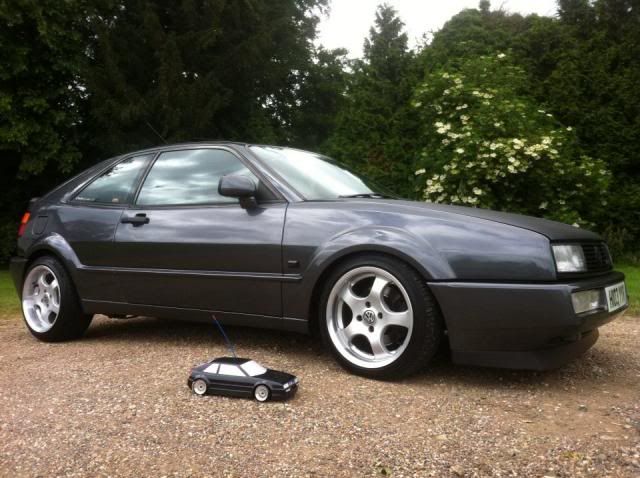

As I cannot seem to find wheels for my R/C Corrado to match the real one, I decided to try and make the real one look a bit more like the R/C....
Nice!!!!!! Real or rep's? Hard to tell looking at it on my phone at a wedding reception ;)
